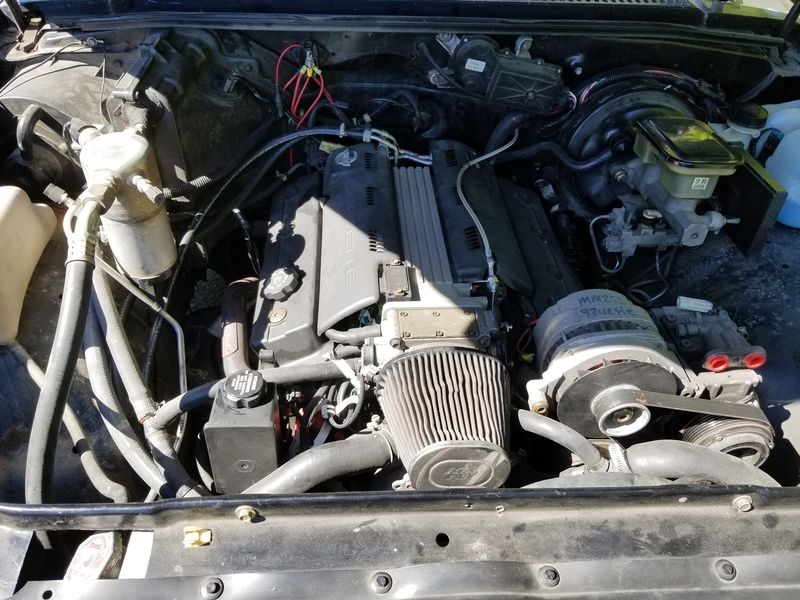

I bought this Blazer about five years ago and it has been a non stop love/hate relationship. When I bought it it was lowered a bit but all stock and I am the second owner. Since the 80's I have wanted to swap a lt4 and six speed into a two door 2wd Blazer and it has cost me dearly. So here is my build up to date.
The day I bought her.

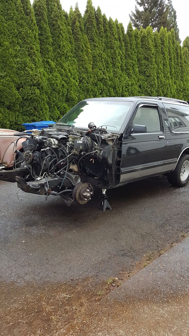

The next week. 4.3 was very worn out with well over 300,000 miles on it.
Engine number one. 1993 LT1 Corvette engine week three into owning the Blazer.

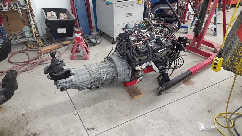

Engine number two. Decided to get rid of the auto and went with the Black label six speed and a LT4 engine. I blasted the intake to look like a LT1. Even more goodies on it this time around. I bought this engine with (low miles) according to the seller to find out it had a rod about ready to go as soon as it started.

So it now sits in the shop torn down again. I was going to put a 5.3 with a turbo in it but have decided to build the LT4 instead. I have thought for the longest that this Blazer was cursed because in the five years that I have owned it I have only driven it for about six months combined.
