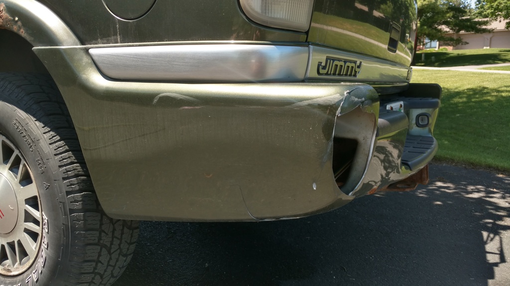

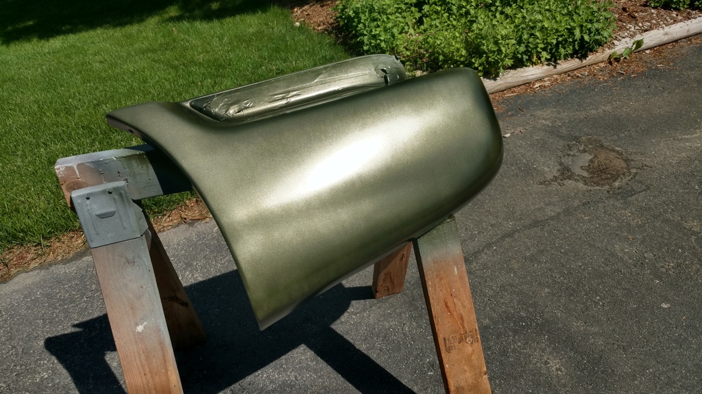

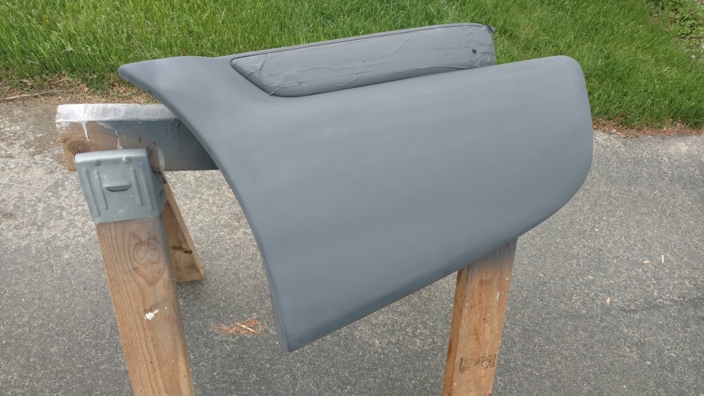

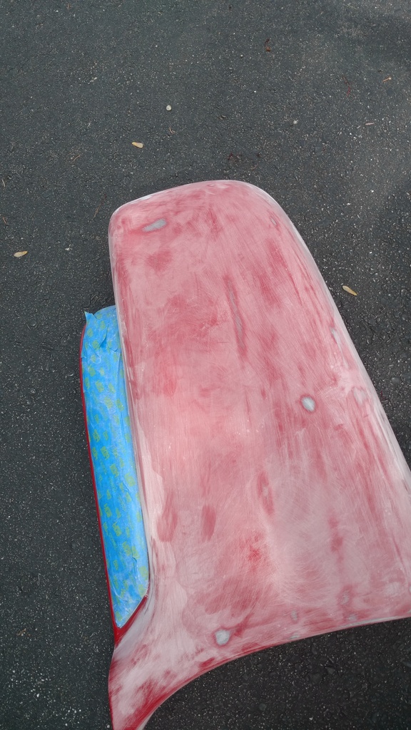

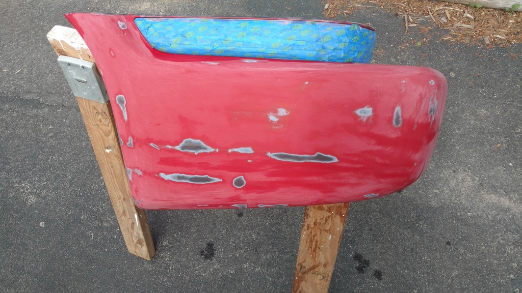

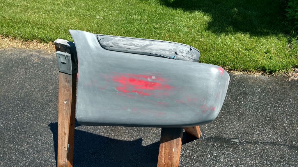

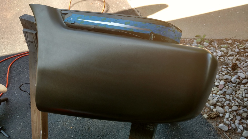

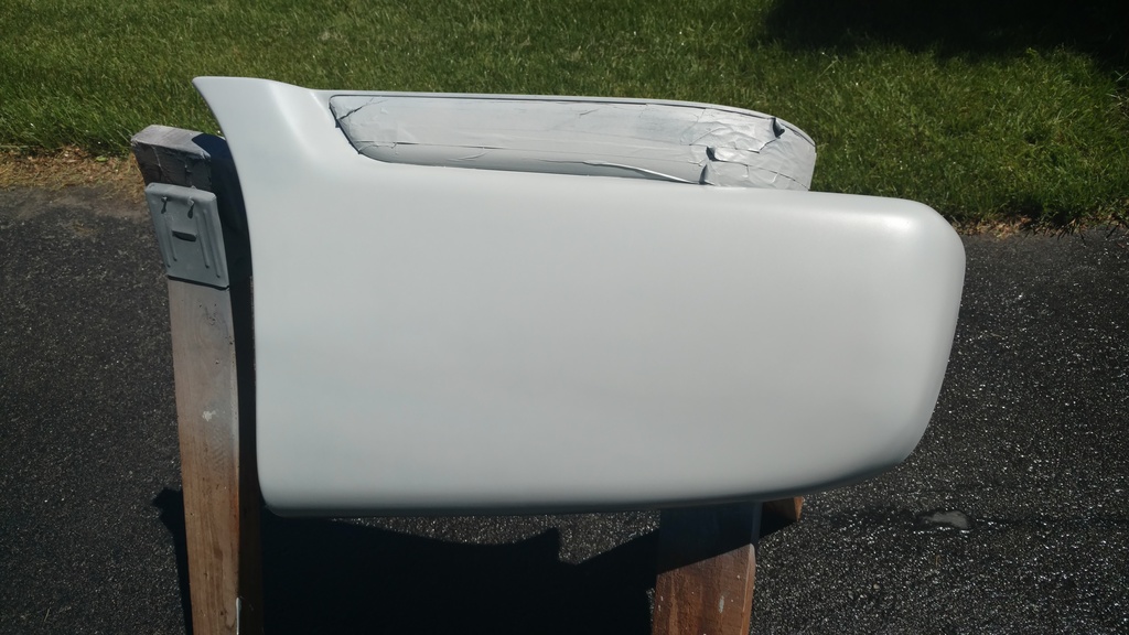

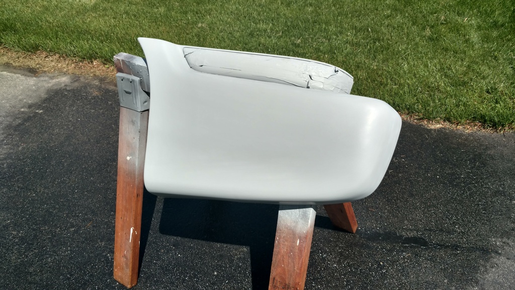

And over the last week or so I've started work on fixing the hole in my bumper cap.
I want to thank Shaley 32x who saw my search for an SLE cap, and reached out to me before he got rid of his own last summer. It is from a red SLE Jimmy so I needed to refinish it. Unfortunately its taken me until now to finally get to it. Here are the pictures from my on and off work of it over the last week. I've been doing a coat or two a day when I get the time between shifts
Currently at the last picture with one coat on before running out of paint. So I will be collecting more next week so I can finish it up before applying clear coat. Eventually installing it but I might re do the fender while its off as well

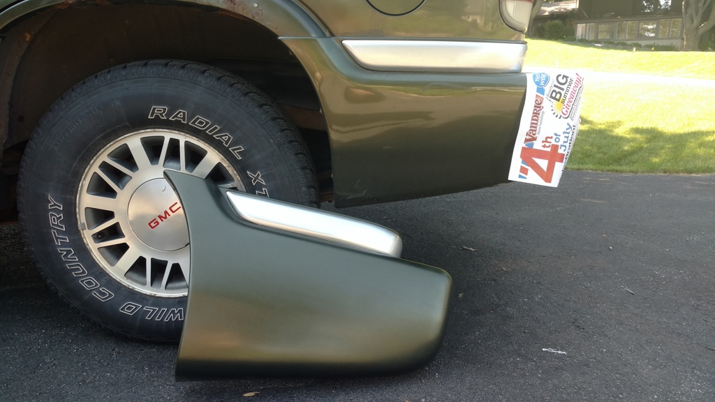

So Came back to the bumper cap, added the other layers, sanded and cleared before waxing. Here's the results
I plan to polish it once the rest of my body work is done this summer. So I've wrapped this guy up and will pull it back out later (don't want to scuff it while doing other work.)

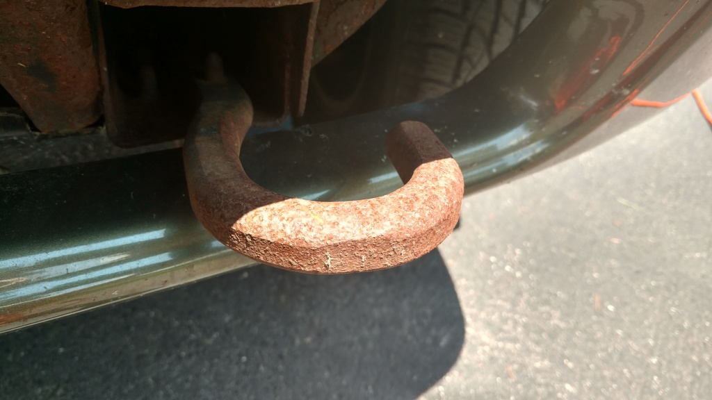

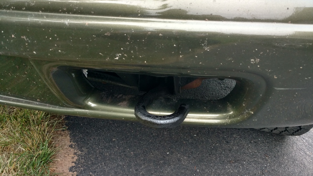

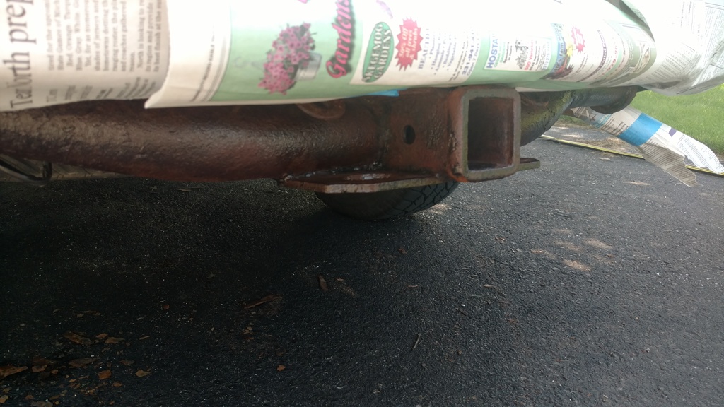

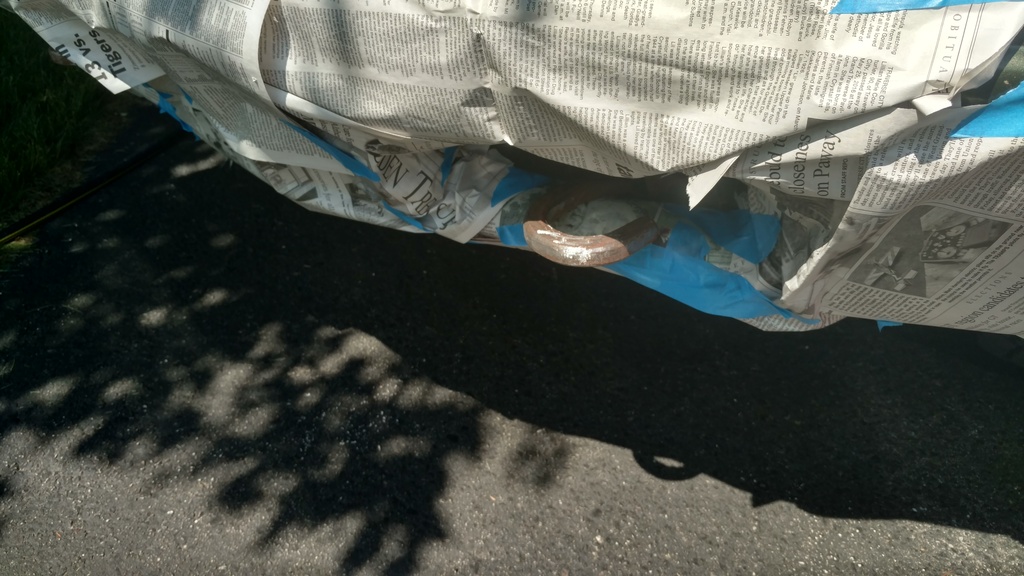

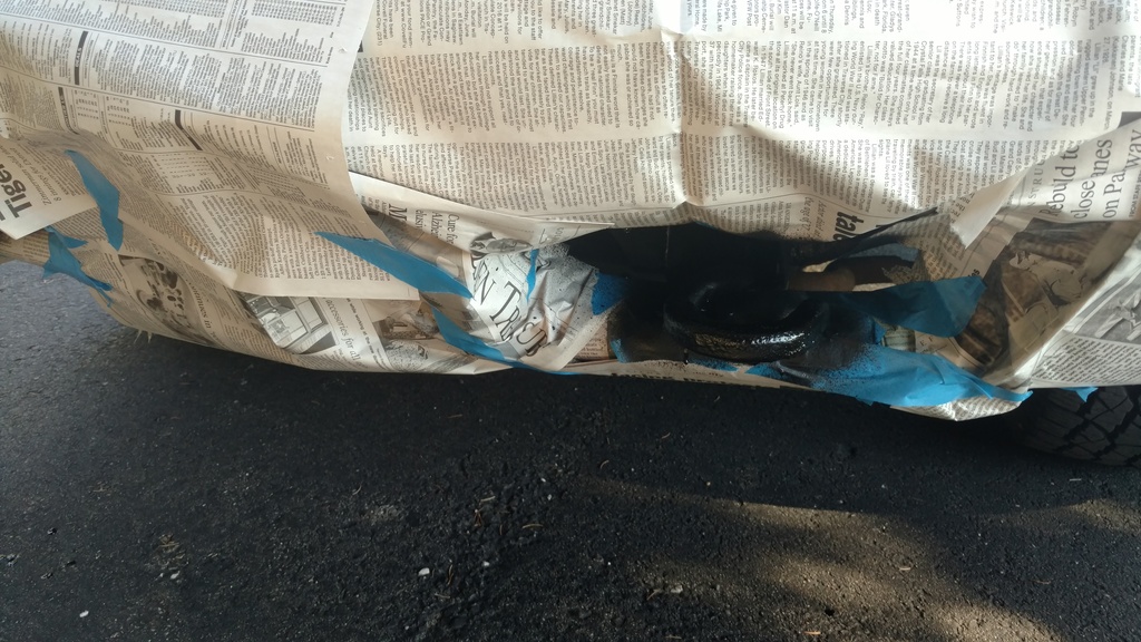

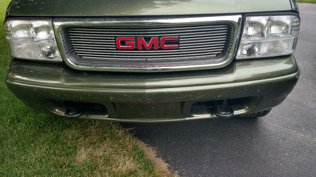

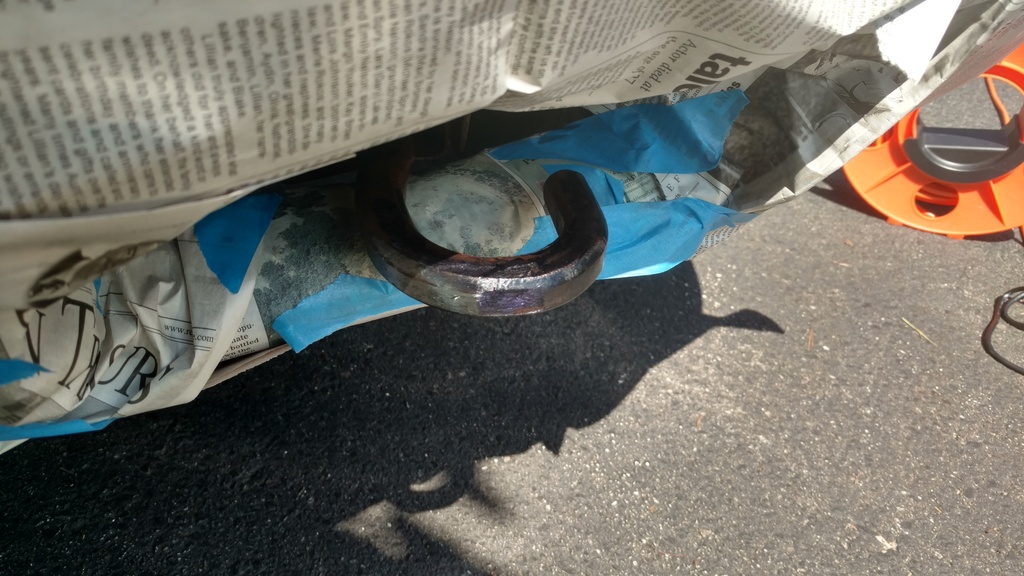

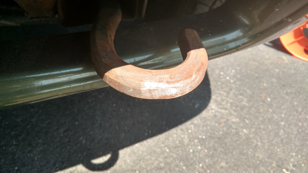

While working on this project between coats I began work on rust preventing my hooks and hitch receiver. Couldn't get the hooks off so I had to mask up the front and go from there.
Ended up wire brushing, wire wheeling and grinding to clean off all the loose rust bits.

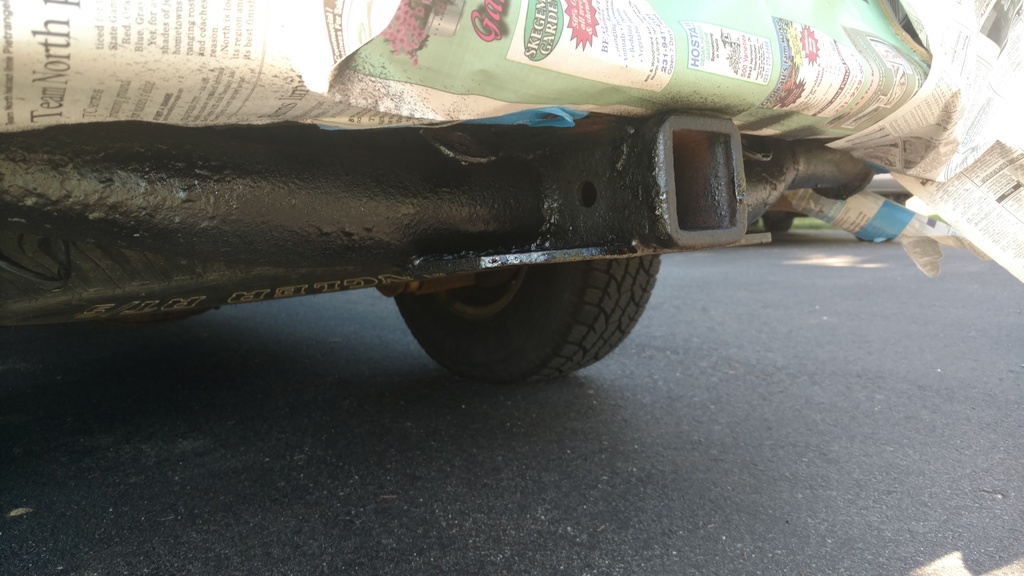

Once cleaned off I applied a rust stopper and rust shield on the base. Once cured for 24 hours, I applied the outer coat which is a rubberized frame under coat which also has a rust blocker in it. I don't think I've ever seen the hooks this black before in the 6 years of owning the vehicle.

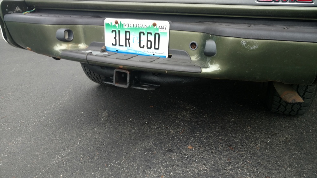

I also did the same to the hitch receiver bar. This I didn't take as many pictures of as I was using some automotive language while wire wheeling this since I jumped the wheel into my rear camera. Thankfully the camera did survived and just needed to be remounted to the frame.
