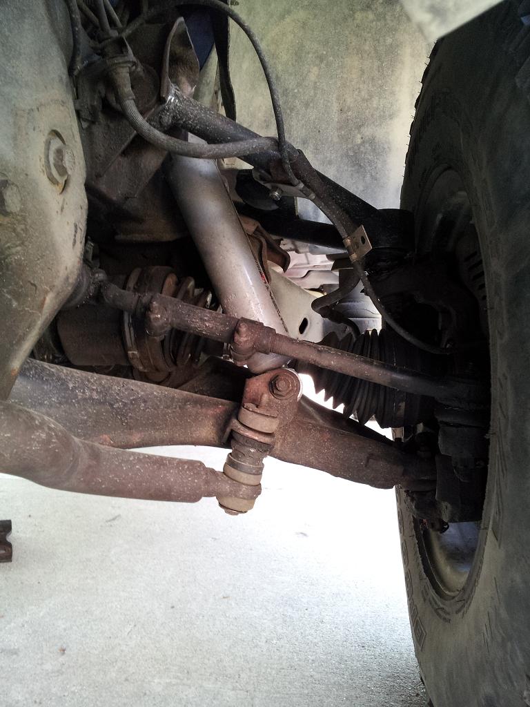

Originally Posted by Rottidog
A friend & I installed this kit on my blazer a couple weekends ago & so far I haven't had any issues with CV joints or boots.
Can you post a picture of how yours are angled? And i assure your cranked up 2.5"s?
Old May 13, 2012 | 03:03 PM
  #305
Rottidog's Avatar
Joined: Sep 2008
Posts: 2,522
From: Winnipeg, Manitoba
Cranked up 2.5"?
It's lifted from stock the 2.5" that the kit does BUT keep in mind I had the t bars twisted an inch & 1/2 so I really I only got an inch or so perhaps of lift.
The benifit of installing the kit was better angles on the cv's & the TB's at a "stock" twist for better road manners ala the keys in the kit - not as harsh as with them twisted. Not to mention the tubular upper control arms that should be a lot stronger than the stamped steel POS that I was bending because of the 32 x 11.5 on 10" wide rims.
I'll get a pic or 2 tomorrow of the CV's etc.
Cranked up 2.5"?
I understand. Did the diff drop make that much of a difference to help level out the cv's? If so around how much do you think?

Yeah they look a LOT better than when I had it with 1-1/2" T bar twist. I'll see if I can get a pic or 2 of how they are now. The angle of them is much nicer to the front end componants & the t-bars being back to a stock twist ala the keys that came with the kit makes the ride a lot nicer to me.
Old May 15, 2012 | 07:40 PM
  #310
Rottidog's Avatar
Joined: Sep 2008
Posts: 2,522
Here's how the CV's sit now with the RC kit.
