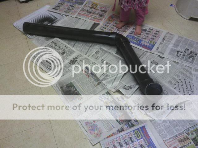

Here it is all pieced together before he glued it. Then we noticed the inner fender. It was lined up to a hole that was already in the inner fender. Well the hole wasn't big enough. He marked it and got a cut on each side and the second blade broke! So out comes the hammer. lol. He had enough cut that he was able to bang it in to get the pipe to fully fit through. So he marked the pvc to keep it lined up where he needed it and cemented everything together. Brought it in and painted it flat black.

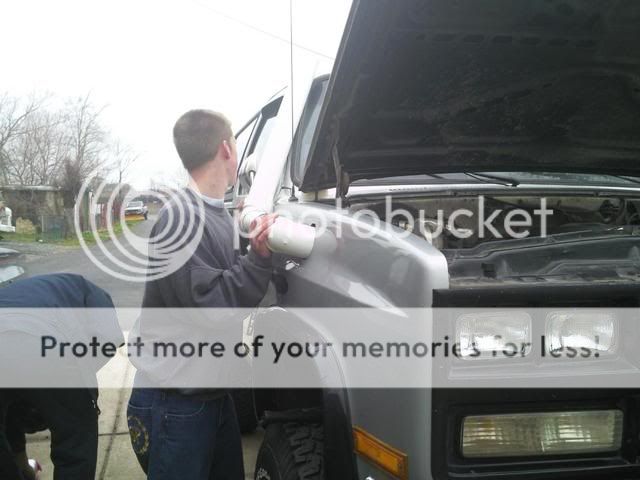

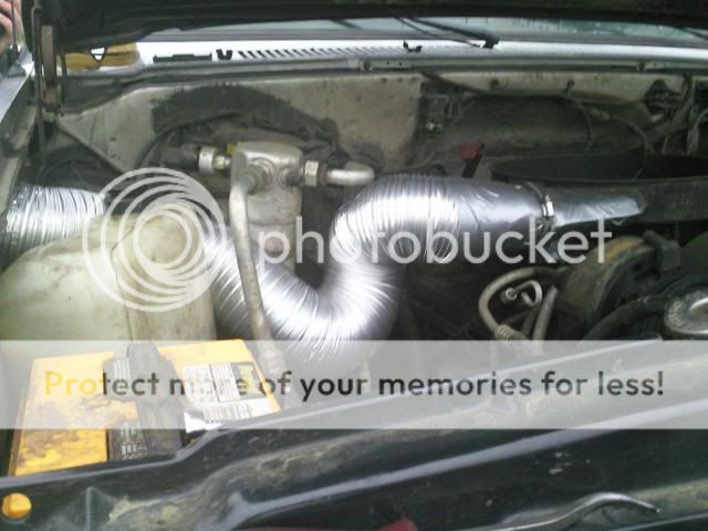

And now the fun part!!! We got everything painted and looking nice. While it was drying we went out to set up everything inside the truck. At first we used 4 inch dryer vent. We have the stock air cleaner still on so we wanted something we could mold onto it. Well it kinda fit but it was tight so out came the duct tape to make sure it wouldn't go anywhere. Brought out the skorkel once it was dry and put it on the fender so we could attach the dryer vent to it. Lemme tell ya that was a task witin itself. A really tight fit!! We had to maneuver the snorkel (thus scratching up the paint) just to get the vent onto it. And some more suct tape as well as a clamp to hold it there. We got some nifty round clamps at home depot (to hold pipe to a wall) they had a really long end to them (looked like a lolipop). My husband cut off the end piece and bent it to get it to screw in and under the snorkel so you wouldn't see a ugly silver tab on the fender. He also put one into the door jam. Fit quite nicely. Here's the end result.
Or so we thought! We made sure there was suction (thanks Biohazed!) to the engine. My stepson revved the engine while husband had his hand on top. Sure enough it was working. It sucked his hand down into the snorkel. So we went to shut the hood and it kinked the hose. Not too bad though. So he took off the hinge on that side. Revved the engine again to make sure there was no damage to the hose and the whole thing collapsed into itself. :-( Noteo not use dryer vent to make a snorkel!! LOL So there went that idea! But we had another one. We went back to home depot and found a coupler that went from 4" to 3" And also picked up another 60 degree as well as another 45 degree pipe. We clamped the coupler to the intake and siliconed it. And pieced together the inside tubing with the remaining pvc. So here is the final finished snorkel.

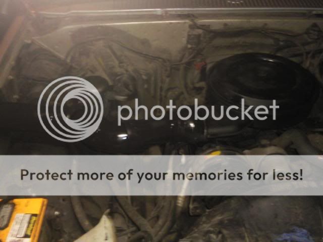

And inside the engine. Now it's time to test it out!!! And that will be this weekend (april 19th) when we head down to Wharton again :-)
