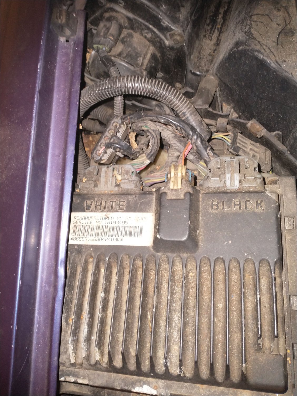

I need help identifying a harness and some wires in the blazer. They are all on the drivers side under the master brake cylinder.
Lets start with this harness. It have a lose cable sticking out of it and lets start with the loom.
Its the loom that I have circled the marking on and it have this cable sticking out of.
And then I have this one that I feel chould be hooked up somewere
