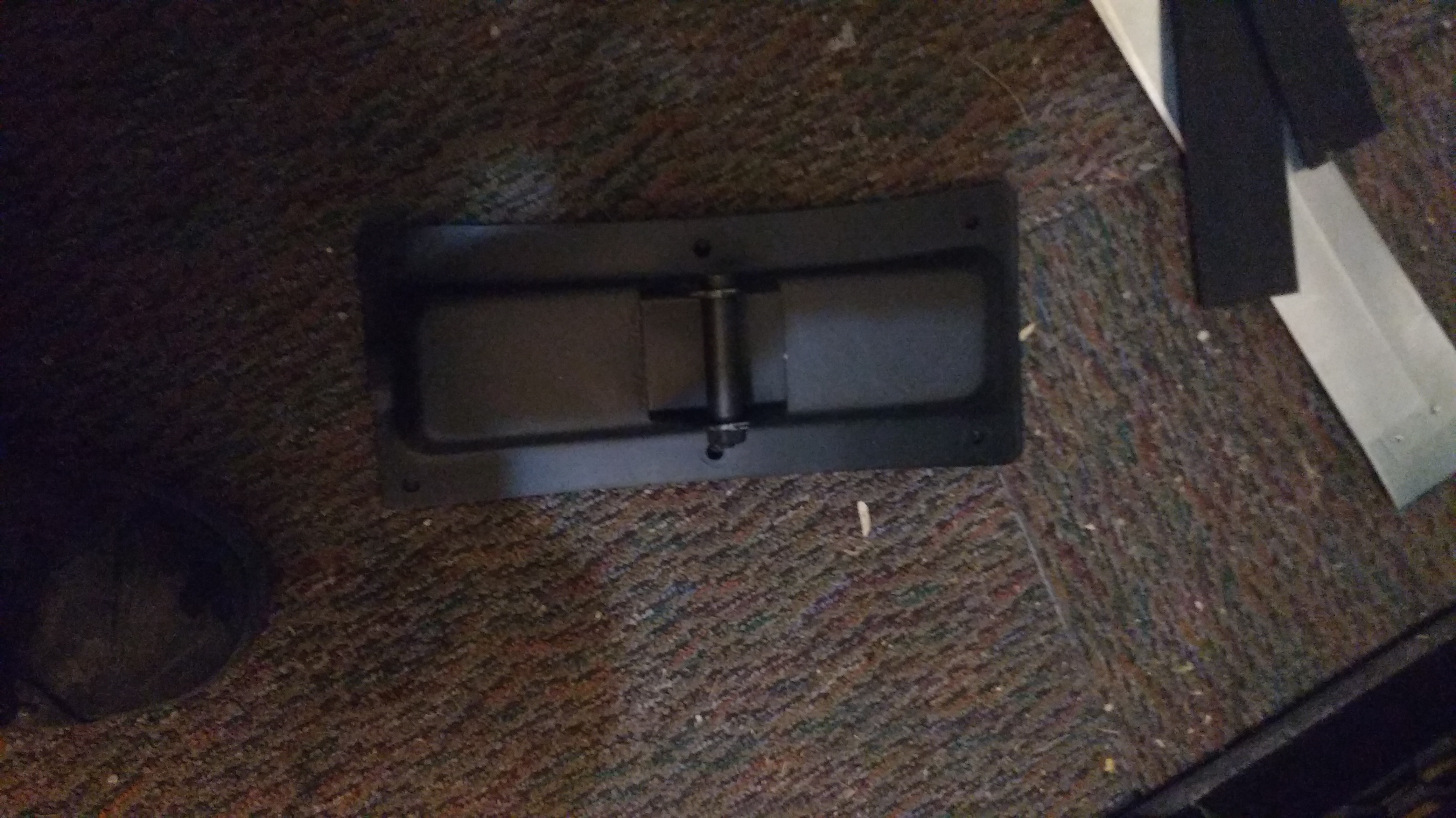

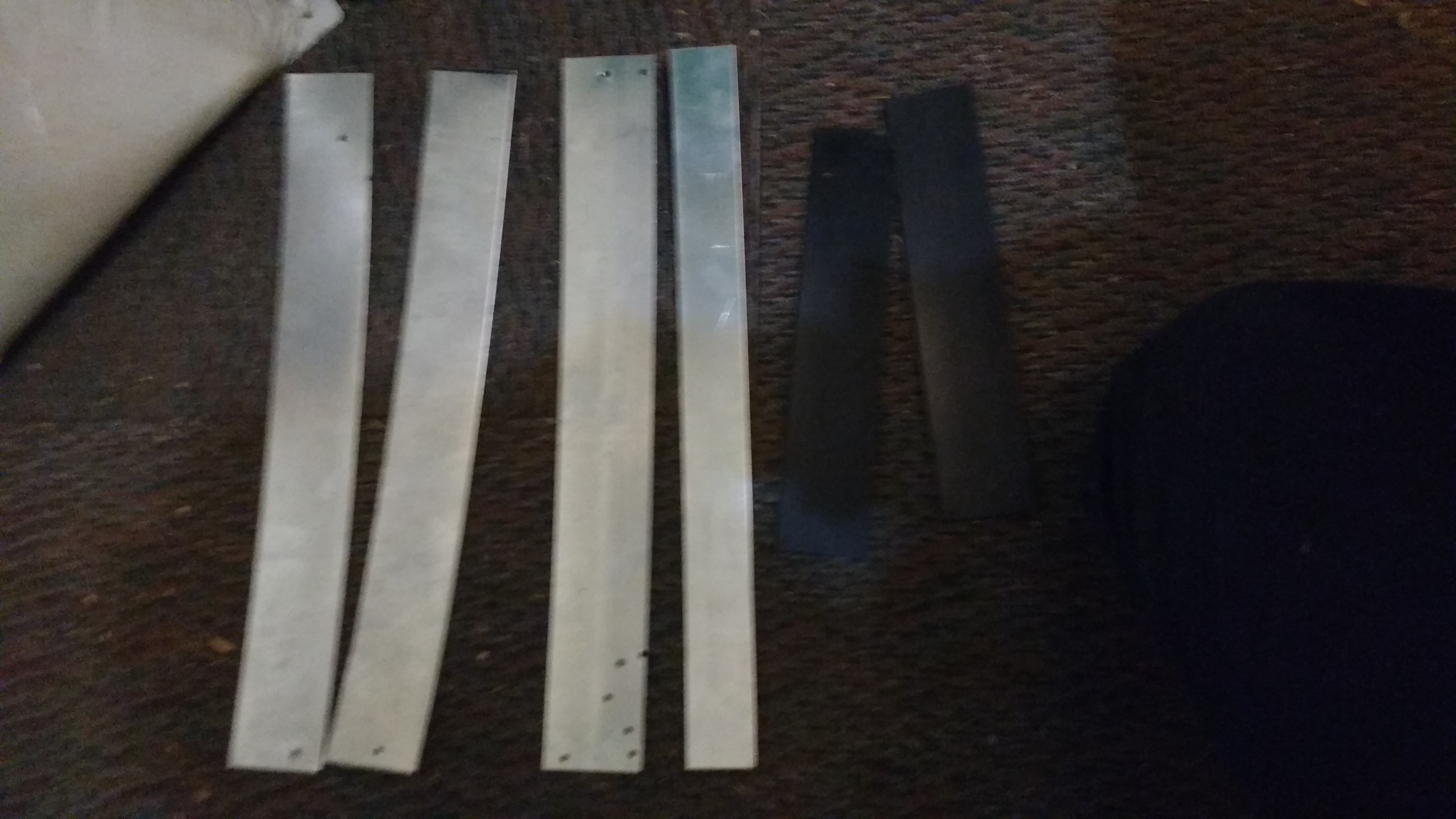

Here are some pics of the tire carrier after I did the sanding and painting, I didn't replace any hardware on it. Just a wash sand and rust coat paints. I got some 1/8 thick rubber for in-between the mounts and the body for an extra seal before the caulking. And I also picked up some 12gauge steel sheets I cut to fit from top to bottom to reinforce the side panel in-between.

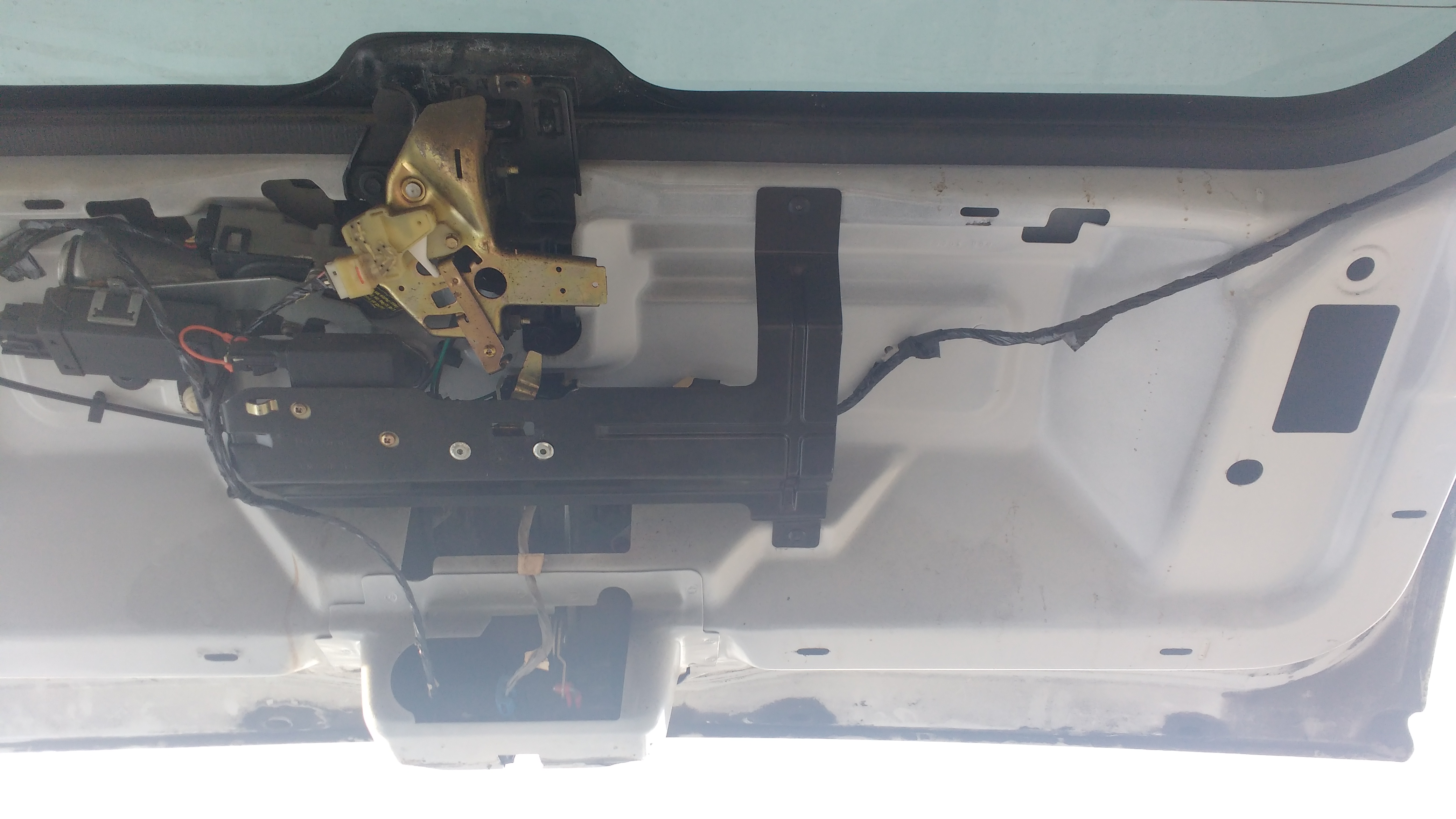

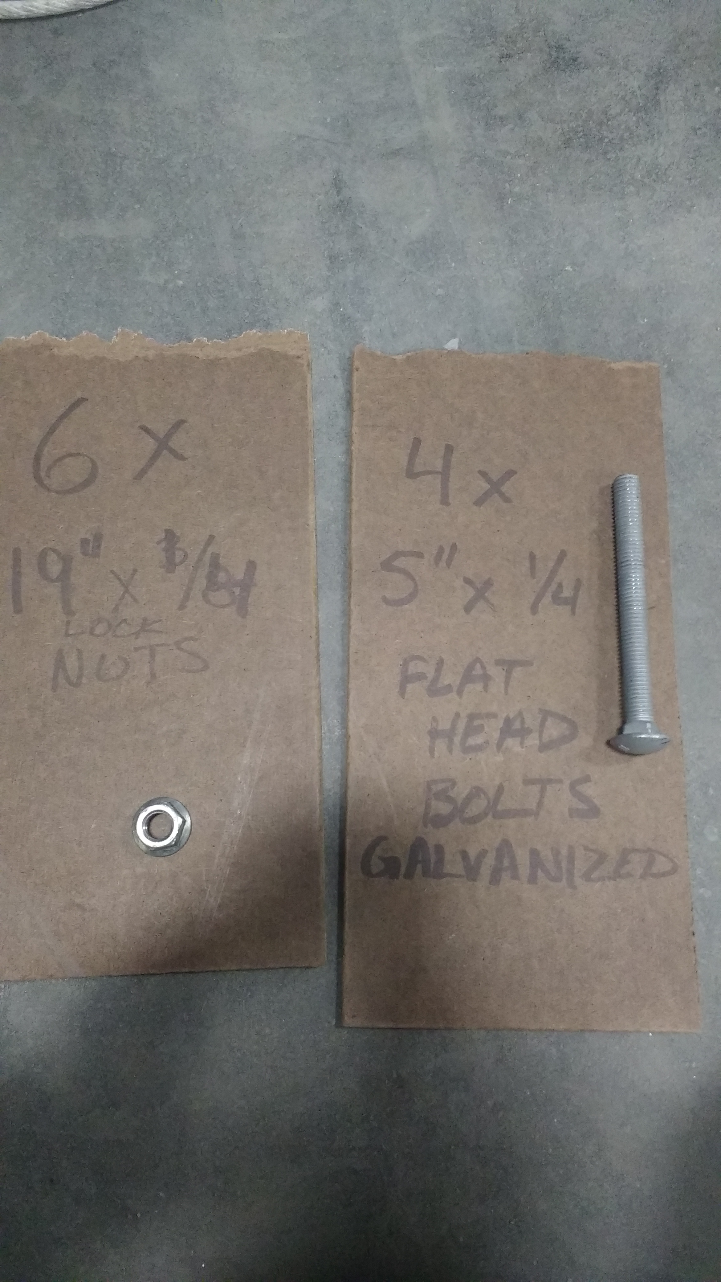

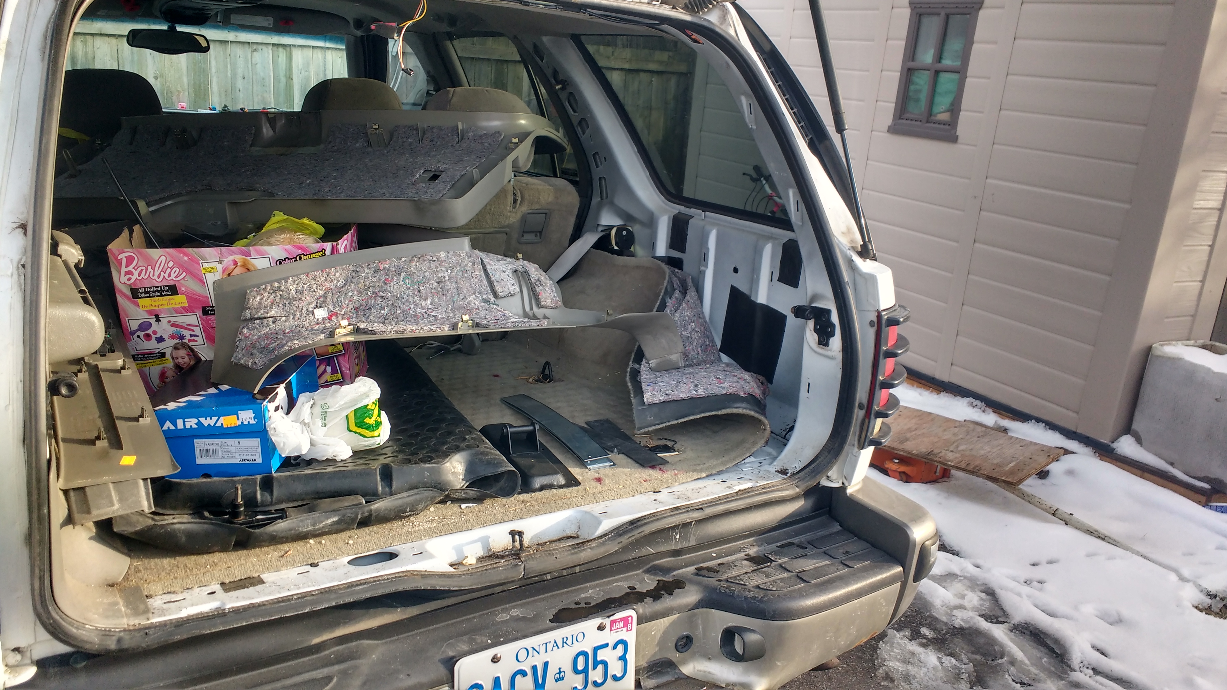

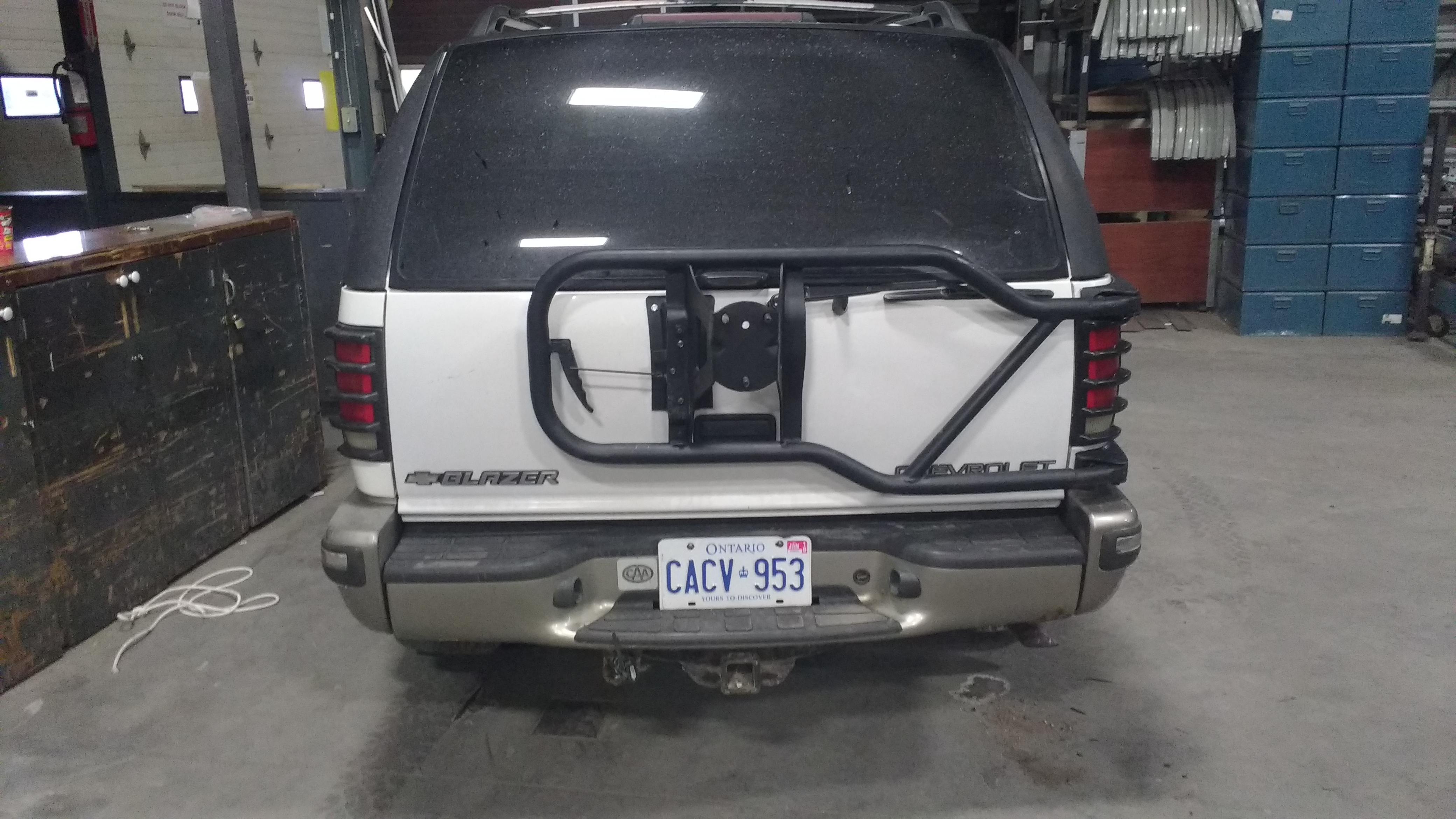

So the day didn't go as planned, but she's 85% finished! I have gotten the tire carrier on the blazer! I took a couple of pics of the work but not all is there, and there's bolt sizes!! But I cut three of the four bolts down to about 3". The hex socket head bolts I used where only used because I didn't have the flat heads, they will be swapped out in the warmer weather. I have to finish the caulking around the hinge and latch panel, adjust the bumpers on the carrier and pull my spare out of storage and mount it on. Maybe one day when the snow decides to stop!

That looks great! Good work, and thanks for the pics showing the hardware needed. I've thought about doing this before, but I'm scared to loose visibility when reversing. I may modify one to hold a Jerry can and hi-lift jack though.
Definitely looks awesome on the 4 doors though. Can't wait to see it with the tire on there
