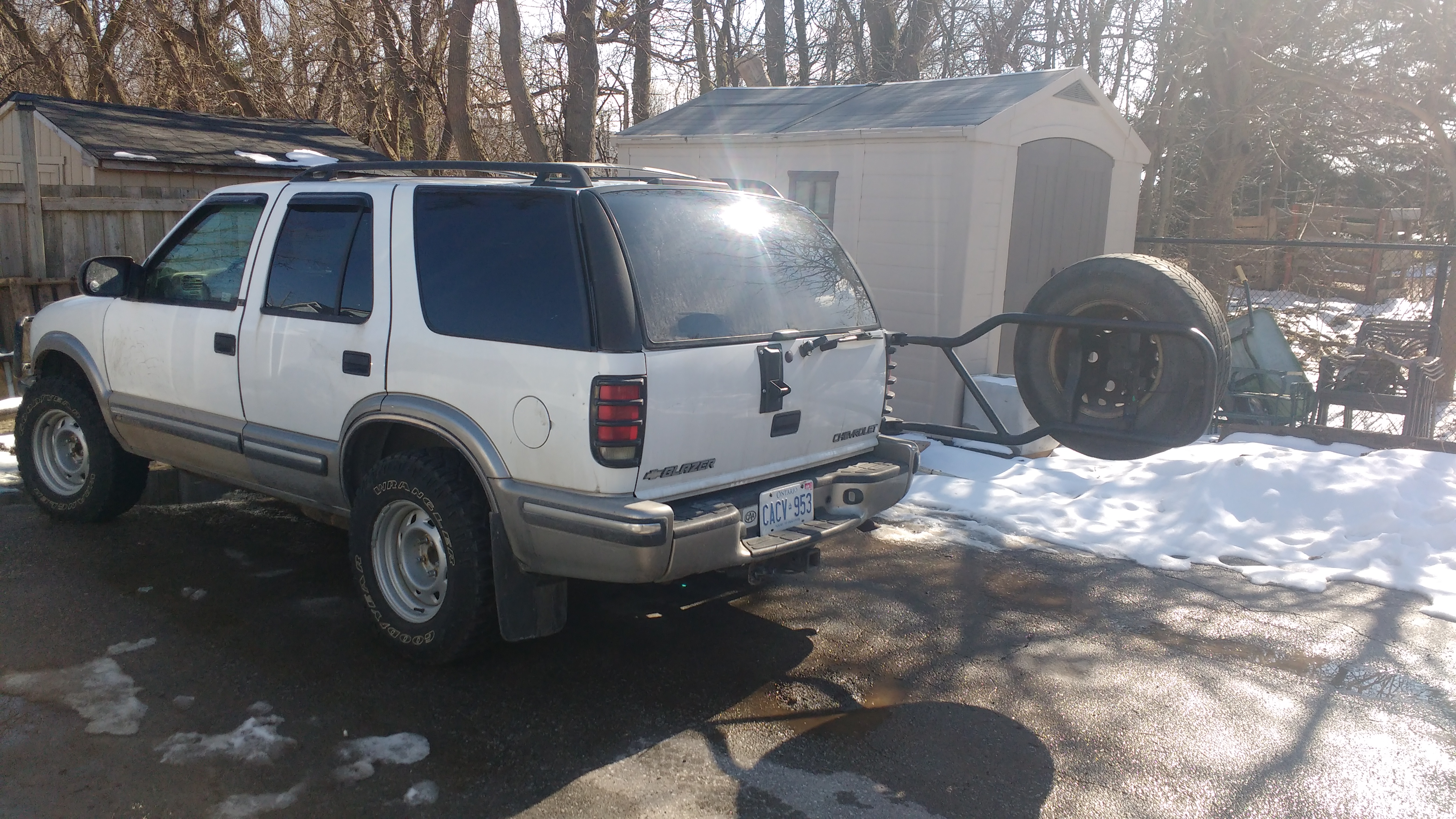

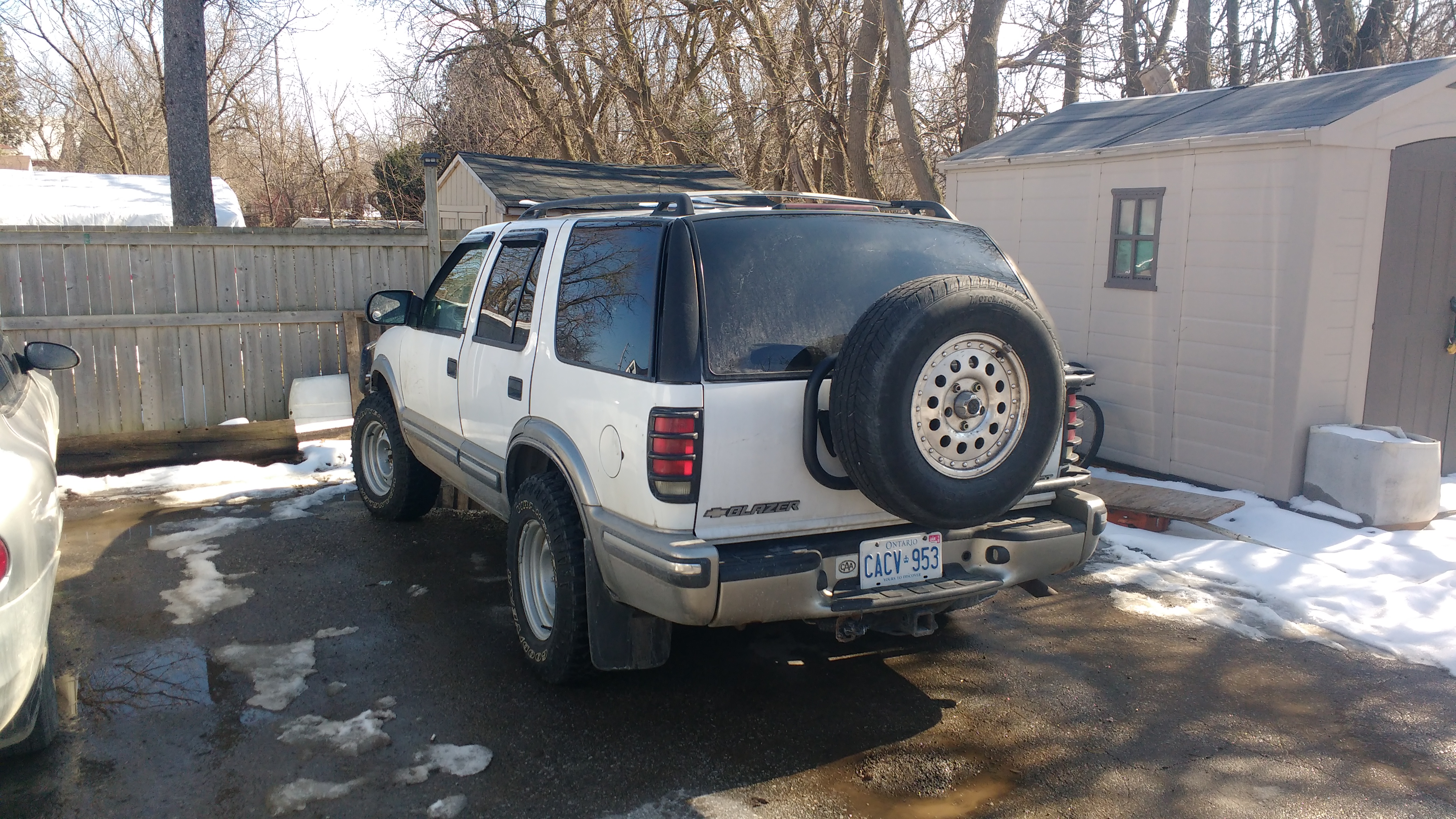

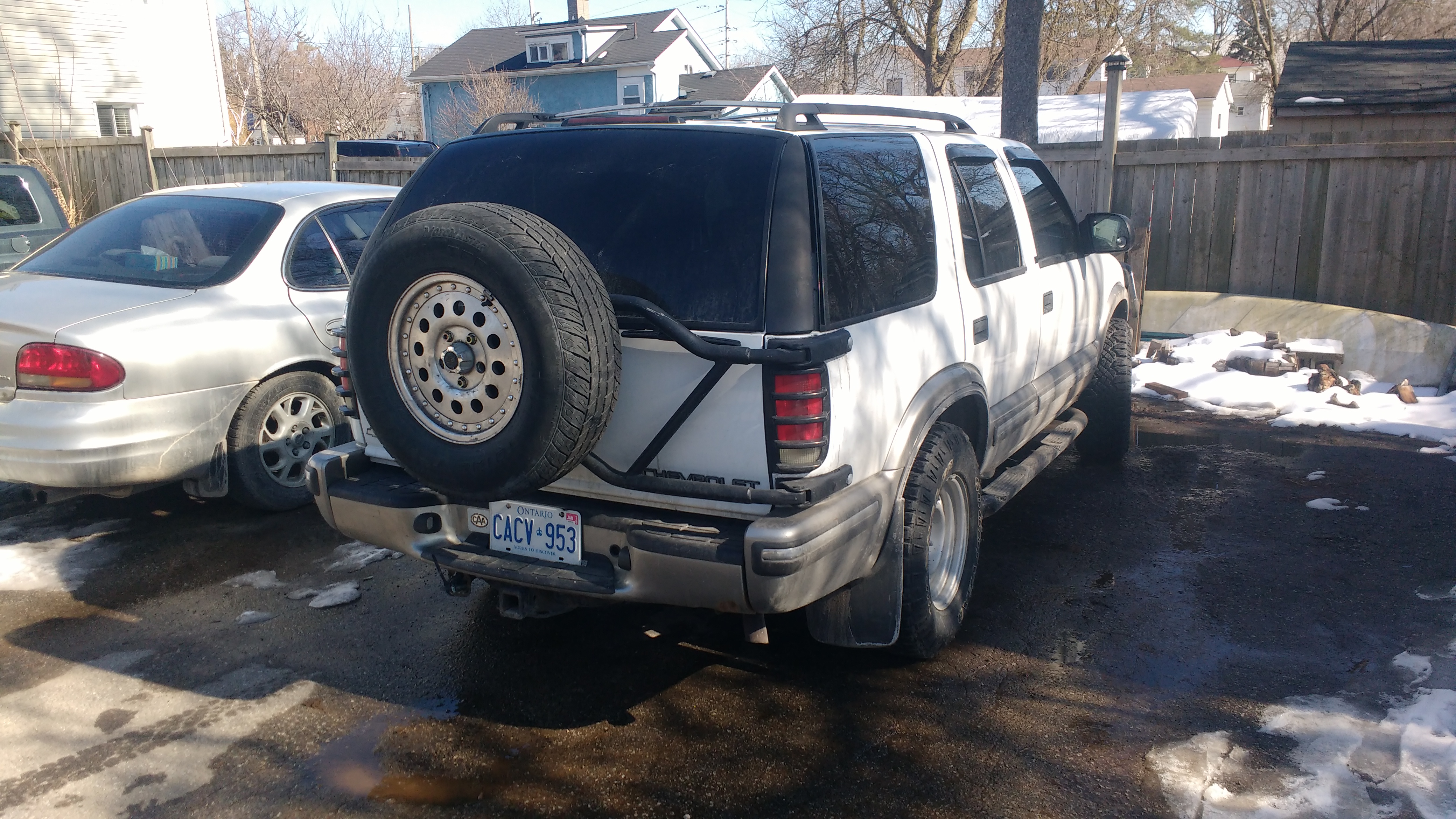

So I stopped by storage and got my spare tire out, I threw on one of my summers on the carrier for the time being until I get the spare cleaned up. I took a pic too if the view from between the two front seats so you can get an idea of the view. Hopefully this will help people in the future if they are having a hard time deciding. As for the Jerry can, the smallest I have is 2.5 gallon, and it's too big for the spot I thought it would go, right in the middle behind the tire on the carrier. But might make a bracket to mound on the carrier to strap it or wait until I get my roof rack

Looks really good!
Do you have any pictures of your reinforcements?

I do not sorry, I took pictures of the plates before hand, for the two outer most bolts, I was able to go through the side wall and the body reinforcement on the inside of the truck.for the two middle bolts is where I put the reinforcement. Let me tell you now that that was the hardest and bigger pain ever! For the two bolts above and below I did not use any reinforcement. There was on the other hand a couple of pictures of reinforcement for those two bolts on another fellow members pictures of his work. I can't remember whom it was but if you search tire carrier it'll be at the top of the list.
