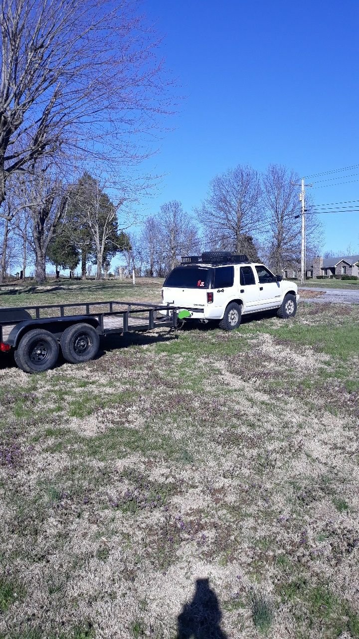

Helped out with some relief efforts today had to crack out the ol' 16ft.
Had to go and get some debris off of mammaws property, figured I'll get some good shots in

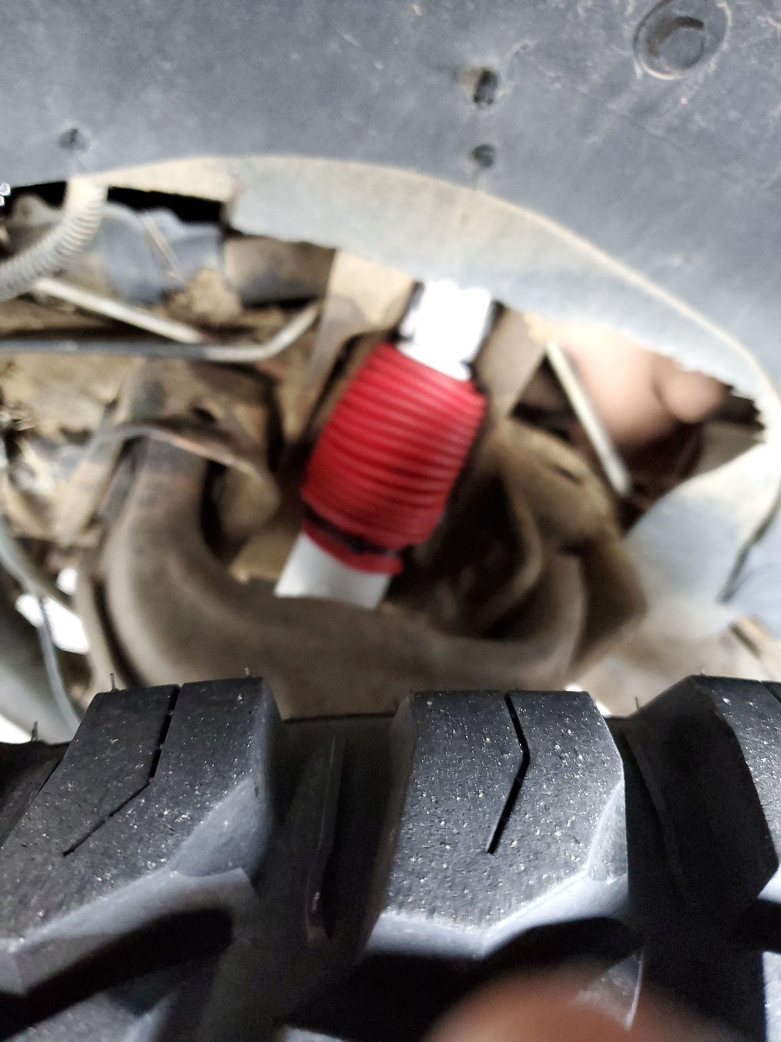

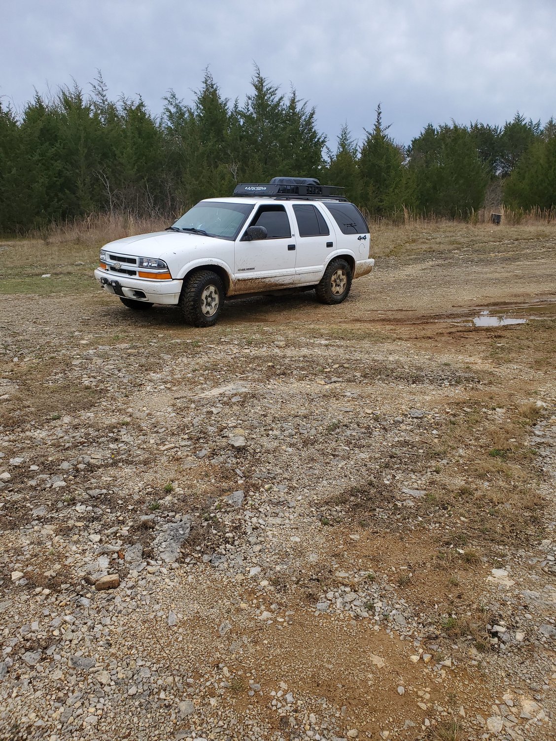

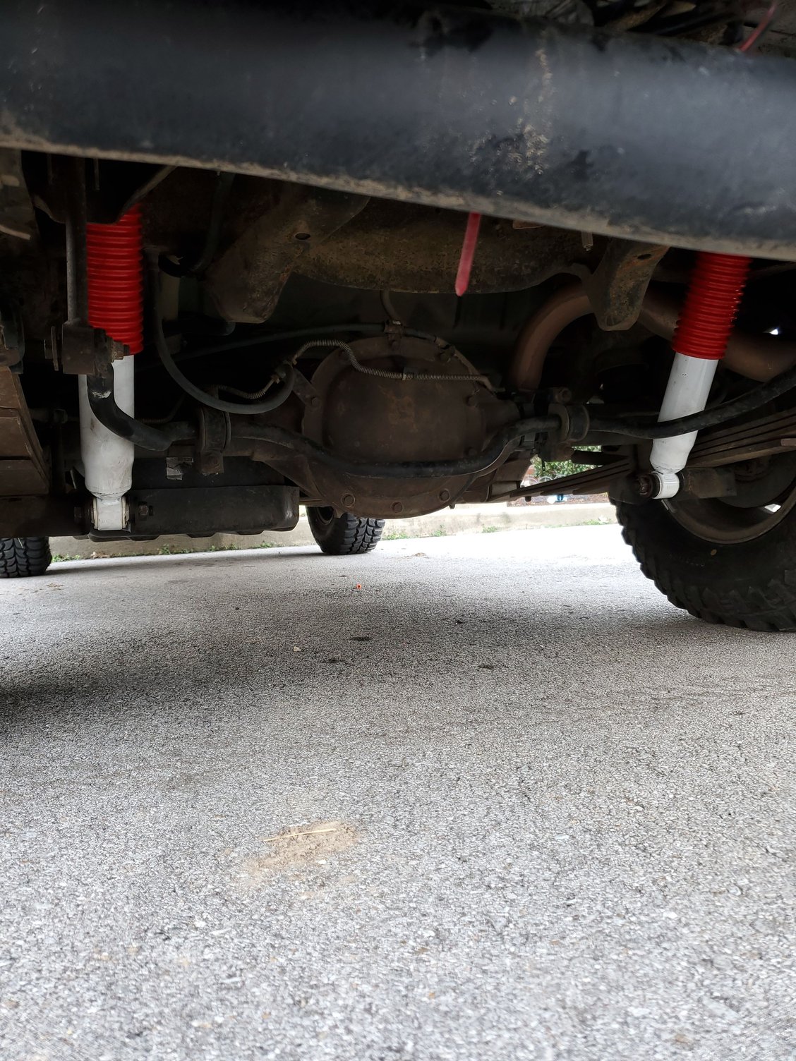

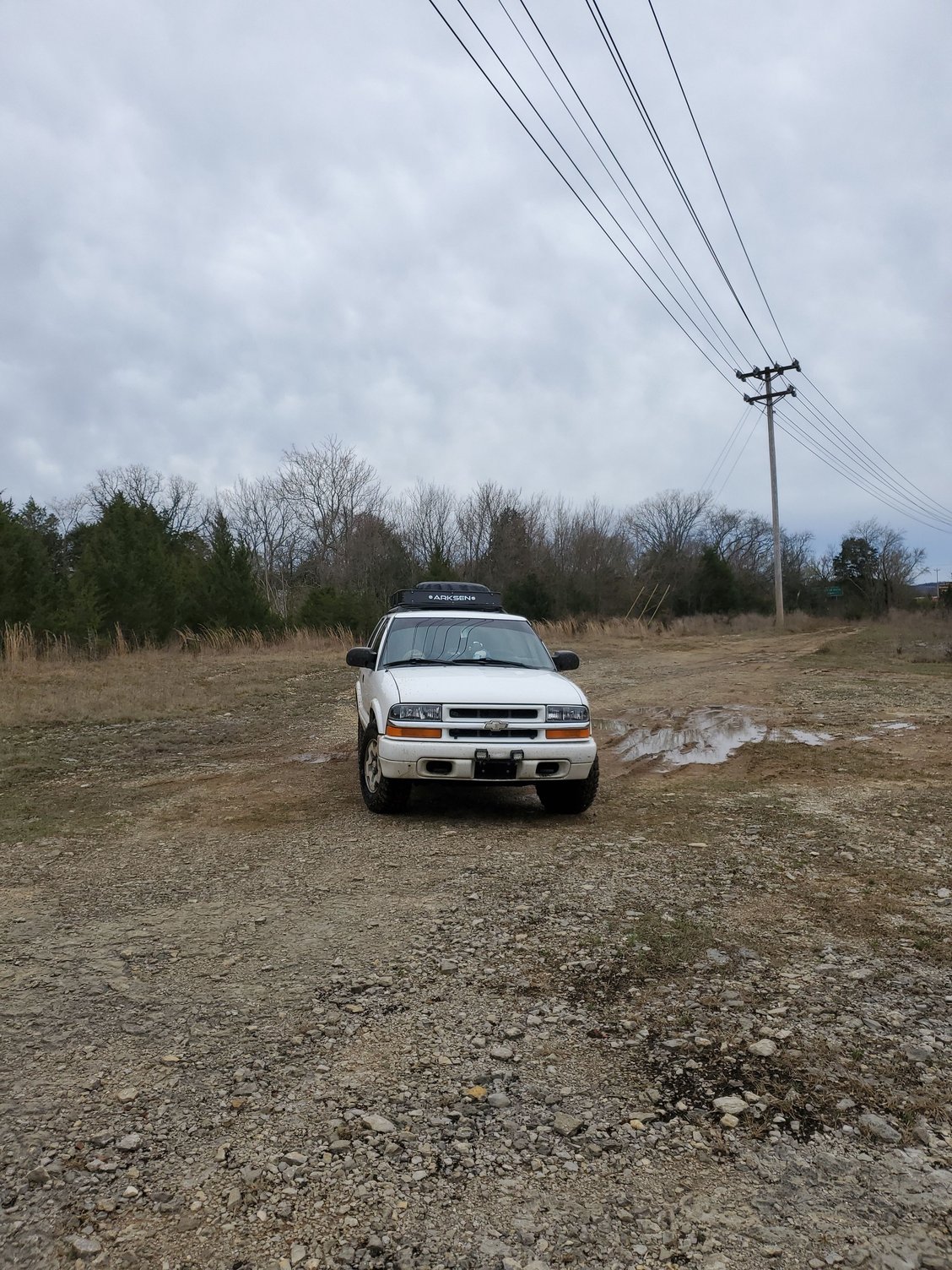

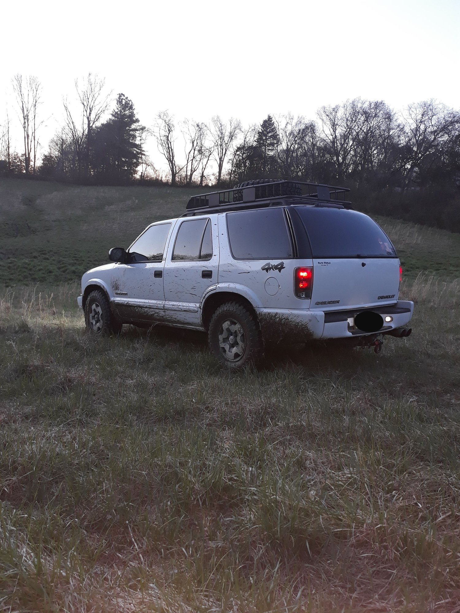

Finally got some Rancho installed. Could of saved about 450 bucks, but I got a lot going on with fiance out of surgery and tons of side work. I let midas install them. I did a set of 5000x shocks all around, but I have some 9000xls for the rear if I feel the need for a stronger shock in future. Between going to the 30s and getting shocks replaced I've gained about a 1.5 of height. So far the are riding well.
I went on some trails to test them out.. definitely different. I bottomed out a lot the last time. it was much better this time, I don't dip as much when I brake also. Sway when turning has also cut down
