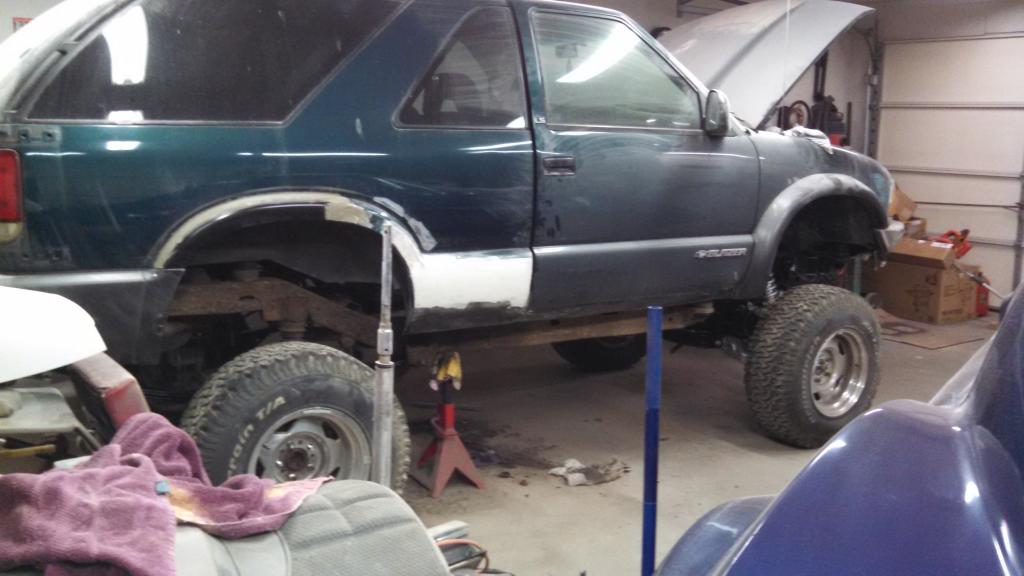

Got one side of the steering setup. Once I get the other side and make sure everything is good I'll weld them up.
Went with 7/8 heims with 5/8 safty misalinement spacerd and 1" quarter wall tubing. Maybe a bit over kill but it should last forever.

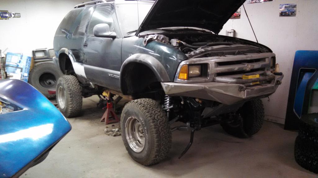

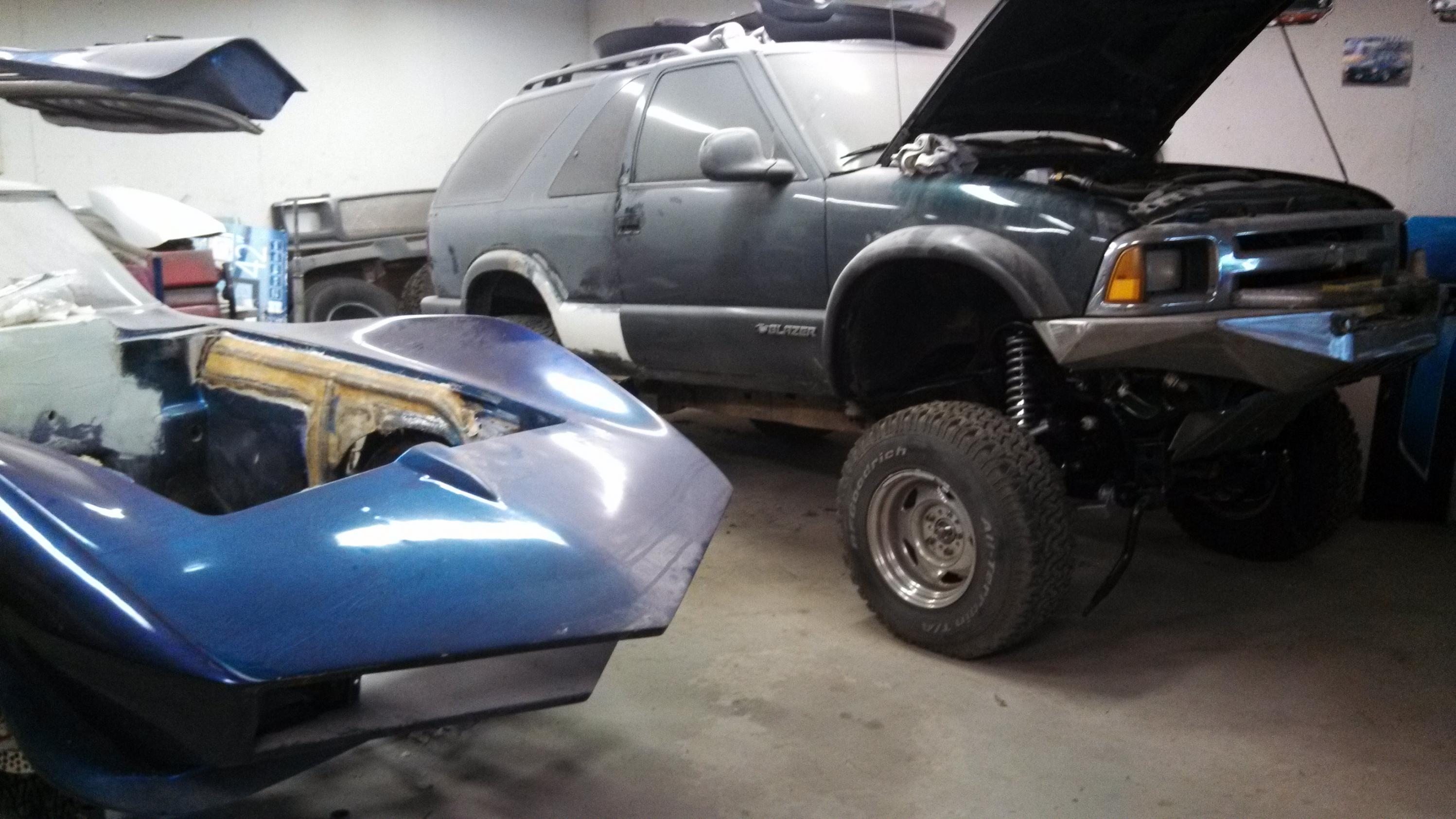

So today its sitting back on the ground for the first time in a year and a half. Still need to work on the alignment.
Not sure I'm going to keep the front sway bar or not.
Here's a pic of today's progress.
Now on to the rear.

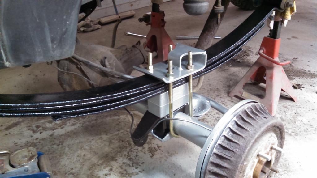

Got the rear end all together today. Got some of the stuff cleaned and painted. Just need to put the shocks on and new brake lines and the back is done. Also have to build a new longer drive shaft.
Attached Thumbnails Xtrmes10 97 ZR2 Blazer build-img_20140526_134233_988.jpg   Xtrmes10 97 ZR2 Blazer build-img_20140526_135129_071.jpg   Xtrmes10 97 ZR2 Blazer build-img_20140526_135149_719.jpg
