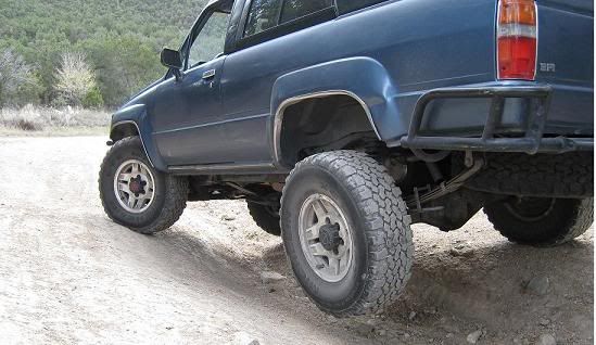

You can go to any web site concerning Zuk Mods, and there are very few occurances where a Zuk Mod failed. Honestly I may have seen 1 where the guy used rigid conduit for his brackets and they broke off, but that would be an operator error, not the Zuk Mod's fault.
Even if my shackle or bolt breaks on a leaf the spring wont come out. The spring was compressed to get in with one end unbolted.
Worst case senario would be for both the bolts that hold the leafs on to break and then my U bolts would be loose enough for my axle to shift... But thats worst case senario. If something like that happened honestly the Zuk Mod would be the least of my worries because I'd have to be in an accident for that to happen.
Check out yotatech.com - these guys are hard f'in core. They beat the crap out of their Zuk Mods and they keep going.
Check out the pics below.

Originally Posted by hammer051
how the hell does he drive it when it's stuck up there?!!
better yet, how does he get it back down lol
