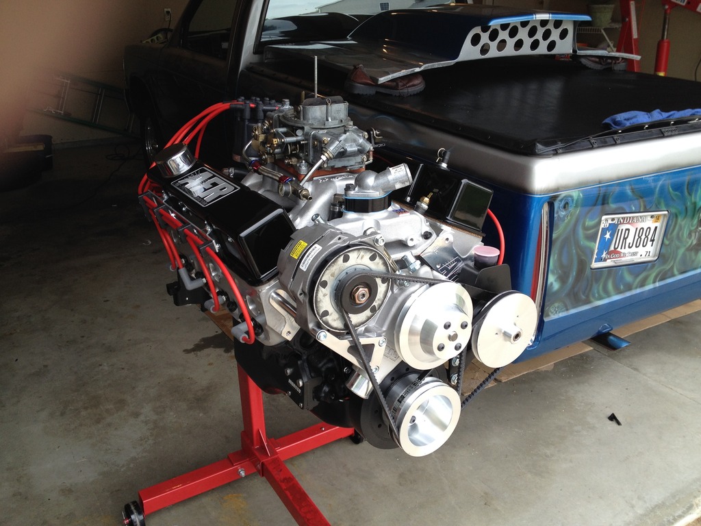

Better choices with standard SBC AFR line. You will be hard-pressed to get anywhere near the power per dollar of a carb when using fuel injection. That stuff is expensive to do, especially with hotter cams and higher powers. So why use Vortec AFR heads? There is a reason why the AFR head selection is very limited. If you don't really need the kind of power the AFRs can provide, then just use the Vortec heads that come on an inexpensive crate engine with a cam that will not exceed their lift capability - they actually are pretty good performance heads. The TBI swirl ports are the worst heads you can have.
But if you want power to move that big old 4WD, why not build ya one of these 383s on your 1 piece rear main seal roller cam block and put a carb on it!! That's the trick setup these days. Mine is a 2piece rear main seal in a little 1989 short box 2WD S10. Eagle rotating assembly w/flat tops, a Comp 274H, Air Gap, 800 Holley DP, and 65cc AFR 195s get you around 480 very streetable HP on pump gas. Comp 276 roller cam you could run in your block for not much investment $$$. Roller cam would add about 20 more HP over mine, all under 6000 RPM with amazingly flat torque curve from 3000 RPM on (near 500 ft/lb peak torque). For me the 20HP was not worth the $600 or so extra to do the expensive retro fit roller. You don't have that problem - only the price of the cam and lifters (less if you want to use stock type roller lifters, or reuse your old ones).
