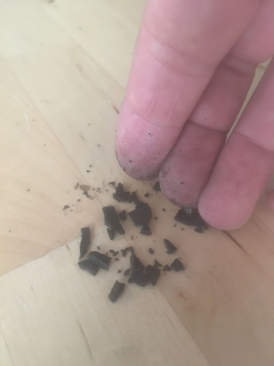

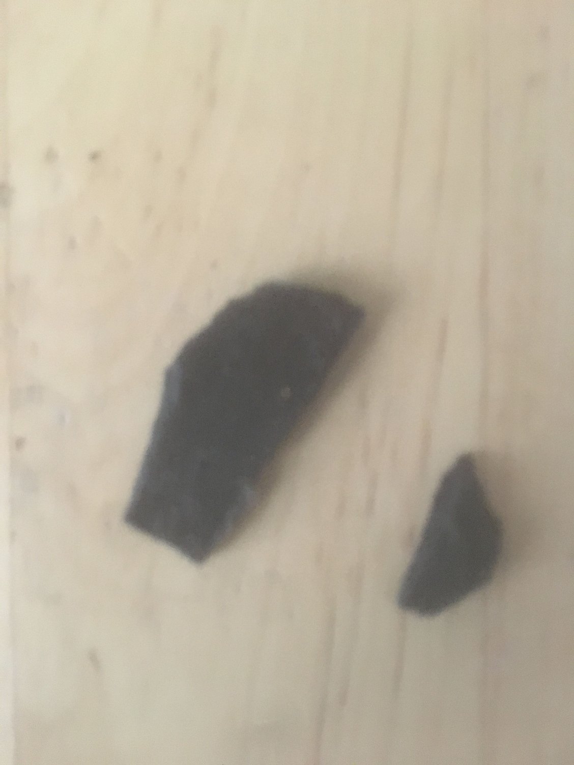

Default Mission accomplished!
The fragments were successfully sucked off! The nylon was so deteriorated that one could easily crumble it with the fingers. Anyway I’ll sleep more relaxed tonight.
Thank you for your tips and stay safe!
Sucked nylon
Crumbled nylon
