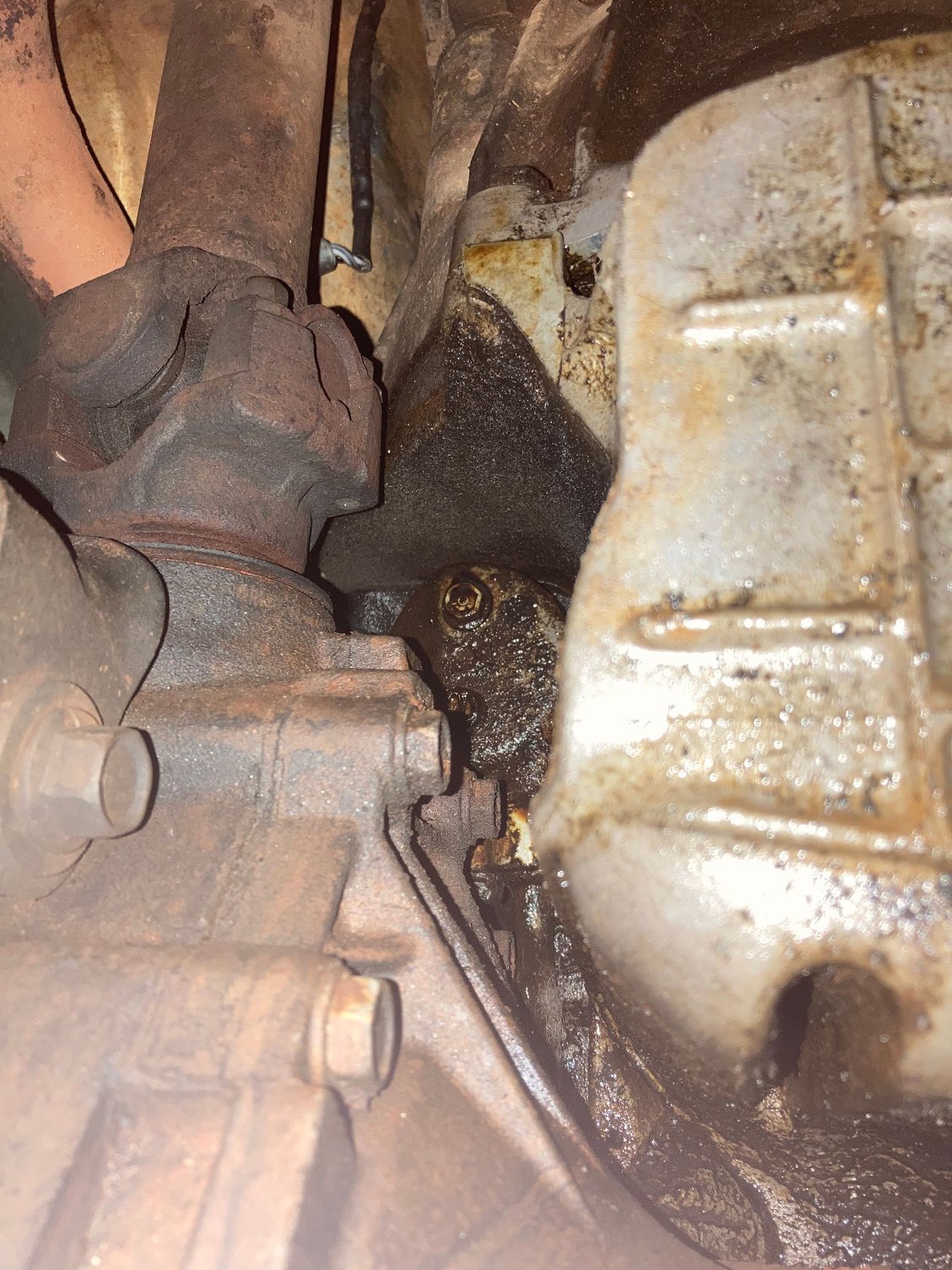

I’ve got an oil leak I’m trying to fix in my 03 2 door 4wd Blazer with 273,000 miles on it. I picked it up for $800 and it’s my first vehicle. Bought it as a project because I haven’t had the chance to learn auto repair and maintenance and I want to learn. I have this picture here where I believe the oil leak is. It’s tucked up in between the oil pan and the front differential with the driveshaft moving towards the rear. Anybody have any ideas on what the culprit might be? Possibly an oil pan gasket? Or what’s that part tucked up in the middle?

A common issue with the 4.3L is the remote oil filter lines or the o-ring where the oil filter line adapter mates to the block leaking. The round part covered in oil in your picture is the adapter for the oil lines to where the oil filter would screw into the block on motors without the remote oil filter.
Replacing these lines is a right of passage for Blazer ownrrs.
There are plenty of threads with hints on how to do it.

Okay. I’ll research that. Thanks a ton!
