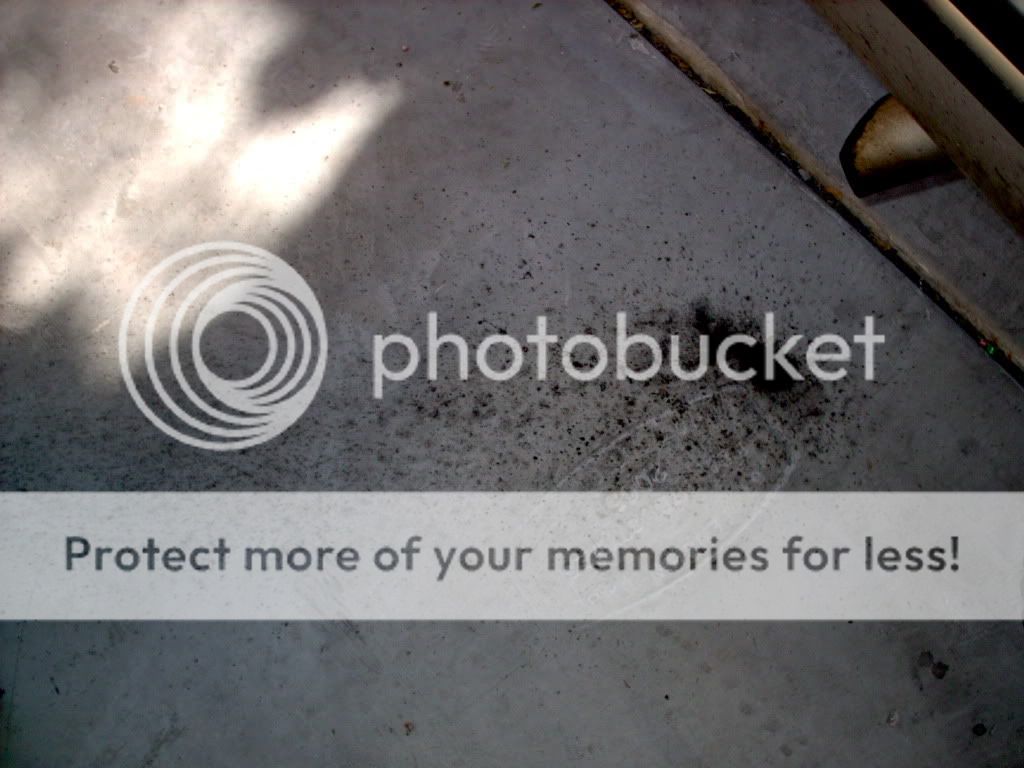

One thing I forgot to mention in previous posts was that the fan is coming on right away and staying on, if I remember correctly this is just because the computer has codes in it and makes the truck run in "limp" mode and runs fan, normal GM behavior if I recall correctly.
Heres a pic of what Im getting out of the exhaust, this is after about 10 min running time.
http://i59.photobucket.com/albums/g3...wetexhaust.jpg

What fan are you talking about? The "computer" has no input on the radiator cooling fan operation. I am not even sure that there is a "limp-in" mode in the 1st gen OBD1 setups either.
Does the junk continue to come out of the exhaust? Were you able to run a compression test on all cylinders to compare with the results you got on #1 (145lbs IIRC)?

Talking about the engine fan.
I know 94 2.2l and 95 2.3l(obd 1/1.5)engines hadwhat was called a"limp" mode and oncea code was set/stored the fan would run. The fan was controlled by the ecm. I worked on those motors for several years, and pretty much know them inside and out.
Stuff seems to come out of the exhaust when running not whenengine offif thats what you meant, as stated Ive run the engine about a total of 10 min during the time I have had it, and it has been it that same spot so the stuff on the groundhas accumulated over that time. It has a slight fuel/exhaust smell to it, about as thin as fuel or water but will not catch fire. I would almost say its just condensation or something if it wasnt blackish and the truck was running right.. but seems to be more than just that.
Did not run test on all cyl., just went with #1 since that is the cyl. the owner said was suspect, wishing I would have tested them all. Might rent tester again and do that.
