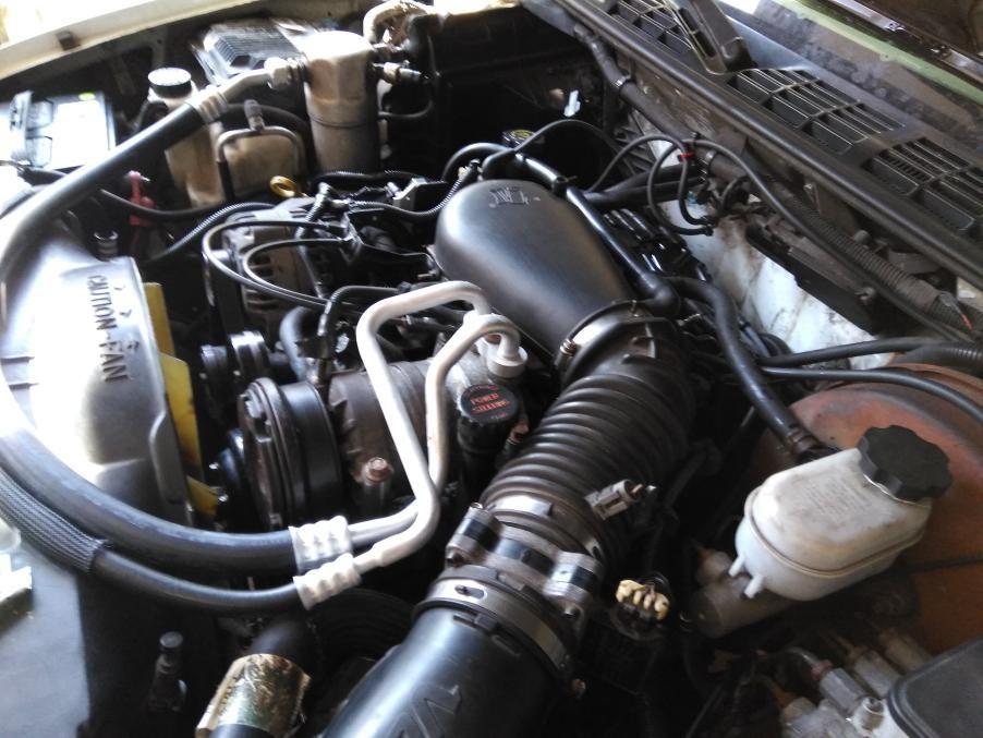

that pic was from a different thread where someone was trying to access the blend door from the engine bay, ignore the blue circle, you said the engine bay configuration is different?? that pic was missing alot of parts as i had to pull everything off the passenger fenderwell, Here is a pic of a completed, stock, 4.3 with a 2003 Block and California Emissions, Notice the only difference on top of the motor is an extra vacuum line that runs to a diverter actuator.
You mentioned a valve job, was any performance modifications done? either higher valve lift, ported heads/intake, or anything at all that would make it run differently, the PCM knows how a stock 4.3 should run and what it should see from its sensors, and if anything is done to make it run differently from stock, the PCM will pick it up and throw any number of codes, including the mystical P0300.

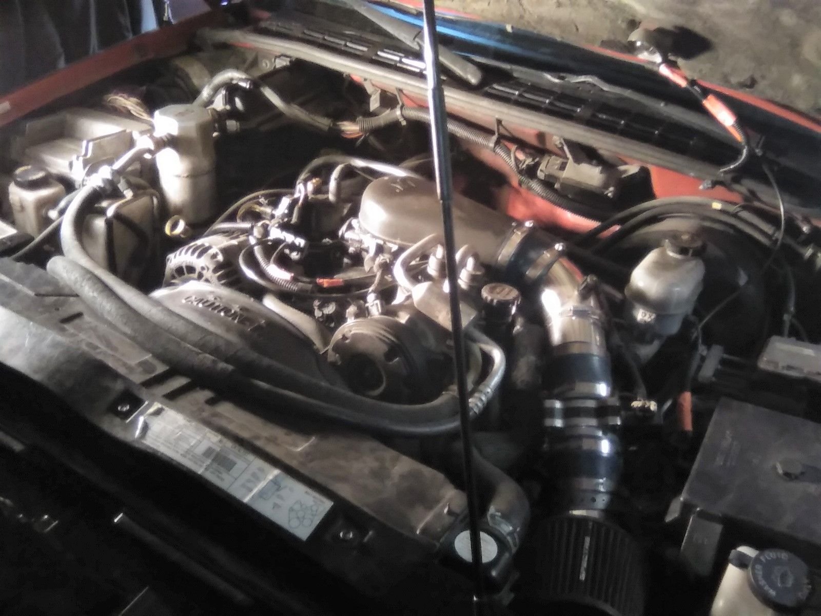

can you take a picture of the underhood of your truck? similar to the shot i had posted above.
Here are the photos of the engine bay, as requested!
2001 Chevy Blazer LS 4.3L engine bay

. it has a 411 PCM??
thought those were a model year 2003 and forward thing.
You mentioned the previous owner may have tried to tune it, have any way of verifying it?
and lots of exposed wiring...
