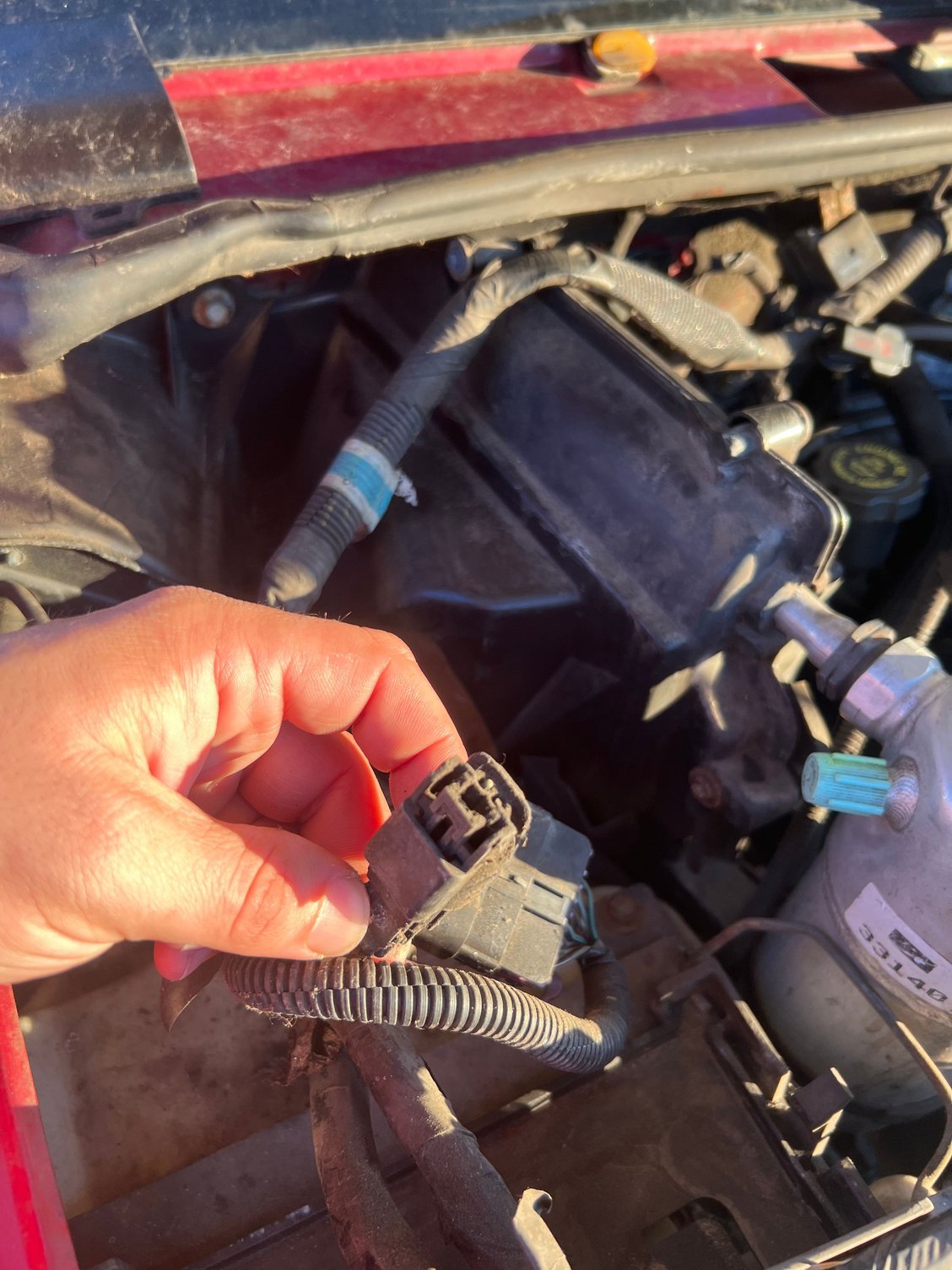

So I was checking the wires at the computer and found this plug with the wires cut. Not even sure what it goes to.

That is connector C102 - a jumper from the body wiring harness to the engine wiring harness. 2 wires: ckt 1694 gray/blk (4WD low signal) and ckt 1695 blk/white (axle switch signal). See attachments. I am assuming yours is 4WD vehicle - maybe not! The plug doesn't look like wires are cut - just not plugged into the rest of the connector.

Mine is a 2wd was just wondering what it was because it seemed off to me.

That connector would be unplugged on a 2WD. No problem there!
