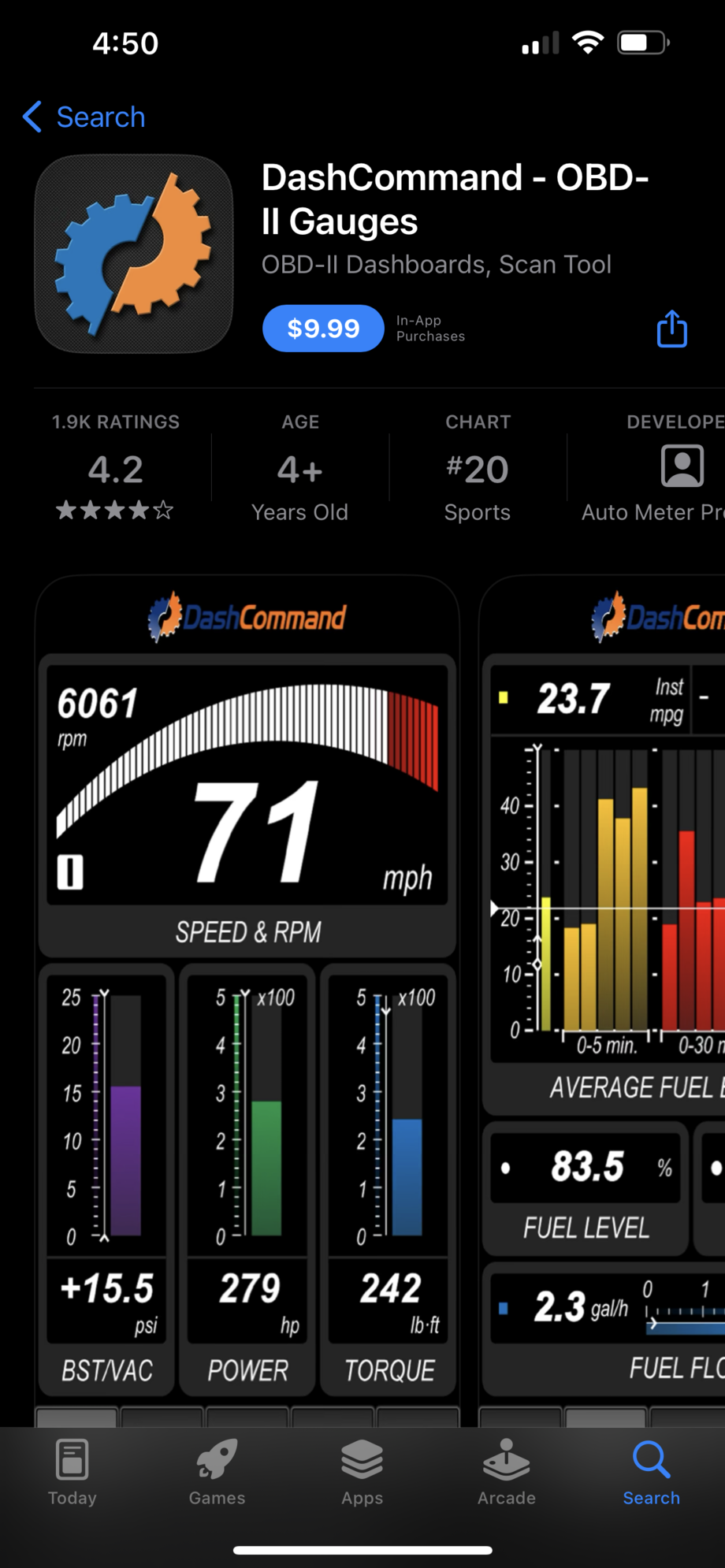

Originally Posted by LesMyer
Either Dash Command or Car Diagnostic Pro will read it. Thats about all your inexpensive options for cam sensor retard.
is this the app you’re talking about?
yes, thats it! Remember WiFi if you have iphone. Bluetooth if you have android.
