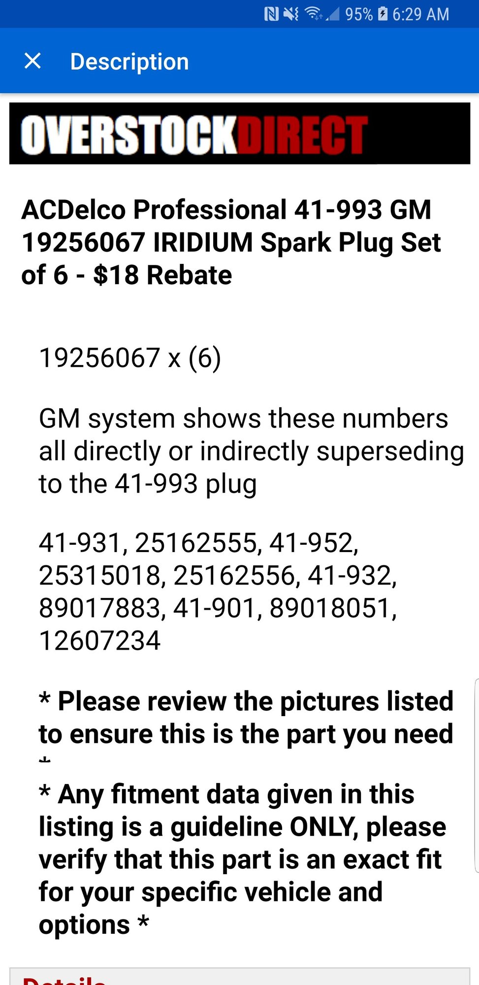

I just bought a set of AC Delco iridium plugs on Ebay for $26 with free shipping, and there's a rebate of $3 per plug going on right now, which brings it down to $8 for the set. Let me see if I can get the link for you.
