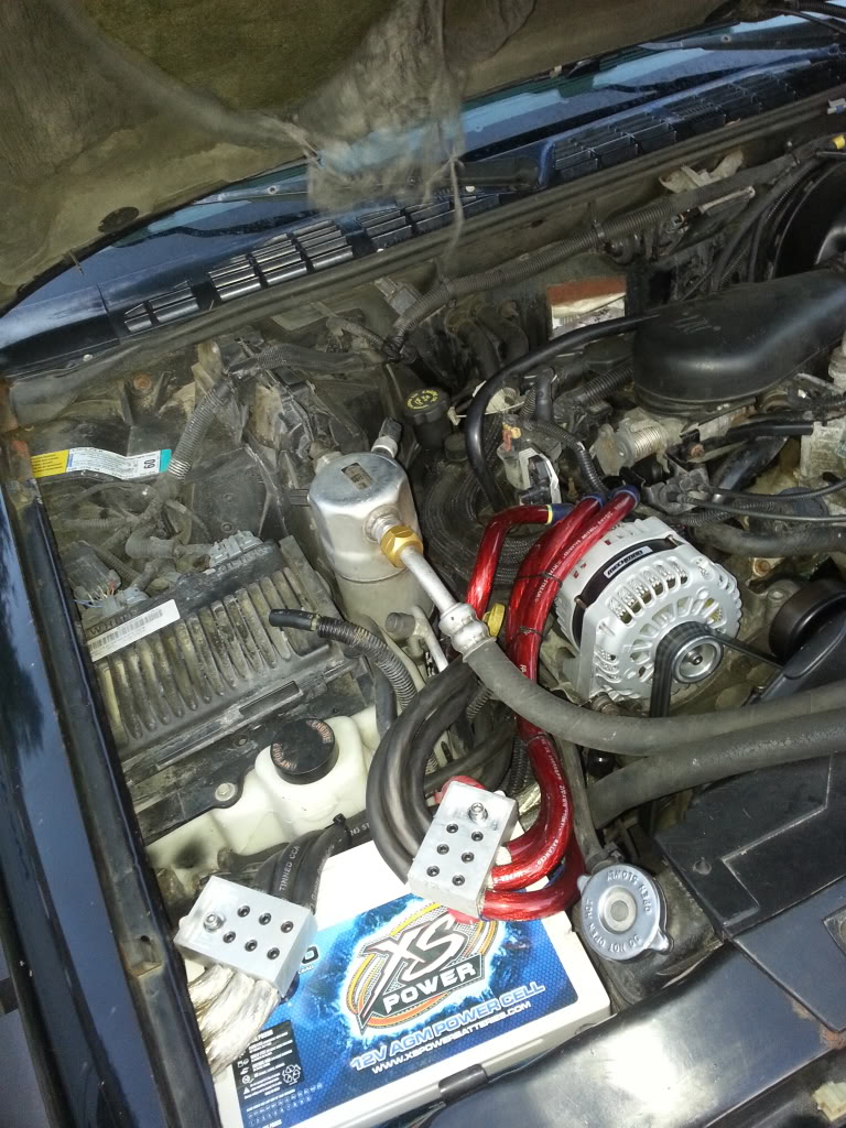

Well I've done some work here and there on my blazer.
I finally pulled the battery tray out. Found the actuator bellow was completely blown out.
Also the vacuum lines are all jacked up, so I'm still tracing it down... But the vacuum line to the actuator was going full time. Got it plugged up for now. I've already checked to make sure my front drive shaft turns and engages.
Now here's where it gets interesting. The other day, my GF and I were driving around the destroyed Six Flags outside of New Orleans. I popped the hood, (I have access to the cable and vacuum line still) pulled the cable and locked it in with some vice grips. Well went about 30 feet and had a loud heavy clunk from the front. Stopped and checked everything out, nothing appeared to be broken. Well I did a few 4Lo launches in some dense gravel. I don't think the front tires pulled at all. Hard to tell.
Now I guess I'm looking for suggestions on what to do from here. I'd rather not worry about the actuator get up. As, pulling that battery is not fun.... So is there a somewhat easy way around this? On the cheap side as money is going into other aspects of this truck.
I pretty sure my rear diff locks in fine still. I like tearing sheet up when I can and I see two tire marks every time.
