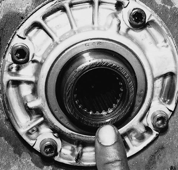

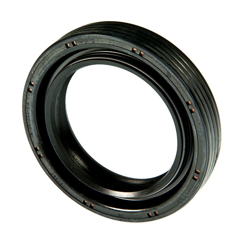

You have a failed transfer case input seal. You will need to remove transfer case and replace the seal and new gasket on extension housing. The transmission and transfer case do not share fluid.you will need the parts in the pictures below.
I like to remove the 4 10mm head bolts and remove the flange and change seal while it is off. Just will have to clean the surface on the flange and case and apply some RTV sealant.
Please feel free to contact me on Facebook at my page for any questions you may have as I am on there more than on this forum. So I can answer much faster. Good luck
