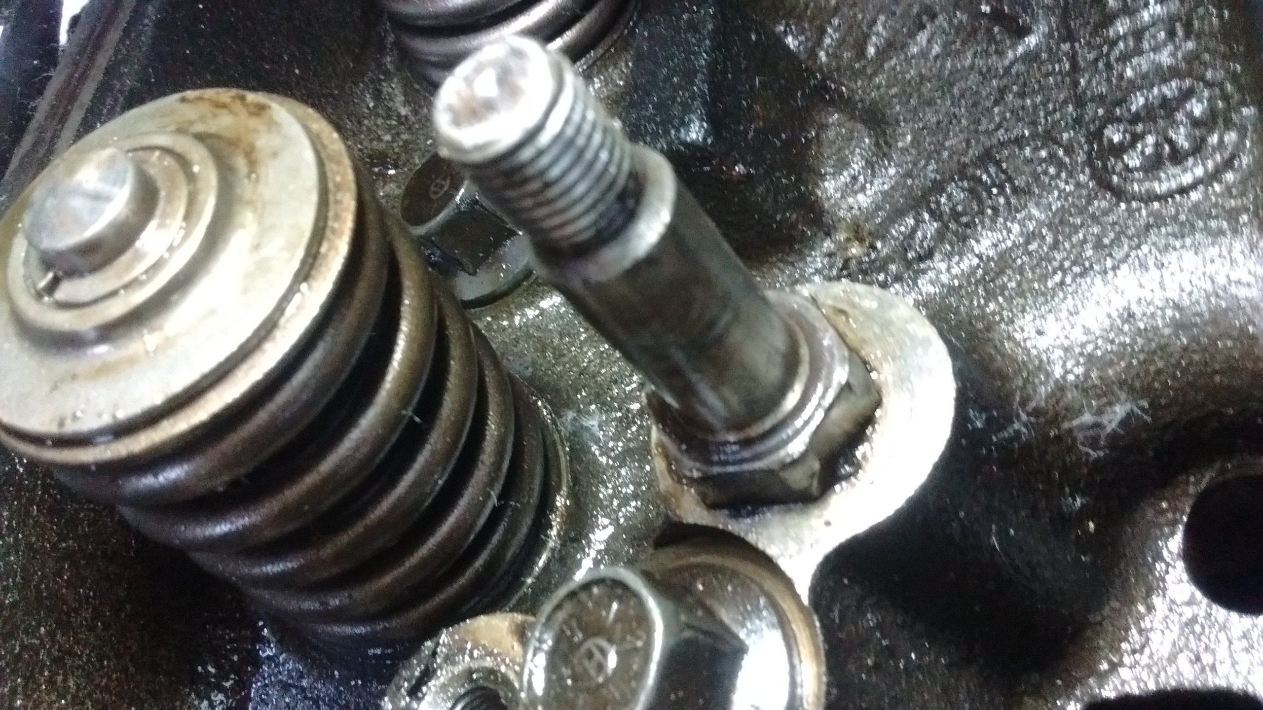

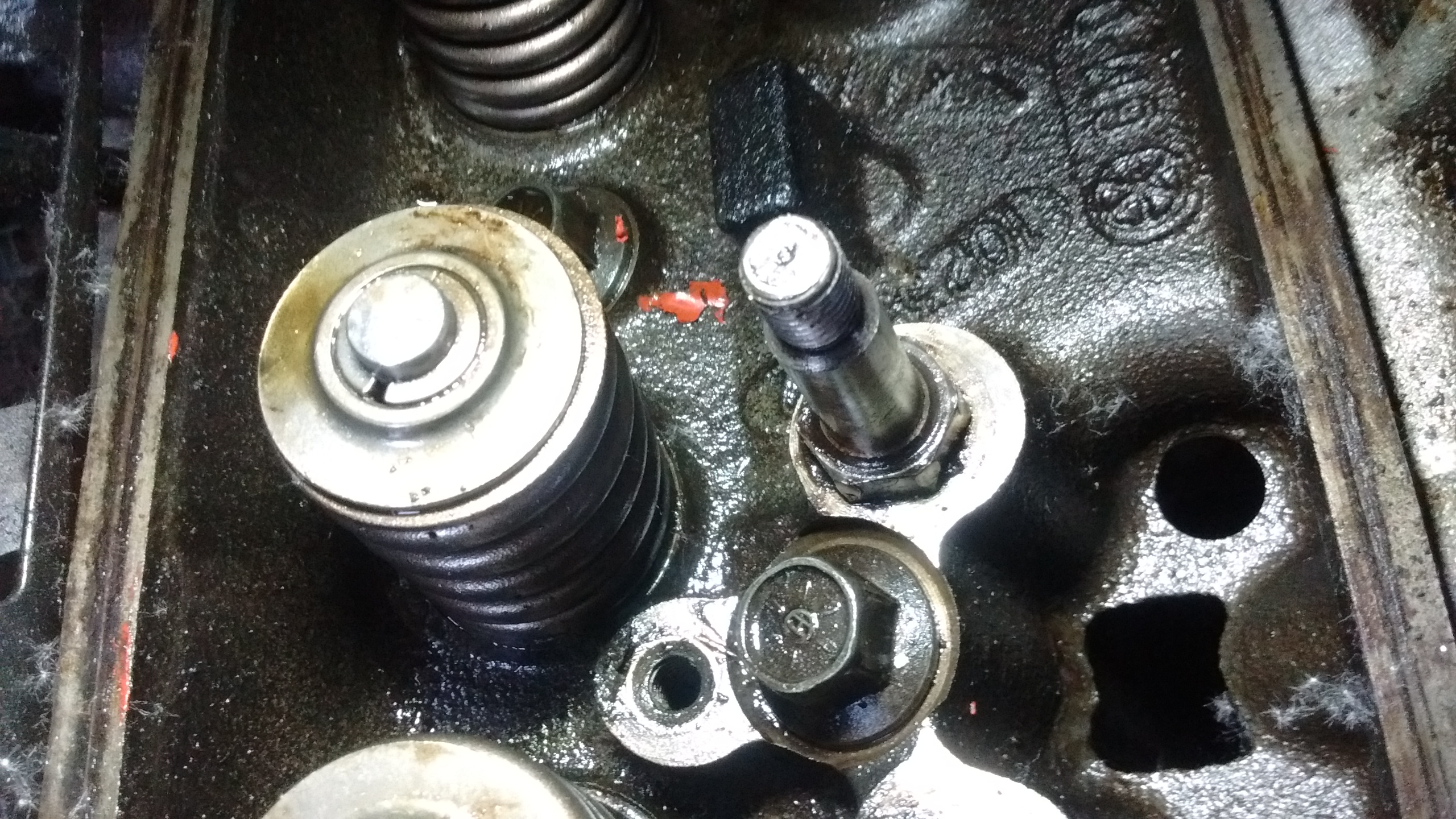

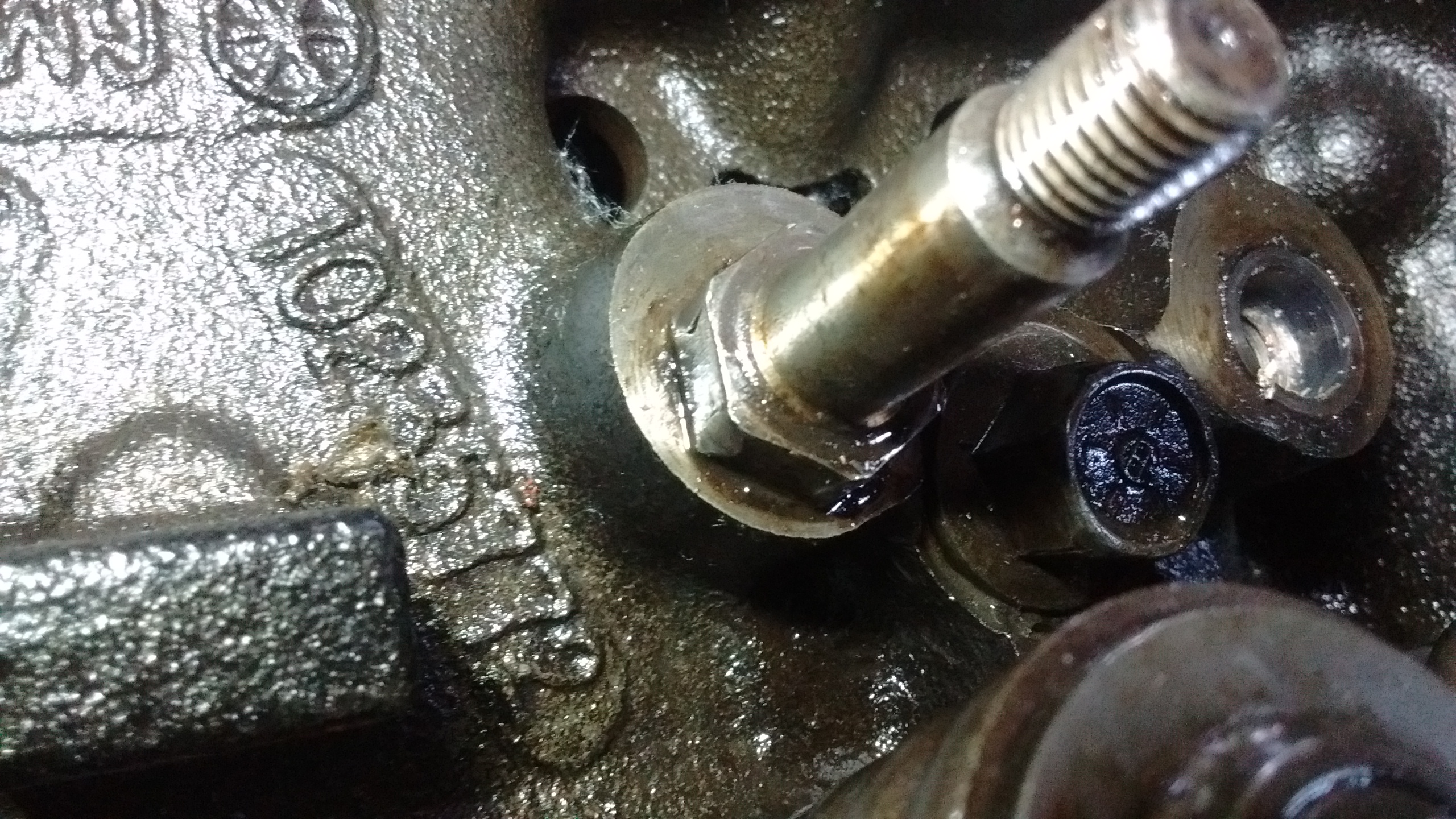

Originally Posted by Lesmyer
Can you please take a closeup photo of the rocker stud (top and side) so I can see what we are working with.
I'm sorry I started a job yestetday. Here are the pics of the stud from both side from the top...
Attached Thumbnails 97 Rocker Valve Adjustment-img_20170621_070019576.jpg   97 Rocker Valve Adjustment-img_20170621_070011670.jpg   97 Rocker Valve Adjustment-img_20170621_065957853.jpg

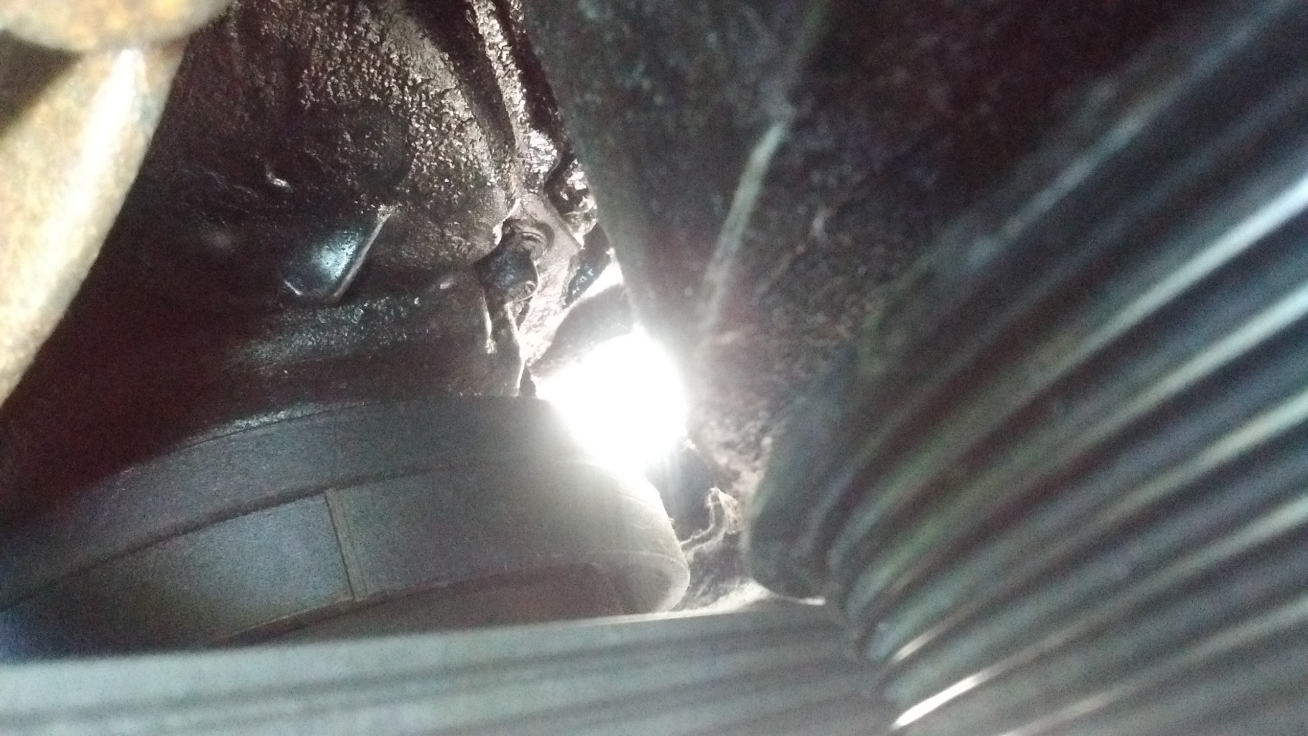

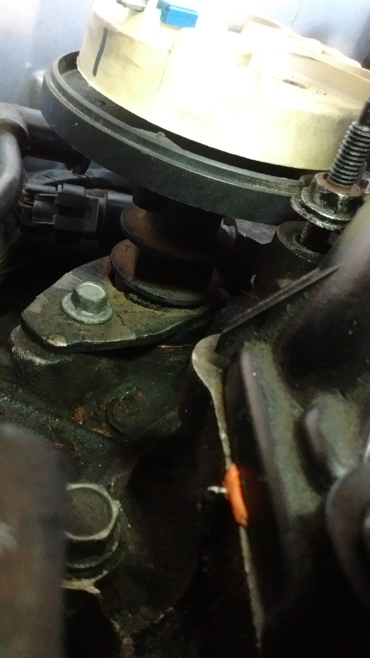

we will need to check to make sure distributor is in correctly.

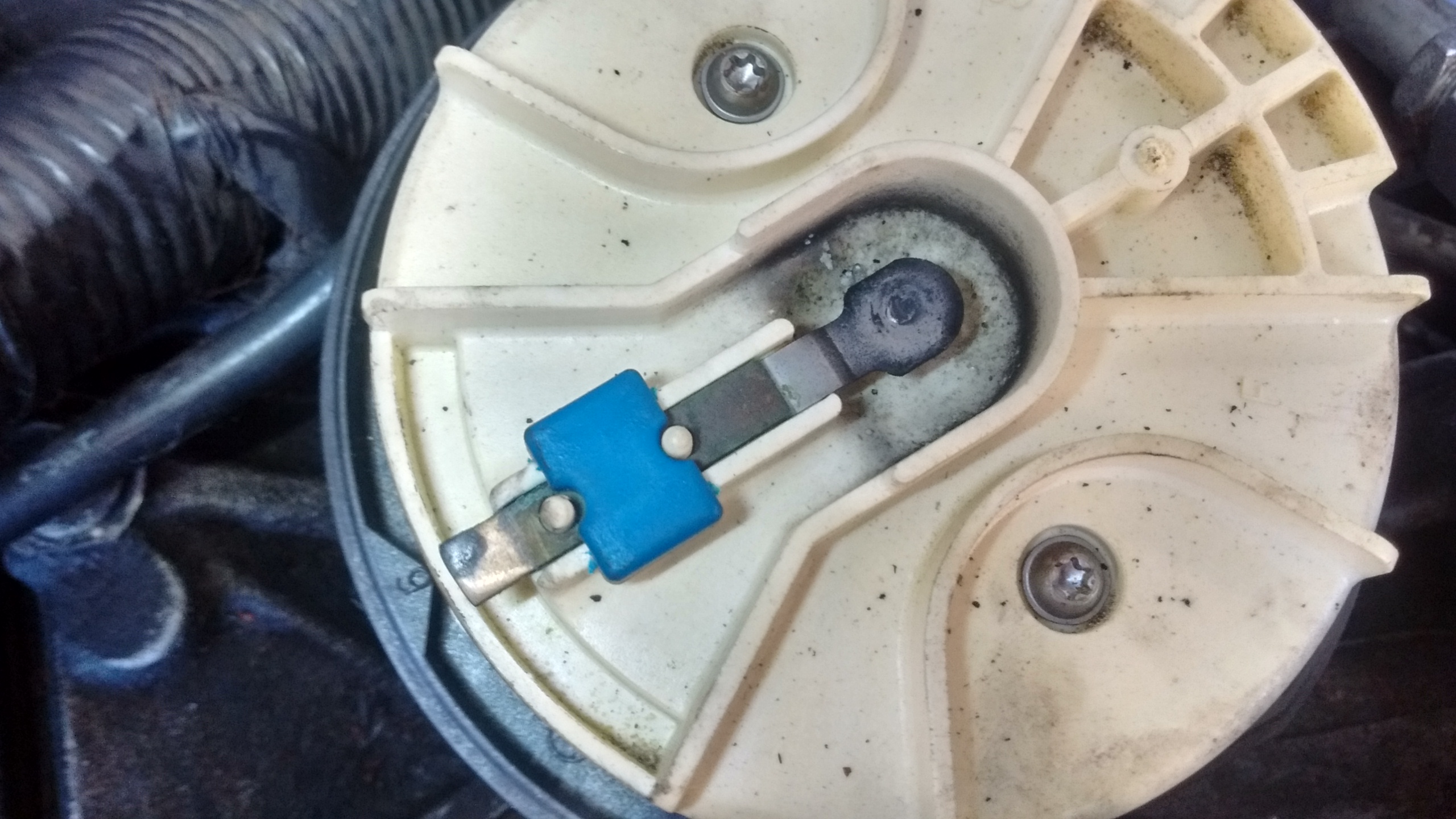

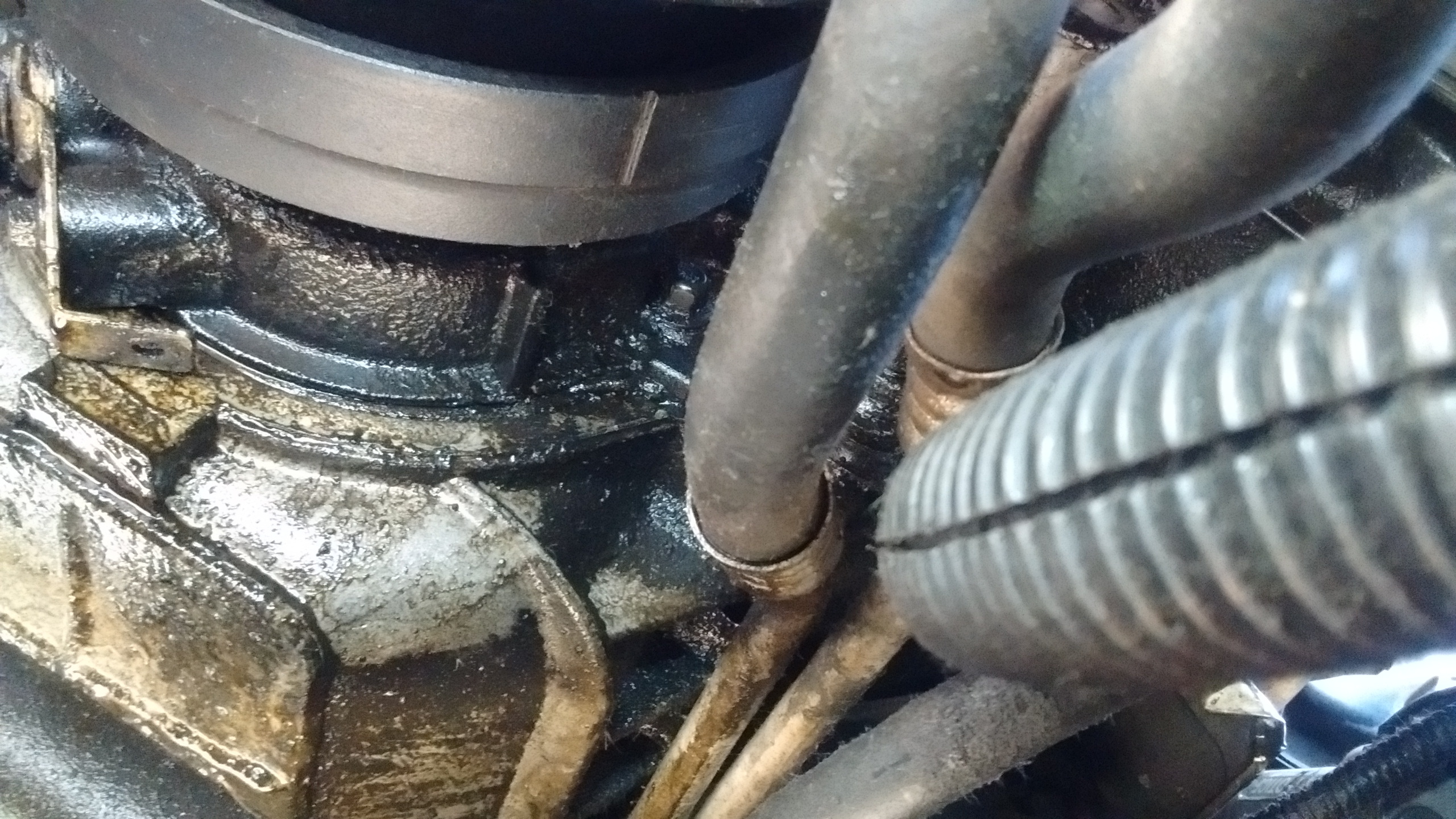

OK these are pics of the distrubitor pointer pointing at the 6 on the lip of the rotor, the timing lines on the harmonic balancer, and the flushed seating of the distributor to the intake manifold. At TDC #1. I also have a video setting it to TDC #1 and showing these points right after its done. I also uploaded a pic of my mileage.
Attached Thumbnails 97 Rocker Valve Adjustment-img_20170621_072235438_hdr.jpg   97 Rocker Valve Adjustment-img_20170621_072203247.jpg   97 Rocker Valve Adjustment-img_20170621_072335372.jpg   97 Rocker Valve Adjustment-img_20170621_070427556.jpg   97 Rocker Valve Adjustment-img_20170621_065804536.jpg
The stud does not seem very damaged to me. In my opinion, it is obvious you have been using either a 12-point socket, or the wrong size socket to try to take it out - a correct 6-point would have damaged it far more if it slipped. You will need a good-fitting 6-point socket to get it out. Also, the socket will need to be held securely against the head (past the stud) or it will start riding up as you turn it (just like your socket did - I can see the marks).
Can anyone confirm the socket size for the rocker stud? I have never taken one of these out on a 4.3. Are they metric?
Standing in front of the vehicle, there should be 1 mark on the balancer located at about 1:00 and another at about 5:00. The one at 1:00 should be aligned with the mark seen on this cover (yours is too greasy for me to truly make out this mark clearly, but it is in approximately the right place base on shape of the outer edge of the cover). Chevrolet / GMC V6 262 4.3L Engine Timing Cover Dorman 635-502 | eBay
The distributor rotor is indeed pointing where it should. So if marks on balancer and timing cover are lined up correctly, What you need to worry about is if the engine is on TDC#1 or TDC#4. You do understand that the marks are only correct during every other revolution of the crankshaft? - 4 stroke engine you know!
The way that I would tell is to take #1 spark plug out and stick my finger over the spark plug hole. Use a big finger and don't stick it inside the hole (remember what can happen to things stuck in the cylinder). I have someone else tap the starter just a bit at a time on the engine until l start to feel compression (it will blow your finger off the hole). Then know that the very next time rotation of the crank lines up the marks (won't be far), that is TDC#1 - so once you feel compression, don't use the starter to turn anymore - turn it manually. Then once on verified TDC#1, check where the rotor is pointing.
I see an orange gasket out of place under the plastic cover for the intake manifold in pic 7 of 8 and a loose bolt.
Standing in front of the vehicle, there should be 1 mark on the balancer located at about 1:00 and another at about 5:00. The one at 1:00 should be aligned with the mark seen on this cover (yours is too greasy for me to truly make out this mark). Chevrolet / GMC V6 262 4.3L Engine Timing Cover Dorman 635-502 eBay
The distributor rotor is indeed pointing where it should. So if marks on balancer and timing cover are lined up correctly, all you need to worry about is if the engine is on TDC#1 or TDC#4.
The way that I would tell is to take #1 spark plug out and stick my finger over the spark plug hole. I have someone else tap the starter just a bit at a time on the engine until l start to feel compression (it will blow your finger off the hole). Then know that the very next time rotation of the crank lines up the marks, that is TDC#1 - so once you feel compression, don't use the starter to turn anymore - turn it manually. Then check where the rotor is pointing.
nice observation ! OK and yea it seems as if the socket size I'm using is slightly too big, biggest deep metric socket I have is 15mm and I believe thats too small.
