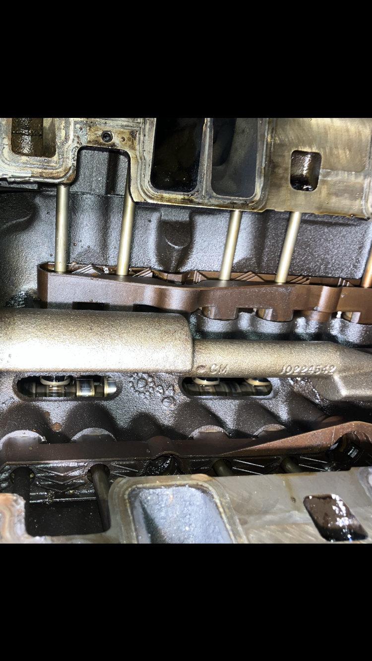

I’ve included some pics, below.. and as luck would have it, a short video of starting the motor by mistake during my first compression test on the #4 cylinder (I had no idea pulling the fuel relay doesn’t shut the fuel supply down, just doesn’t prime it). So you can hear the motor wants to run, even on 5 cylinders (gauge is plugged into #4 spark plug hole). When I first started on this, before the MFI conversion, it idled, ran, and I could have probably driven it, but was afraid I would really cause damage because the miss was noticeable (whole vehicle vibrated). When I pulled the plug wire to #4 though, the miss was twice as bad. That was almost a month ago (had to wait for warm days off to work on it) so it’s been sitting a while. I will put new lifters on, though I’ve heard you shouldn’t either use new lifters with an old cam, or a new cam with old lifters? Again, I’m just going on what I’ve read from others…I don’t really know. I’m thinking about replacing the distributor too (not just the cap & rotor). Some others have said that a worn distributor causes odd problems like misfires. I’ll definitely start with the lifters though. Btw, that recommendation about running compression tests was very interesting. Wish I had known/done that first. Thank you for all your help. I really appreciate this!
#4 Intake rod and lifter on left..exhaust on right. Hard to see, but there are rollers under the flat bottom.
#2 (left) and #4 (right) rods, lifters

I wouldn't jump into replacing lifters. If you pulled a plug wire off #4 and it got worse, then #4 is not misfiring - it is somewhere else. And definitely roller lifters, not flat tappet lifters - so not a lot of chance of cam lobe being worn. Let me think a bit.
