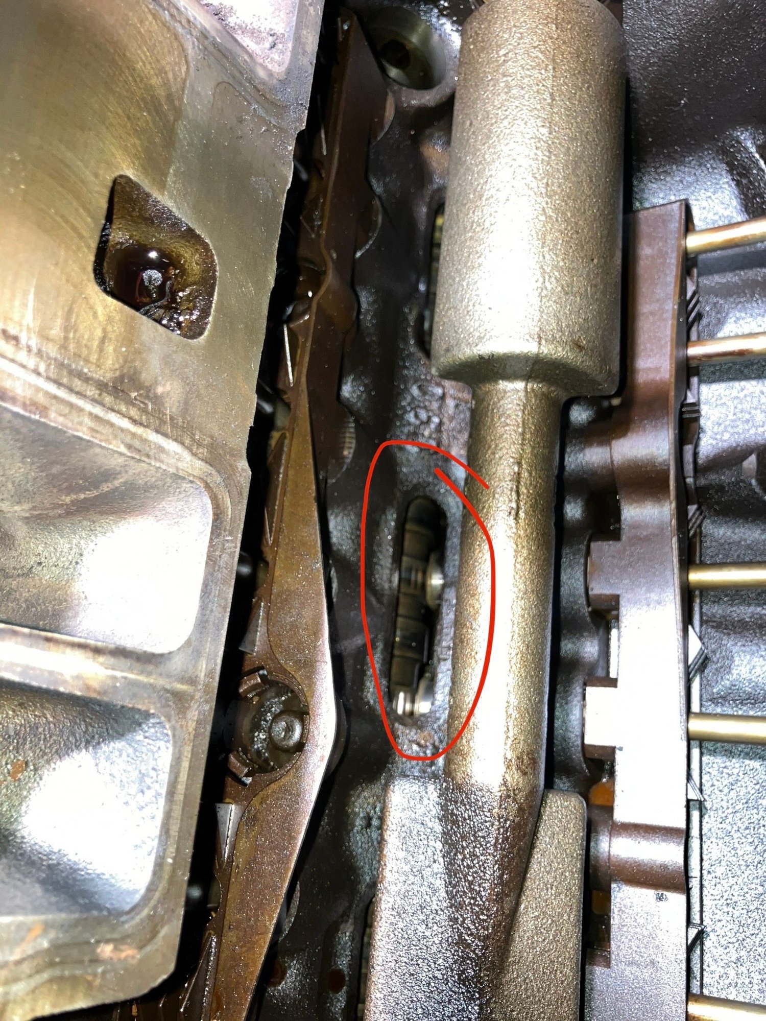

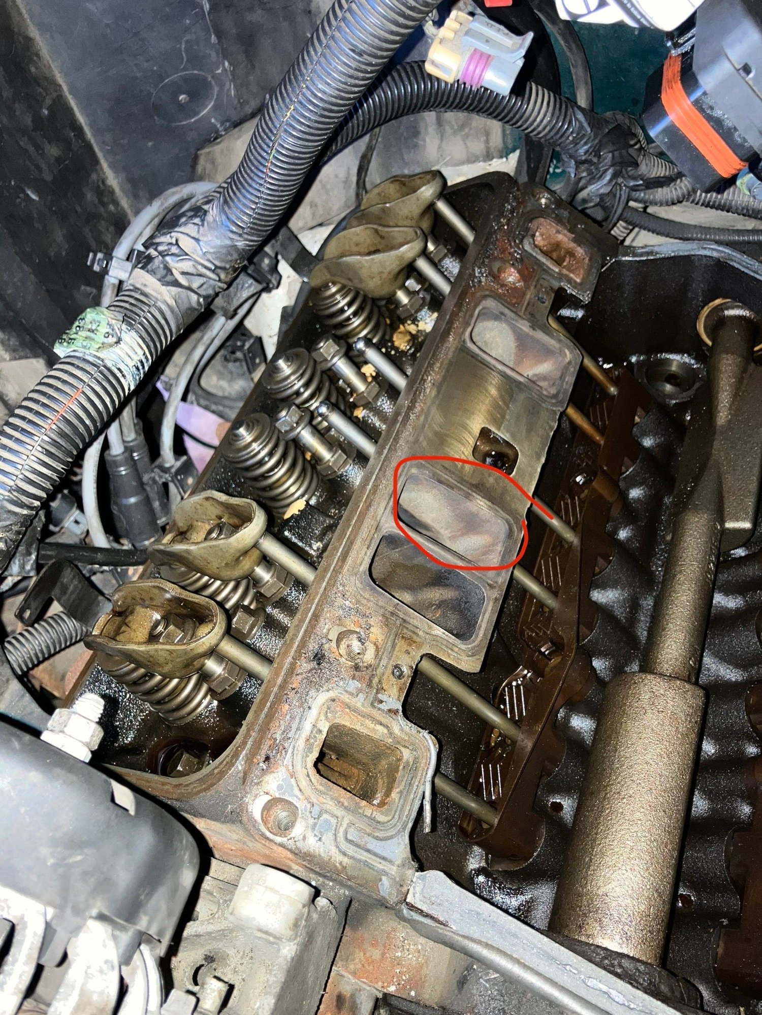

Default Pressurized #4 with rockers off
So I pressurized #4 to 100 psi and air poured out of the it’s intake (circled in the pic attached). It was also coming out of the space where you can see the camshaft/lifters (not sure if that has a proper name…I included a pic with that circled too). I used a rubber tube to listen to various places, and didn’t hear any coming from the exhaust, but some noise from the dipstick tube (not nearly as pronounced as the intake). I turned the motor just to see what would happen if I pressurized it at different positions. (I know it shouldn’t matter with the rockers off, but I was curious). Seemed to me the intake leak wasn’t as bad when I turned the motor 90 degrees. Doesn’t make sense to me, but I’m already pretty confused.
Leaking enough air to easily feel with my hand.
Noticed air noise from here when I used a tube to listen for leaks elsewhere

OK - #4 intake valve is leaking for sure. Pull head off for inspection.
