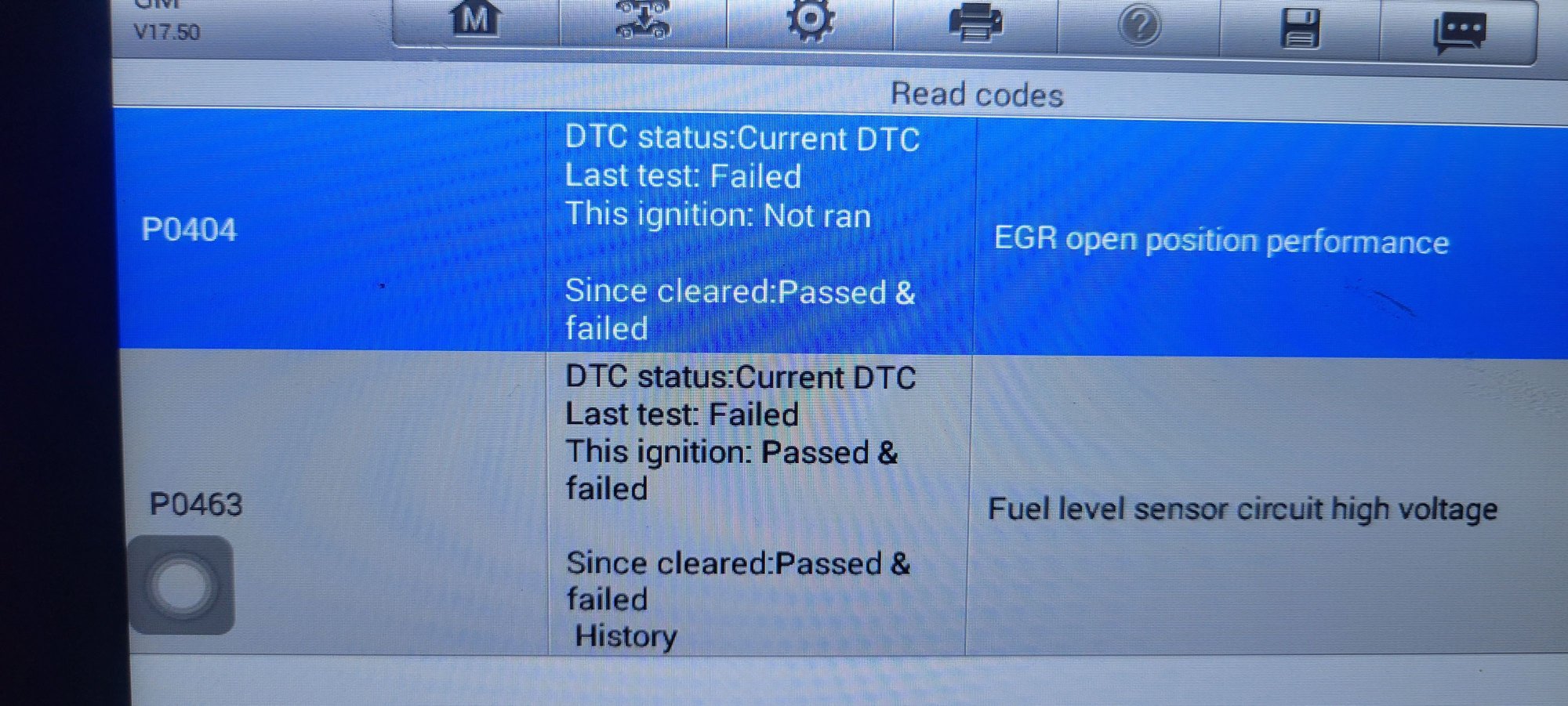

UPDATE
EGR open performance code keeps popping up after I've cleared it from the scanner. It has a brand new egr valve with the screen gasket. I attempted to poke through the passage ports to make sure anything wasn't blocking the flow. The ports don't even look that dirty. I'm stumped, don't know what else to do...
