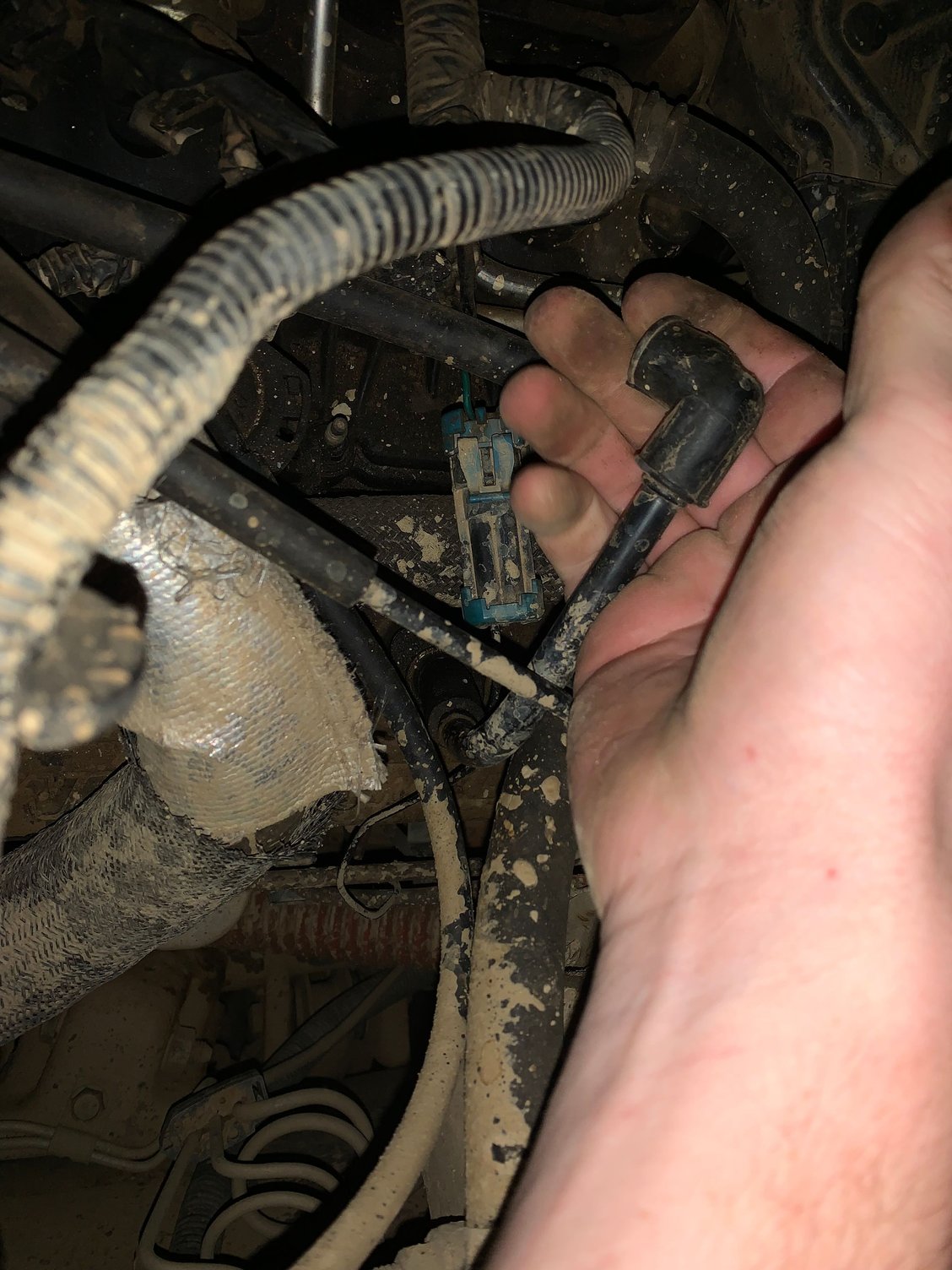

Loud air leak coming from this elbow

Will this cause the car to misfire and does anyone know the name of the part.97 Chevy blazer
Old Apr 20, 2023 | 02:15 AM
That looks like it could be the vacuum supply connection that supplies vacuum to the HVAC actuators and the 4wd system.
A large vacuum leak could cause the engine to run incorrectly due to the mixture being off.
To check if I am correct, follow the hose that is connected to that rubber elbow and see to what it connects. You might find some other rotten vacuum hoses too.
