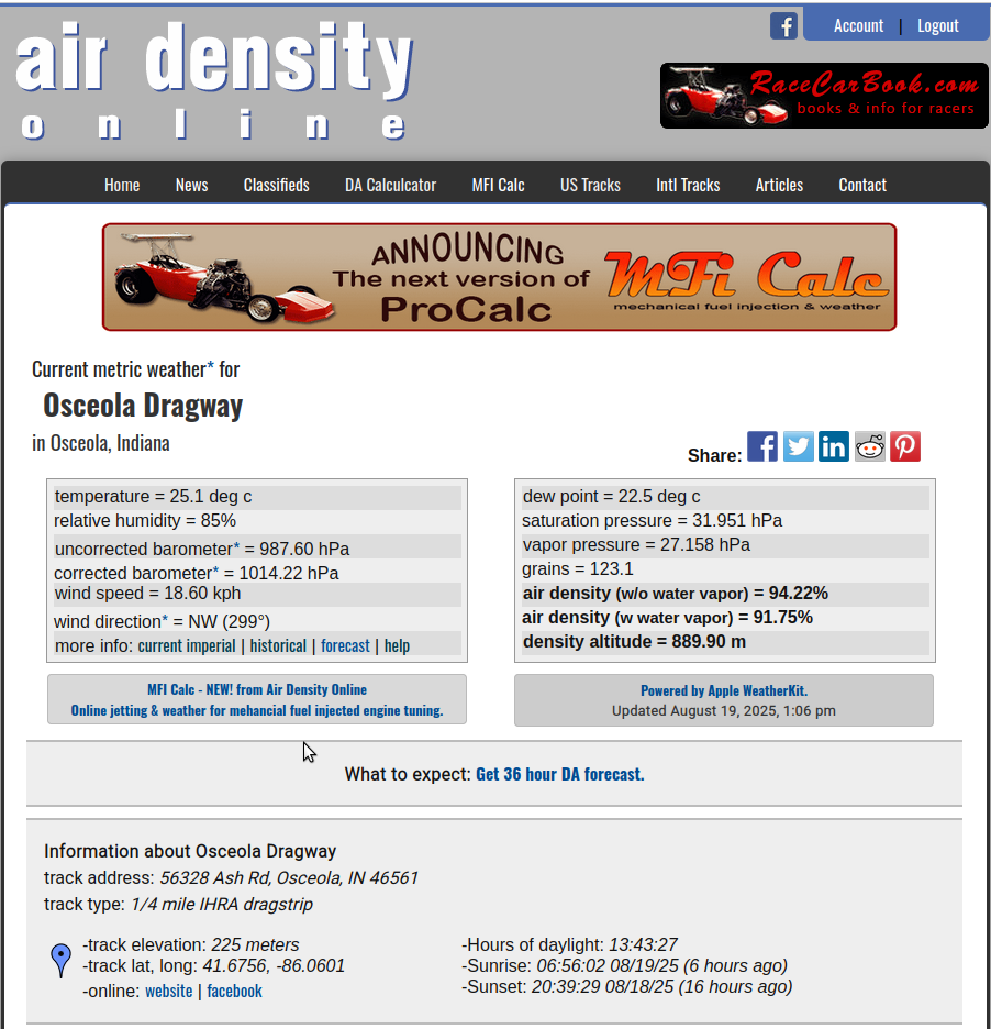

Here is some more data. Note that it's a cool, rainy day about 75 degrees. Air Density is 92.75% of the Standard Temperature/Pressure (STP) value. It was also right at 92% during the test on August 6 before. So I would expect similar results. And they are.
Also interesting is that Dash Command is not getting the same bandwidth out of my OBD2 adapter as Torque reports that it gives. Takes 0.3 seconds to update 5 pids during logging and they go in sequence so not all timestamps match up exactly and not all RPMS are exact. I think that RPM can go up a lot during 0.3 seconds on a 1-2 shift. Maybe I need to look at all the logging options I have available to me. I think Torque will hook up to my USB OB2 adapter I got for Scan XL Pro, and I know that particular adapter gives fantastic scan rates as it is hardwired. Seems like I must have tried in with Torque before, or how would I know that? Live and learn. I'm getting a bit of good information (for myself anyways) out of this exercise!
