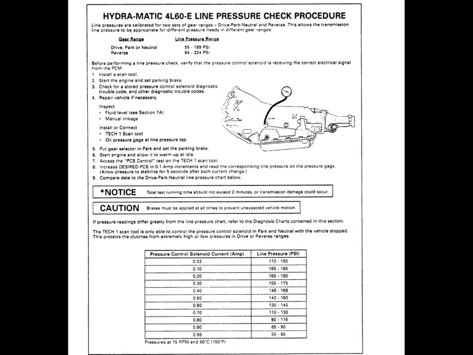

By any chance do you have a resource for the spec, I've looked around but cannot find a chart or anything to go by.

The original problem is solved. The small surge and associated feeling has resolved. This is a much larger RPM difference and was confirmed by checking the truck at RPM in 3rd Gear as opposed to running in O/D and feeling the surge.
If i can find a resource chart to check the Pressure ranges i should be seeing I will hookup the gauge and test it.

Old Nov 6, 2018 | 12:33 PM
LesMyer's Avatar
Joined: Oct 2014
Posts: 4,353
From: North Central Indiana
OK - so it's a 4th down into 3rd shift, right? There is your pressure spec and test procedure! But if you have had all the tap cell data cleared shortly ago, shouldn't you give it a chance to learn how to correct itself on the 3-4-3 shifting. I have no idea how many miles have passed since then.
