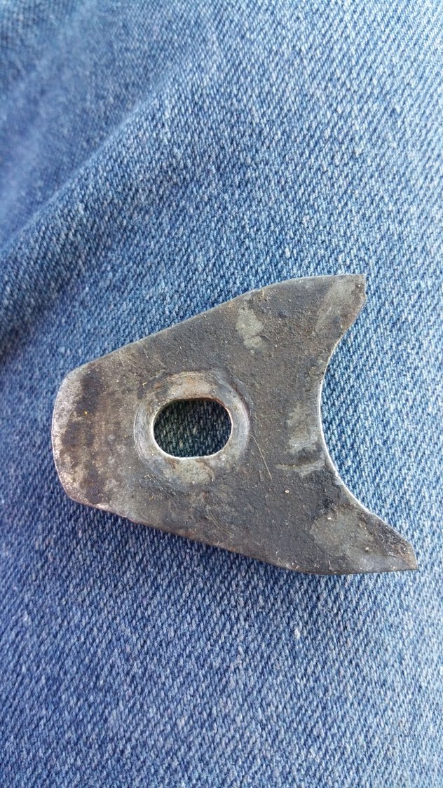

Ok, I can't thank you enough for that scanner info!
Here's what I made, but wife wanted me to wait till this weekend to mess with it cause it's running now. She has caught on how when u mess with a car there's always that chance that it can get more complicated than what u "plan" to do lol.
Here's a pic of what I did

As long as it locks it down that will be great. Good job!

I had to bend the tips down to get it to grip,
For future reference do that b4 u cut it lol
ok got it down to 6 @2k rpm's
its idling at about 550, hasnt died on me yet but i get nervous sometimes lol
im not sure i could get it better cause im worried about putting it in a bind? We had it hit 0, but no matter when we tighten it then it goes back to 6
is 6 acceptable???? how acceptable??
