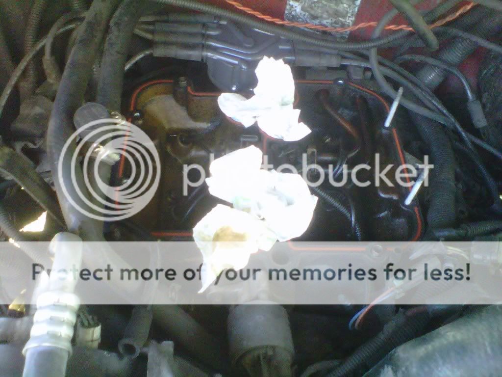

Well i put in the pump and it ran a hell of a lot better than it did but it still does the same thing. I checked the egr hole and it was almost spotless. But I also saw this when I pulled the upper plenum.
So I'm guessing my fuel pressure regulator is the culprit here?

it does smell like gas when I got up in there and it's night and day compared to how dirty the other side is.
