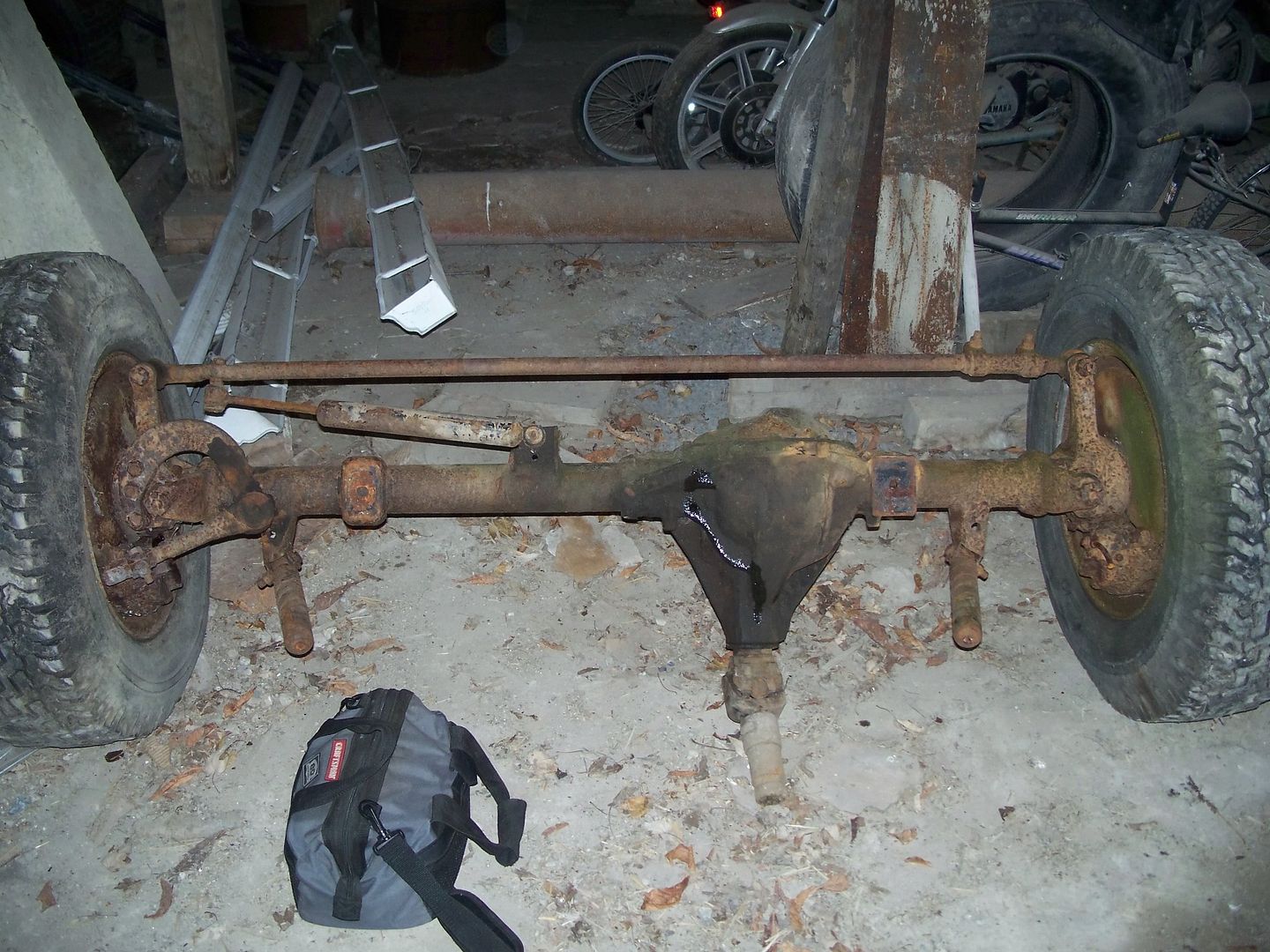

My free 14bff (by virtue of me stuffing it in the woods 13+ years ago when we cut it out from under one of our farm trucks):
