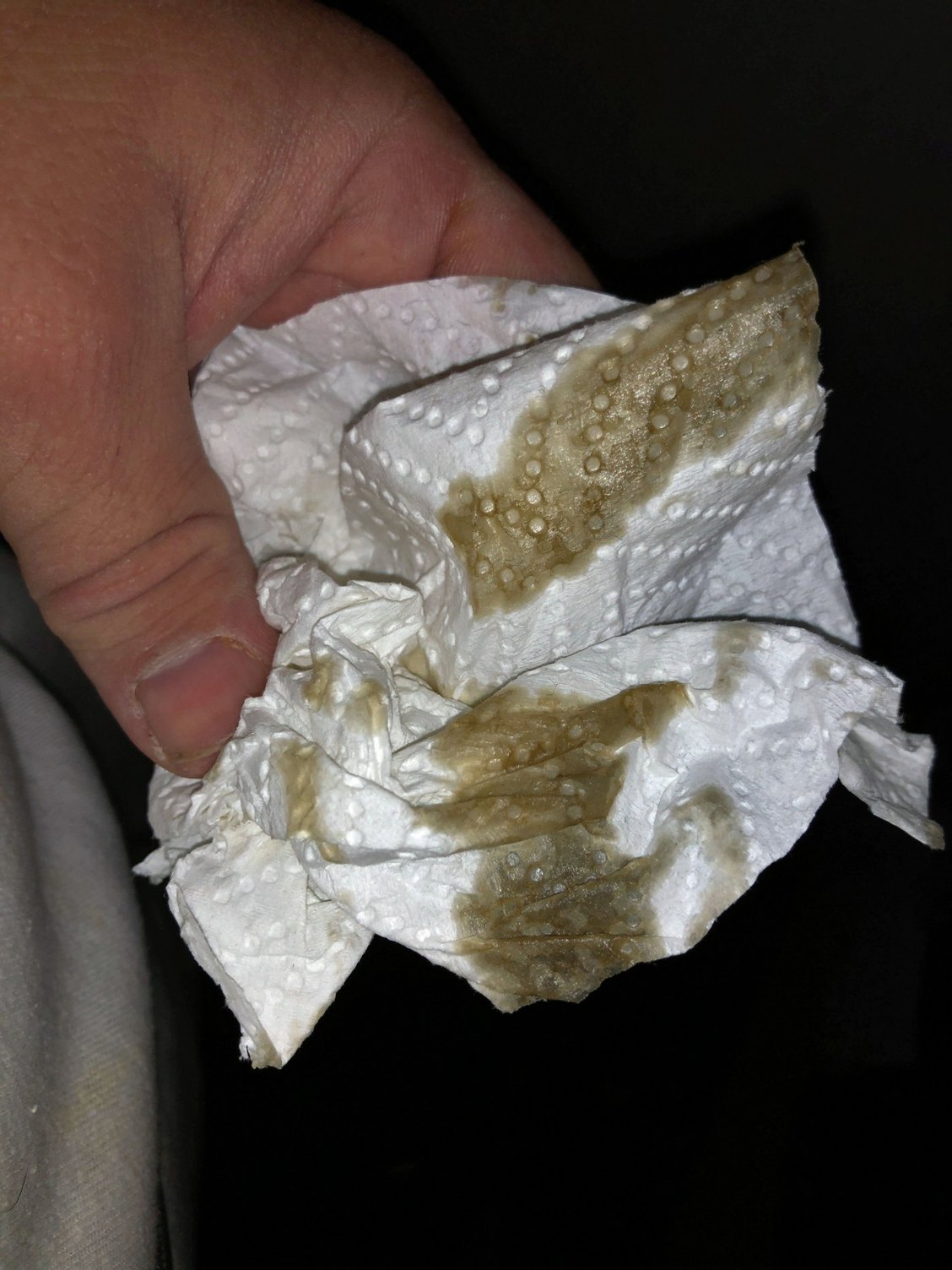

I checked the oil as suggested, I would not describe it as chocolate milk, still relatively clear and just looked like normal motor oil, though judging by this paper towel it should probably be changed soon.
Change the oil?

Since the oil is clear I would assume that air worked it way refill the overflow with the proper coolant mix...Do Not mix green coolant with the Orange dexcool or you will create a sludge that doesn't cool.
Sorry if that seems basic but it's been done more than once.
