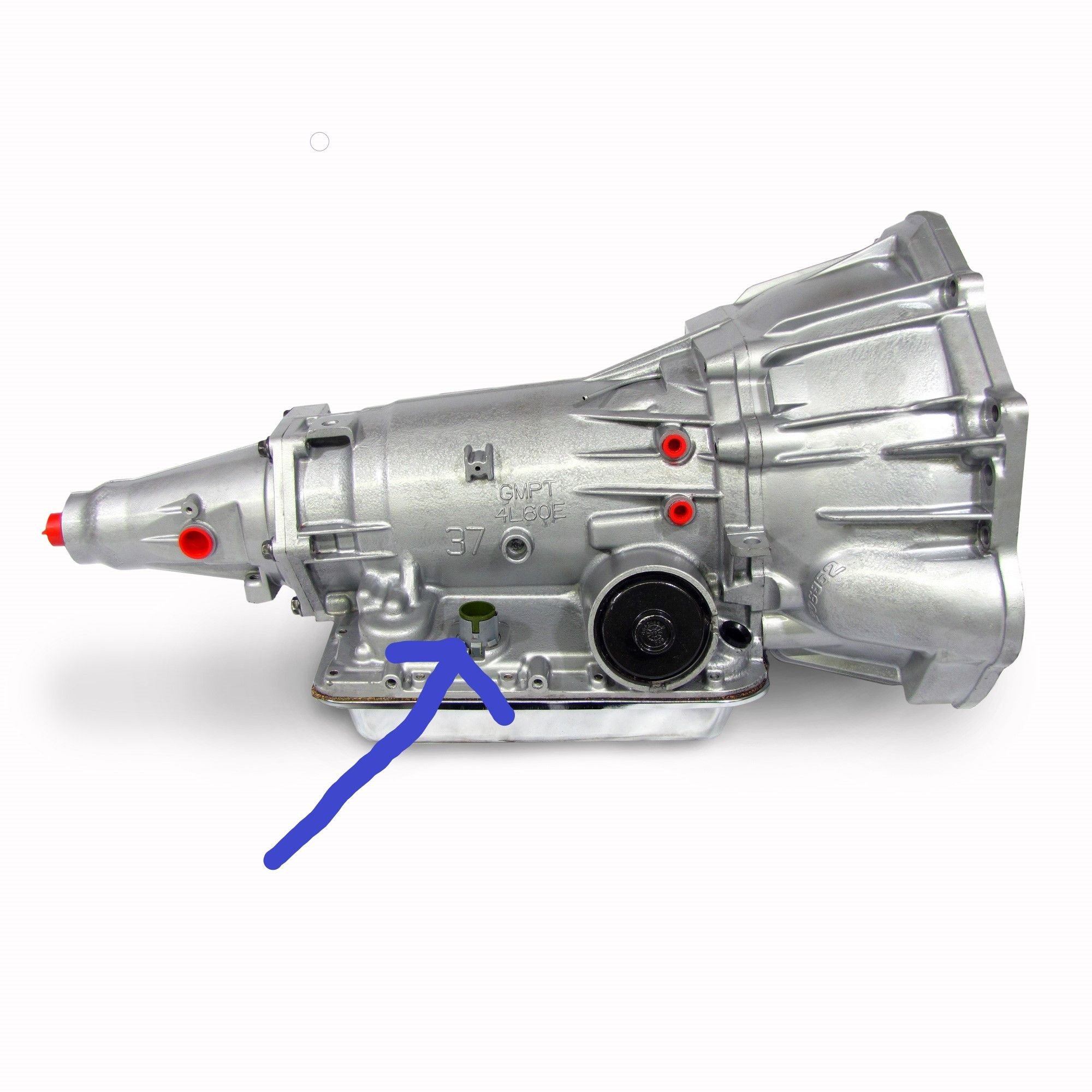

The power for the shifting solenoids comes from the Clstr Fuse which also powers some of the dash indicators. I had hoped that the fuse was blown, explaining the loss of power for those items common to that power circuit. Since that is not the case, there may be a wiring problem in that power circuit downstream of that fuse or before the fuse. First check that 12v is coming into that fuse with the ignition in the run position. Then check to see if 12v power for the solenoids is making it to the transmission connector from that fuse, I suspect not. You will need to remove the connector and probe pin "E"/pink wire on the harness side with the ignition in the run position. Be careful not to damage the connectors by forcing large probes into the socket connectors. Report back.
