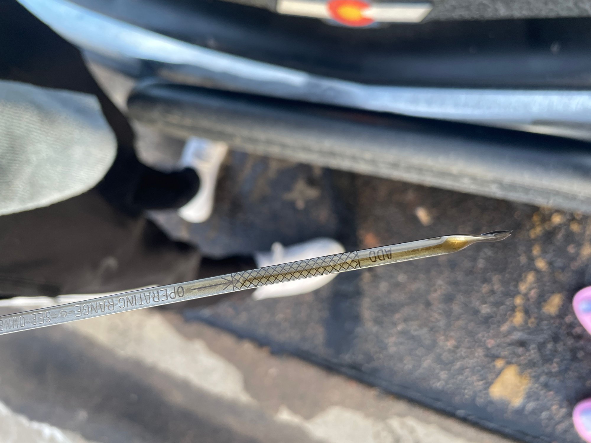

Nope. Got an oil change 2 days before this. Checked the oil anyways to make sure everything was fastened down properly and i still had oil and if anything, i had to much oil. shop did it so it got dropped off at the same shop that changed it
