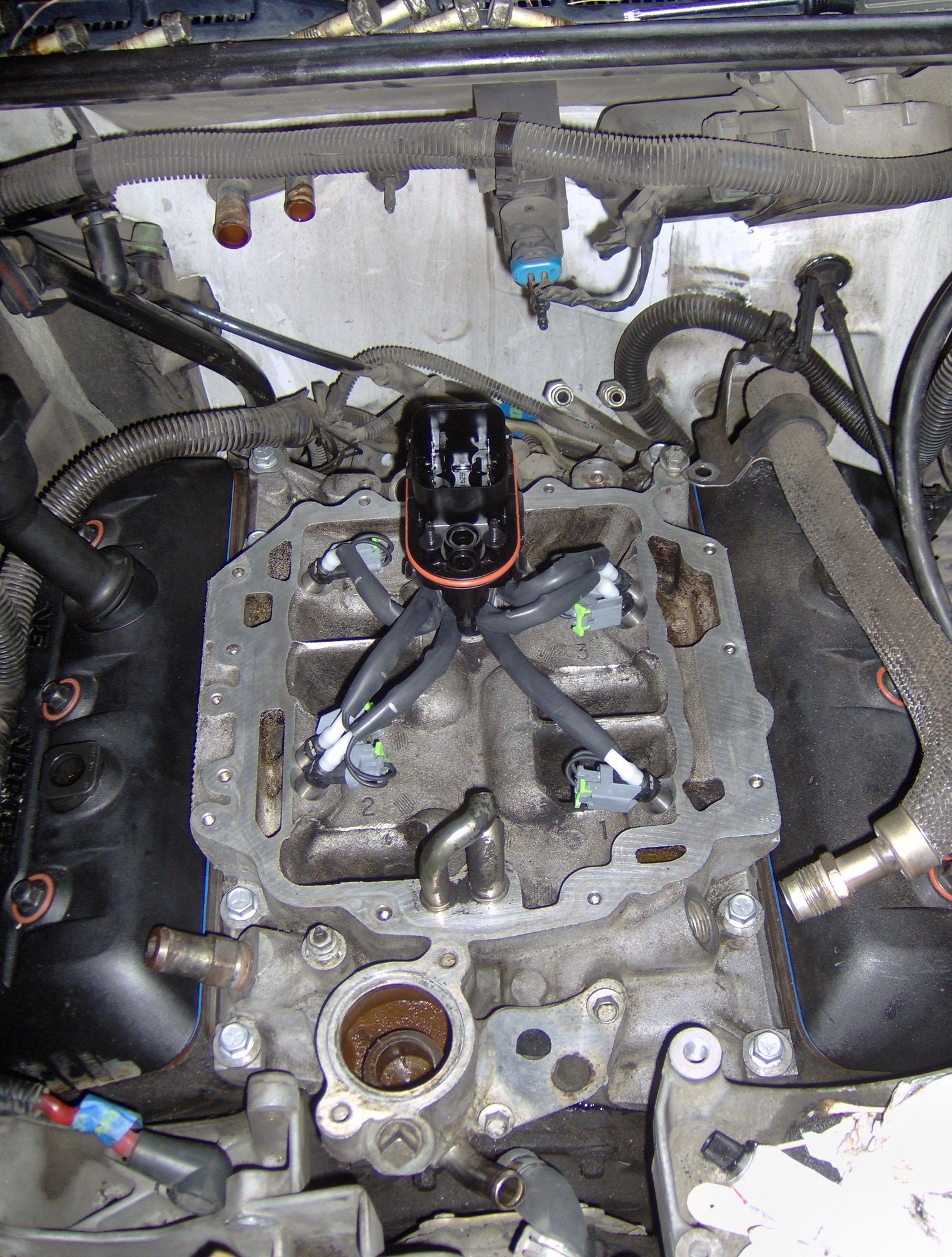

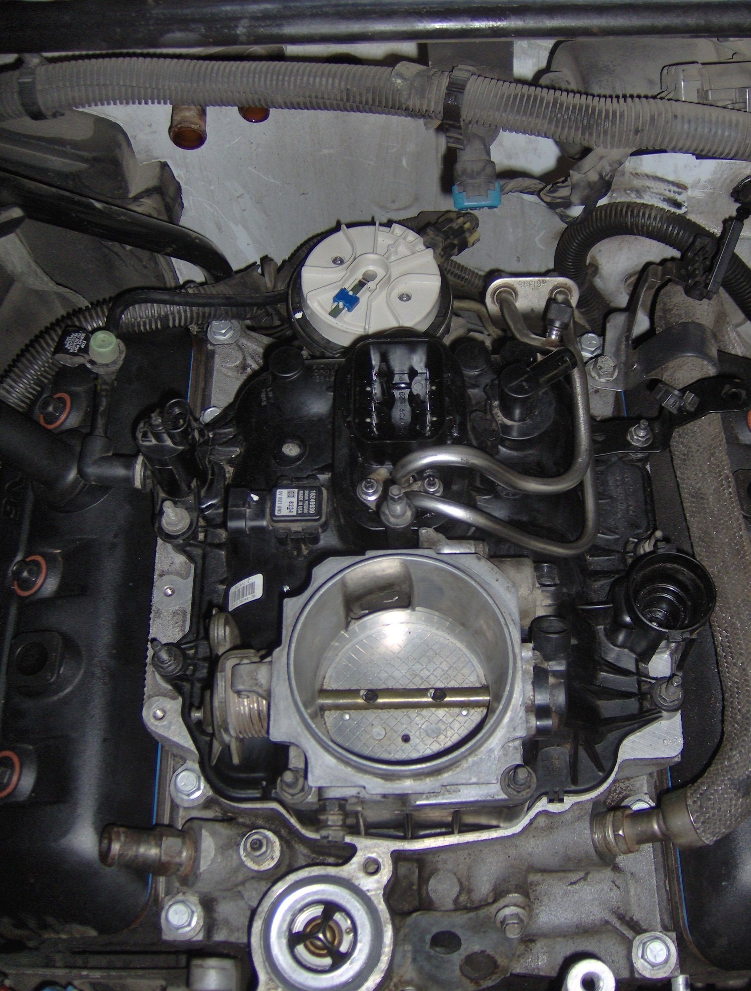

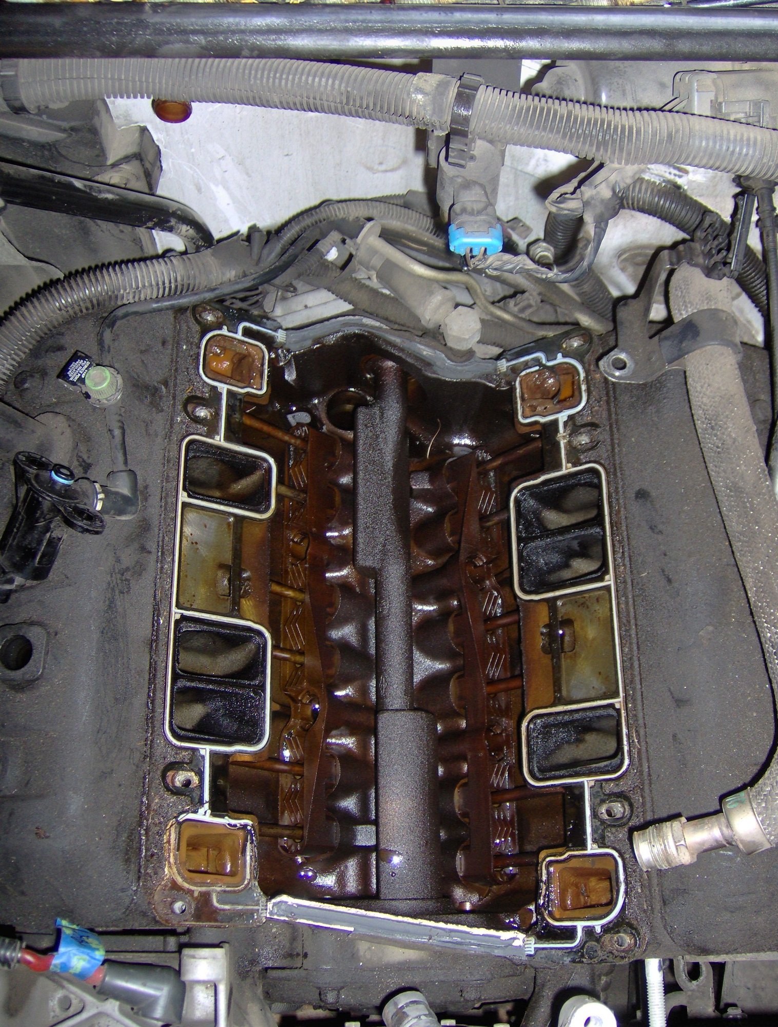

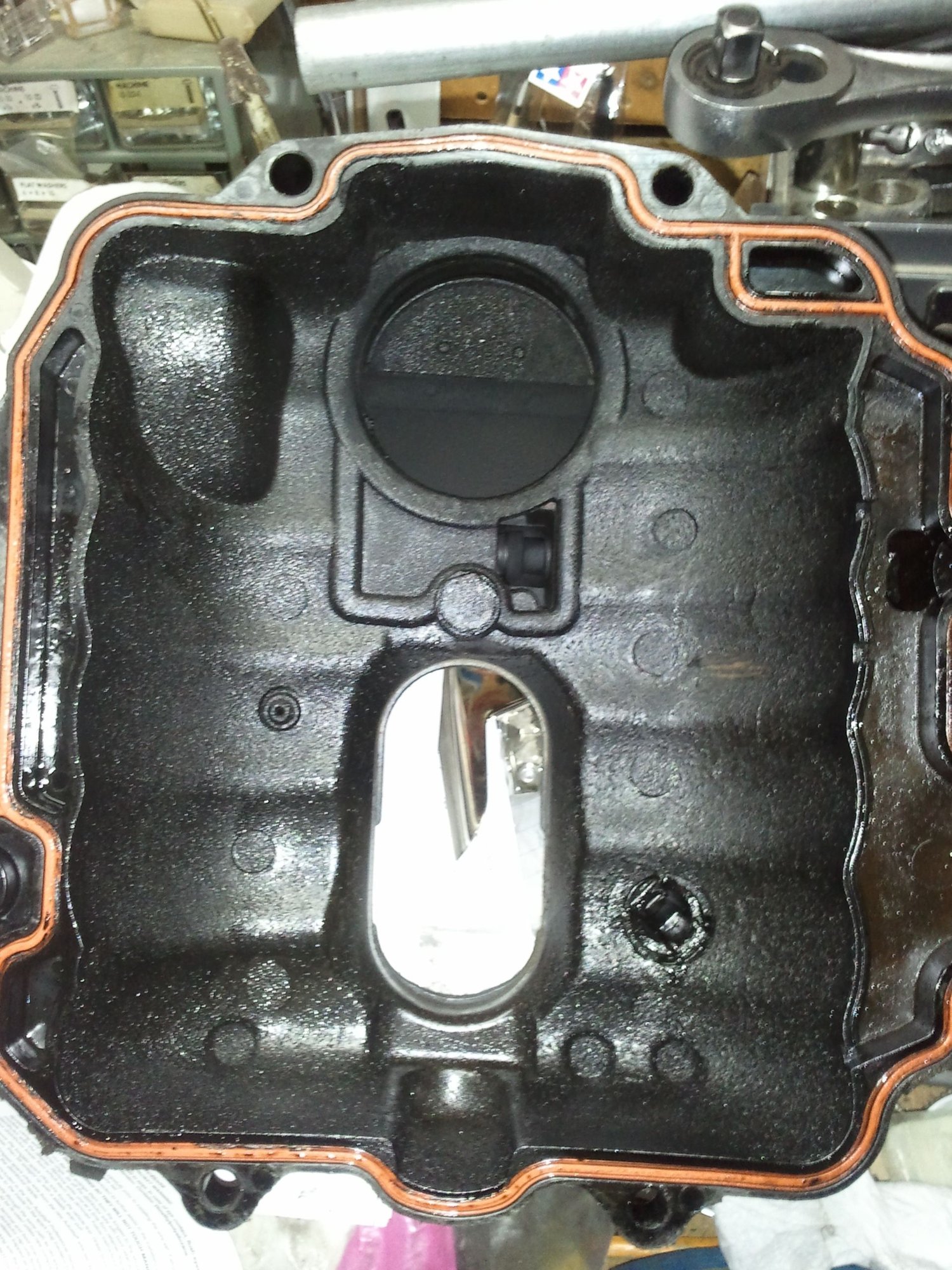

I've included some pics from when I replaced my LIM gaskets so you can see the parts. There are good threads on how to do this repair if you need to do it. When I did it, I took the opportunity to upgrade to the later version of the injectors.
With LIM removed. Coolant flows across the the LIM at the front.

Underside of LIM. The rear of the LIM is to the left and its front end is on the right.

Plenum and throttle body installed.
Underside of plenum. The throttle body opening is at the top which is the front end.

"Only at the front does the water pass through the intake"
Yes, BUT on my 95 4.3Z, the PS rear intake manifold bolt has COOLANT behind it. It leaked coolant when I removed that bolt.
in your first and second pictures, see that LR bolt is not INTO the water jacket, but right BESIDE it...
