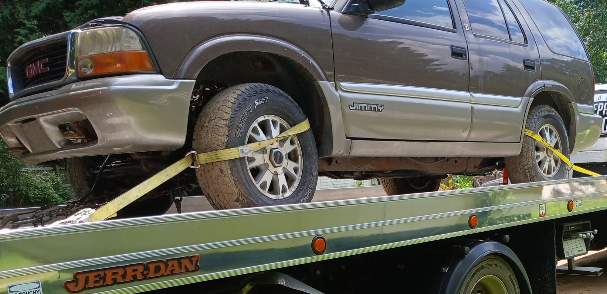

Have a 1999 Chevy Blazer 4x4 which requires a new 4.3. Having acquired an example with 137k, what is the best way to make this unit last? I know they say 4.3s last forever but this one didn't due to issues the previous owner didn't mention. The Blazer has virtually no rust on the body so I have no interest in rushing the job as I want this motor to outlast the vehicle if possible. I have other vehicles and i don't have a time limit. What is the best way to do this? Is it worth putting in new bearings, rings, and resealing the motor? What else goes bad and should be replaced under the hood to help make this a reliable vehicle that lasts? The truck has 110k miles. Thanks also I know it is a gmc jimmy lol i have never called it a jimmy

Nice looking truck.
