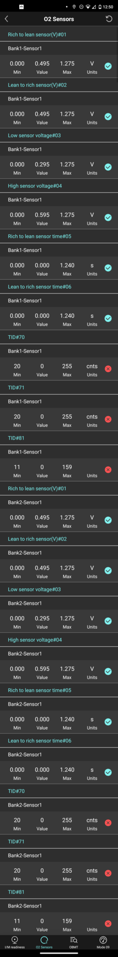

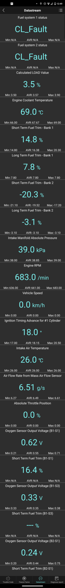

Need help interpreting these. Codes are cul 5 misfire and banks 1 n 2 o2 sensor bad

Those are some funky fuel trims, something definitely going on. We need them at idle and 2500 rpm all in park warm engine
Need all those same sensors on a cold engine at key on.

Here are screenshots og what you asked for. Codes and test with eng cold and key on. Here's a video of how she sounds. Link enclosedhttps://photos.app.goo.gl/1bQC3nckX3FgHuTE7

We need three sets of data all taken at the same time:
engine cold, key on engine off
idle warm in park
2500 rpm warm in park.
Also can you graph the O2 sensors like in post 3?
Lastly we need the MAF sensor at the full throttle shift point on a warm engine.
Can you read CMP retard?
We should look at your #5 plug and at least one next to it after you verify that CMP retard is in spec

Your software has report insufficient O2 sensor counts which means that they may not be switching or not switching soon enough (heaters) hence the graphs.
You get an improper MAF reading at 0 RPM so we need to see it at idle and the shift point
We need CMP retard before we get too carried away focusing on cylinder 5 since that affects the accuracy of the reported misfires.
You have O2 sensor heater codes which means that they will be slow to warm up affecting emissions and fuel economy to a small degree. They may also not be starting fast enough to satisfy the computer. This is usually no problem at speed but at idle the sensors can get cold enough to stop working correctly, and again be slow to start. This can be the heaters in the sensors or the power and ground or wiring to the sensors. We need to fix this eventually. We can either test the circuit or you can swap with a known good O2 sensor to see if the heater code persists.
