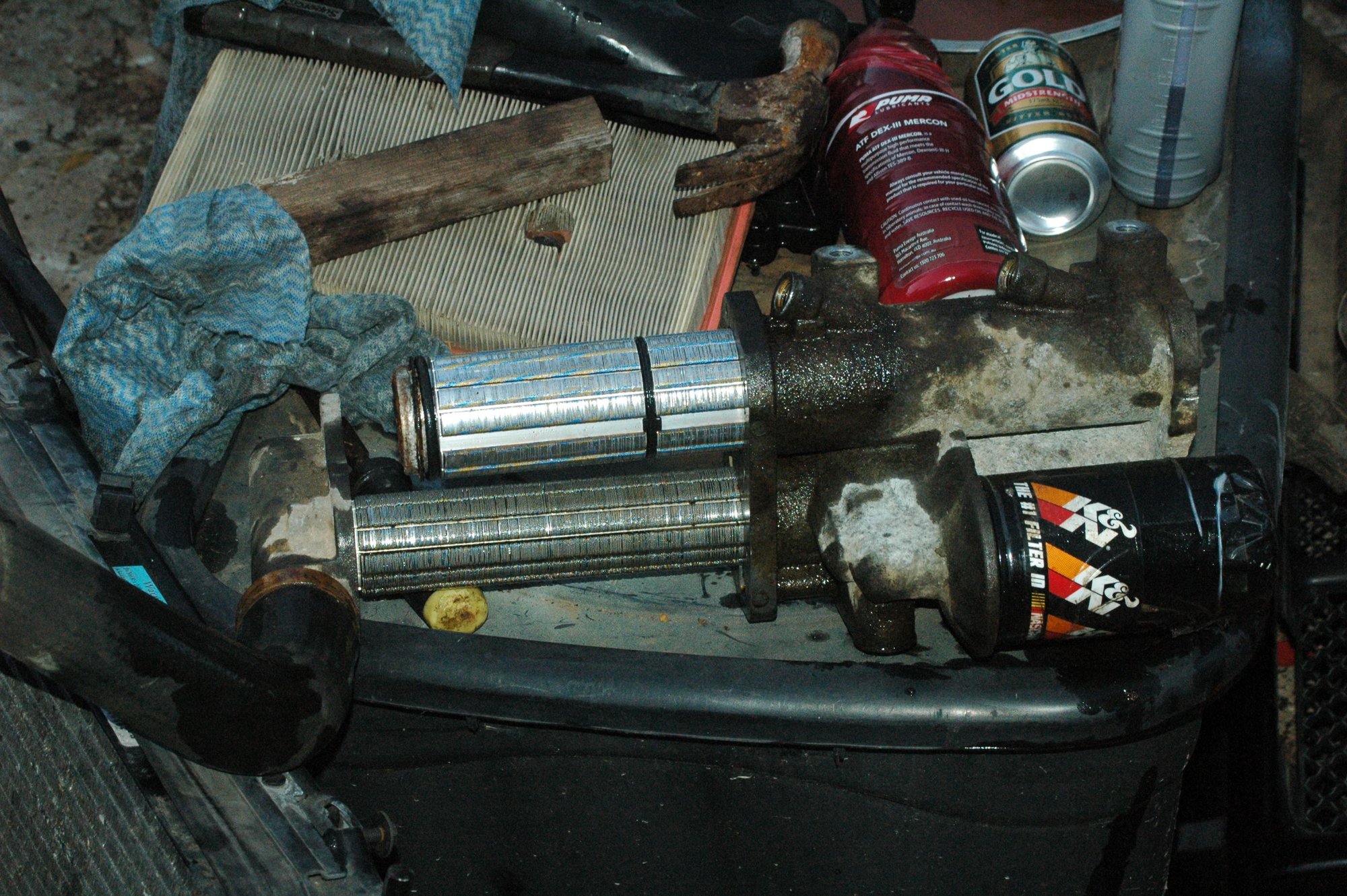

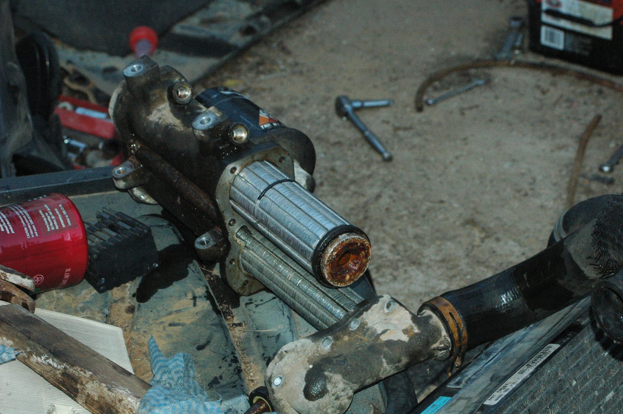

can some one please give me a web address where I can find these inserts please
folks I need to purchase a oil and transmission cooler that fits under the front of a 1999 4.3 lt v6 blazier its right hand drive
mine has a leak in it it only a pin point leak but its leaking from the transmission side in to the water
I live in Australia so would need one priced with shipping

I have a 1999 LT 4dr, 4wd, and I do not recognize that remote oil-filer mount and heat exchanger. On our LHD Blazers, the oil is cooled by an in-tank heat exchanger that is part of our radiators.
Have you looked at RockAuto.com?
If you cannot find the parts, you might have to create your own new oil cooler system using a new dedicated air-cooled radiator mounted in front of your engine radiator.
