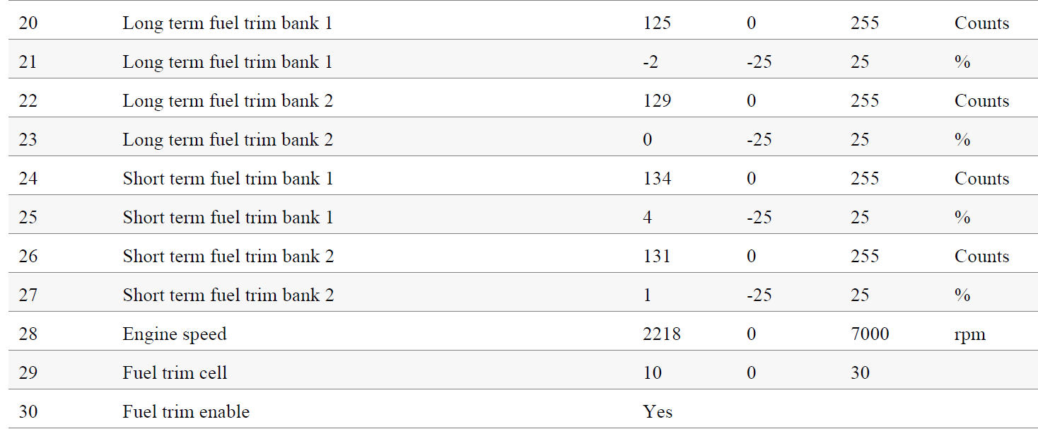

FYI here is the info you wanted

We also need the fuel trims at idle but your 2218 rpm numbers look very good. An engine that cannot rev above 2500 rpms but shows near perfect fuel trims at that rpm is not likely to be having major fuel delivery or air intake problems. So this is either likely:
