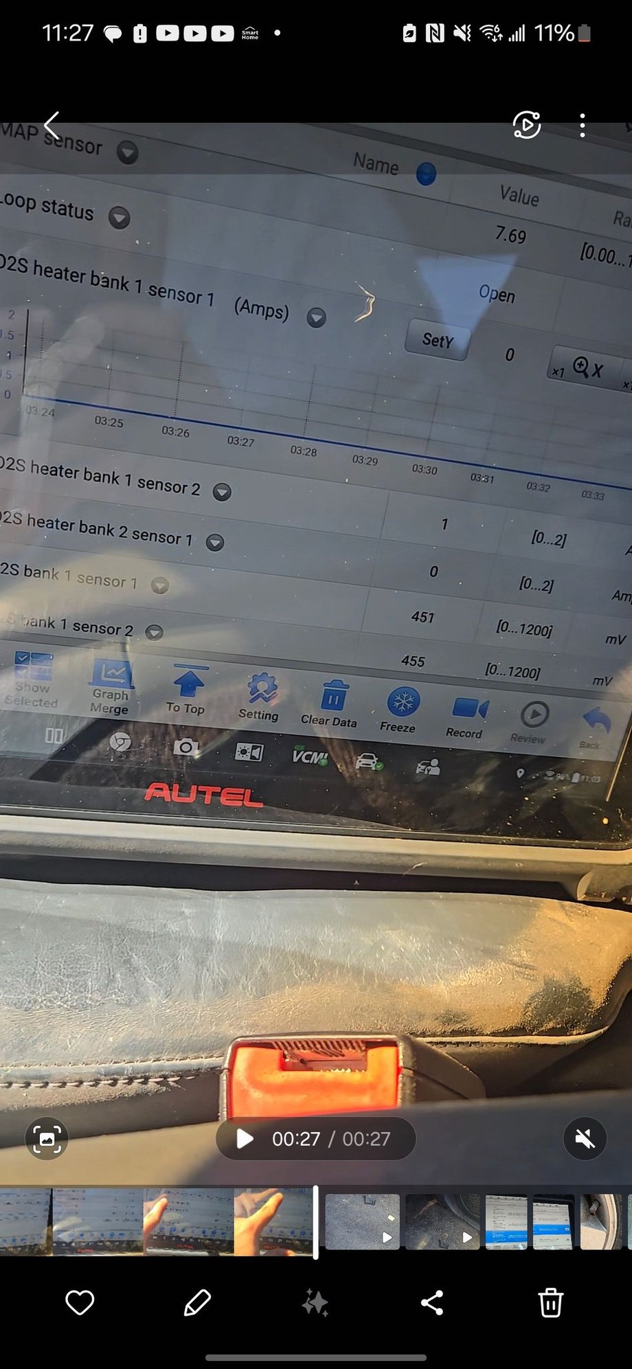

I checked the graphs and they don't look like they are moving at all i don't know how to put a video up on here but I did take one

Take a screen shot even if you just use your phone camera

The graphs for b1s1
The graphs for b1s1
And the volts for b2s1

All graphs need to be in volts (V) or millivolts (mV).

"not changing at all" :
FWIW, in my 95 PCM, the O2S input is opposed by a fixed 0.45 V bias inside the PCM. That might account for " un changing voltage on the O2S input.

A front O2 sensor fixed at 0.45V indicates open loop and not controlling for whatever reason.
