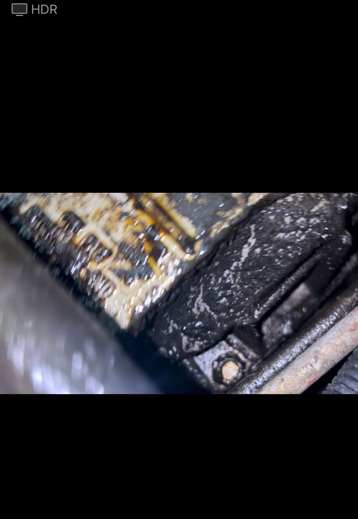

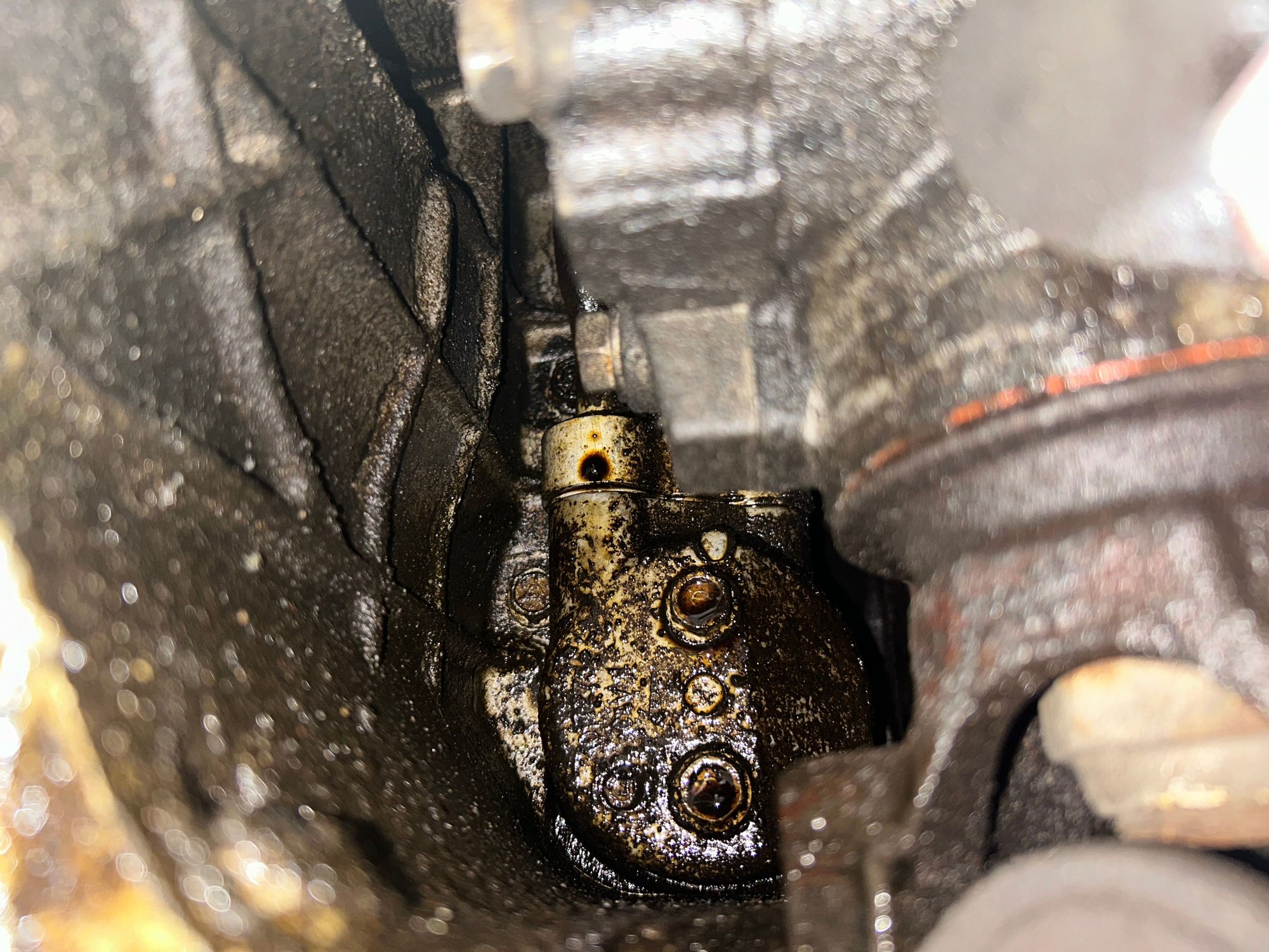

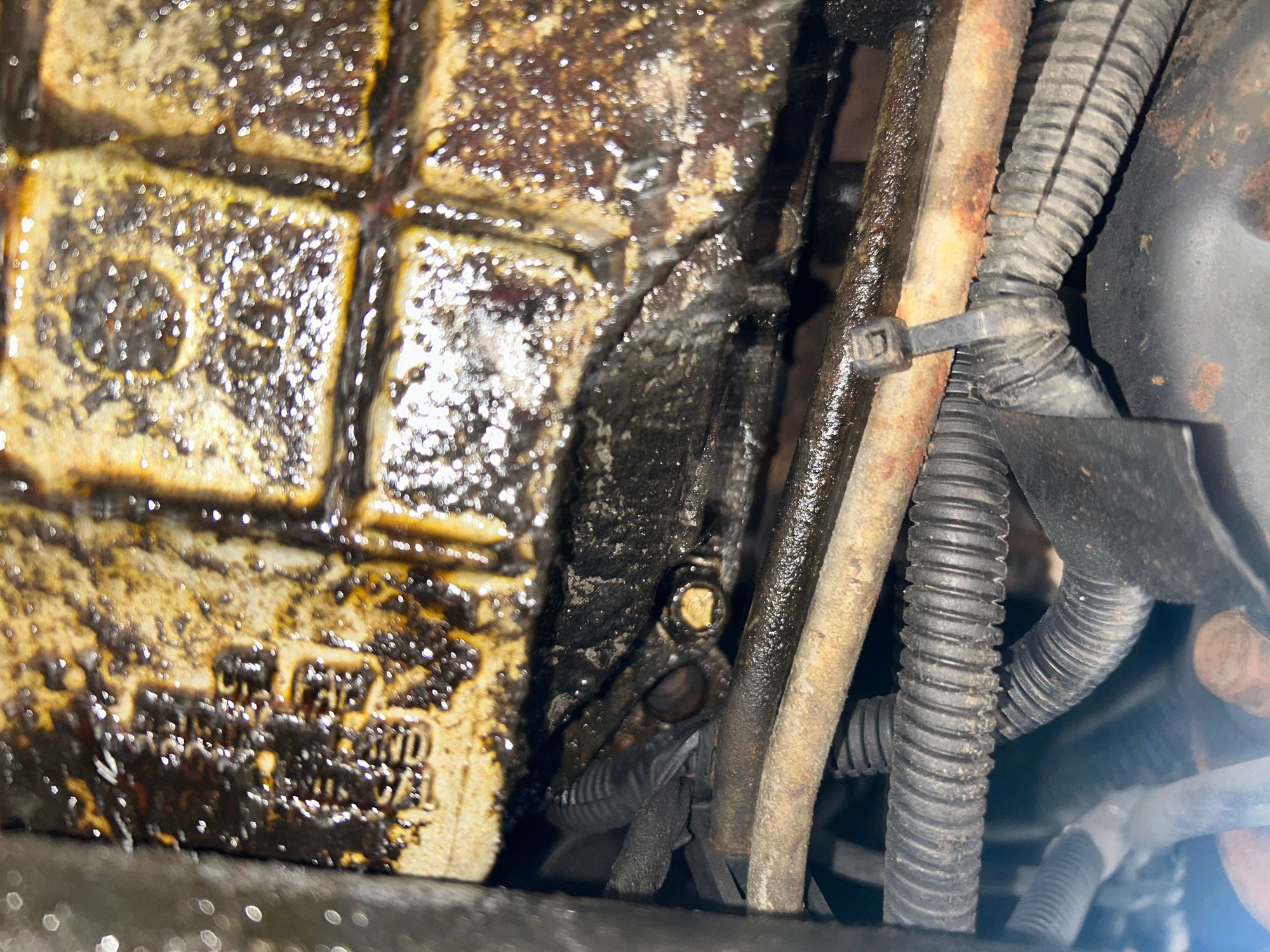

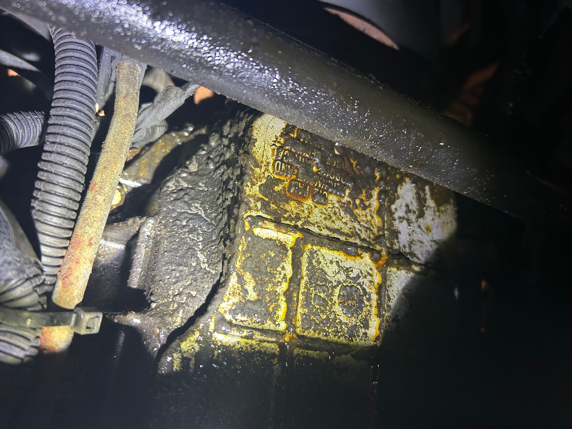

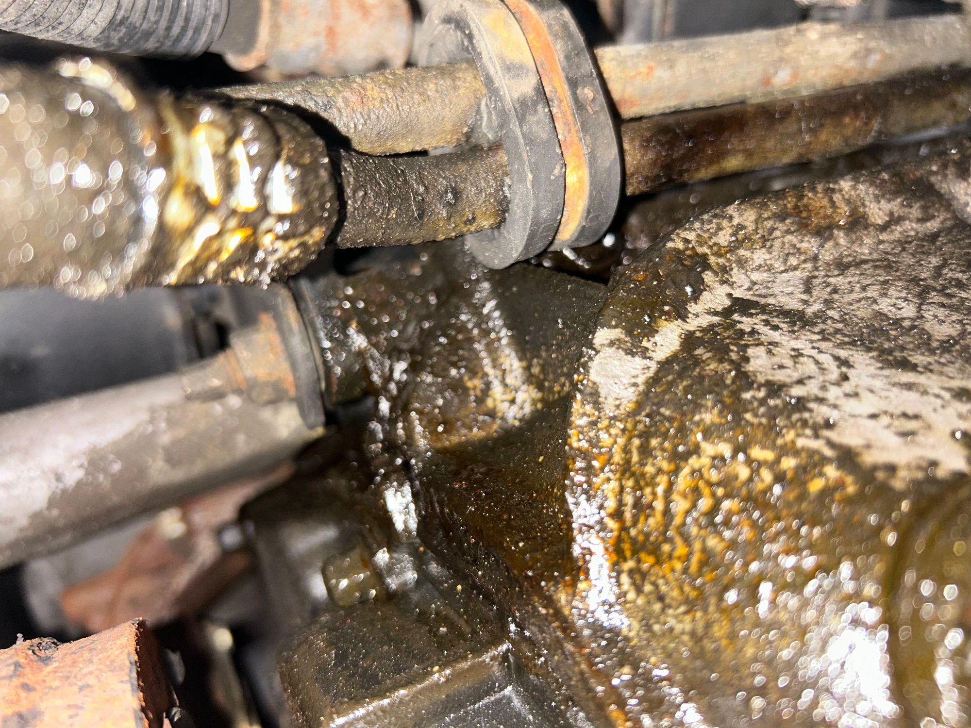

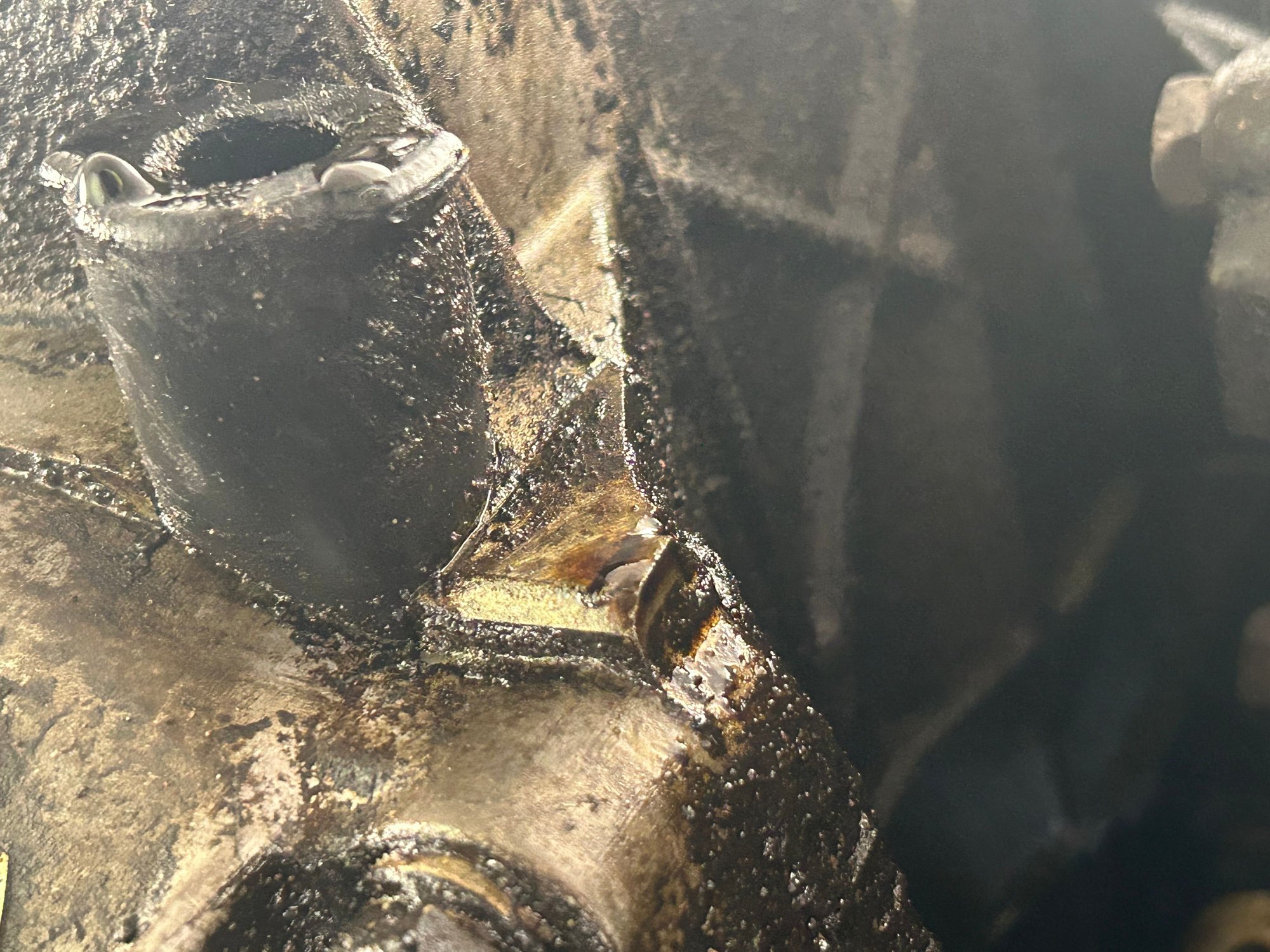

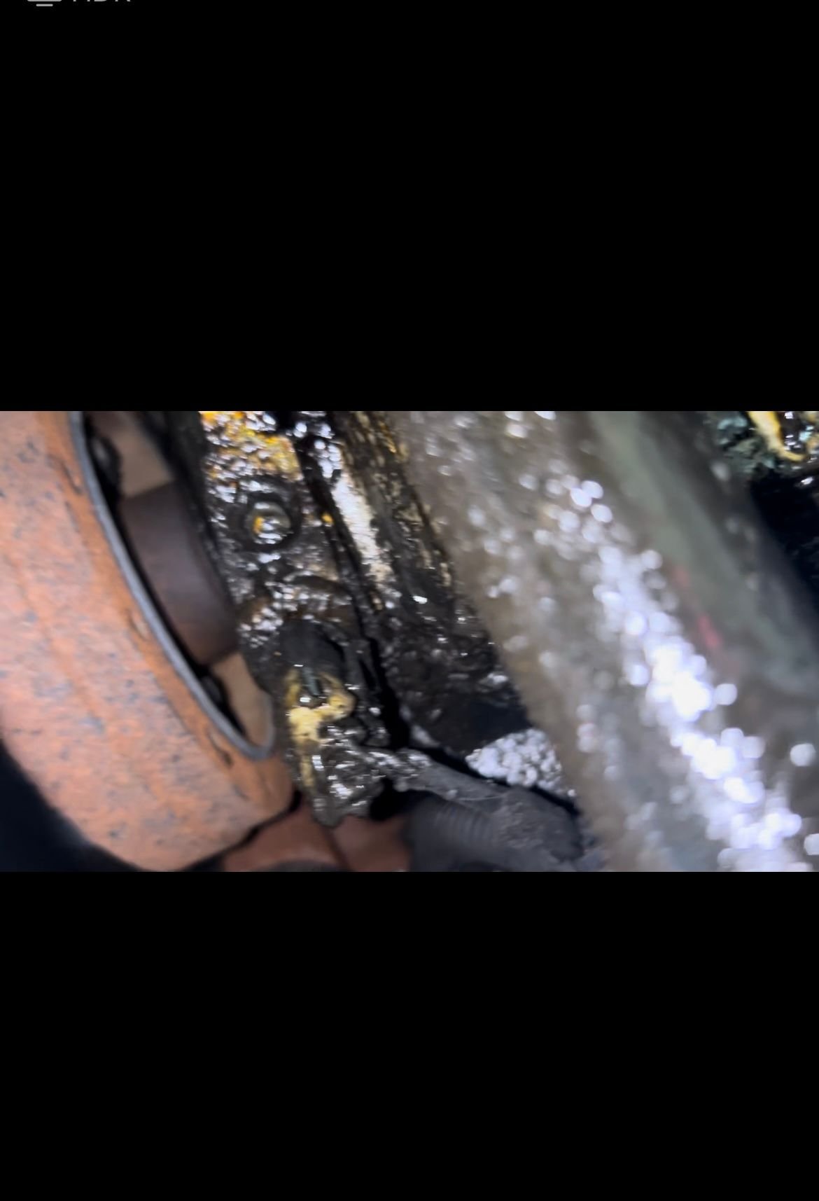

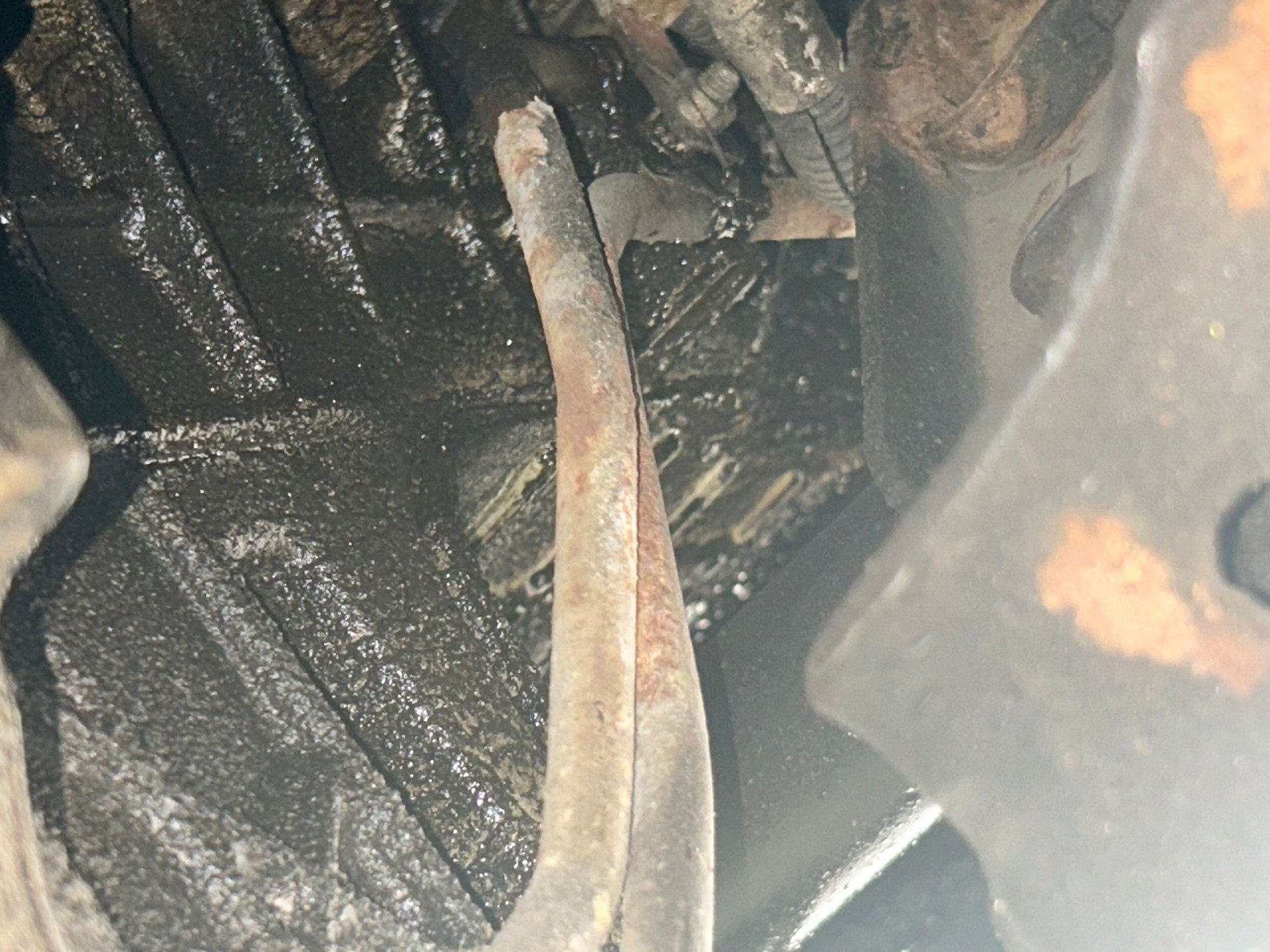

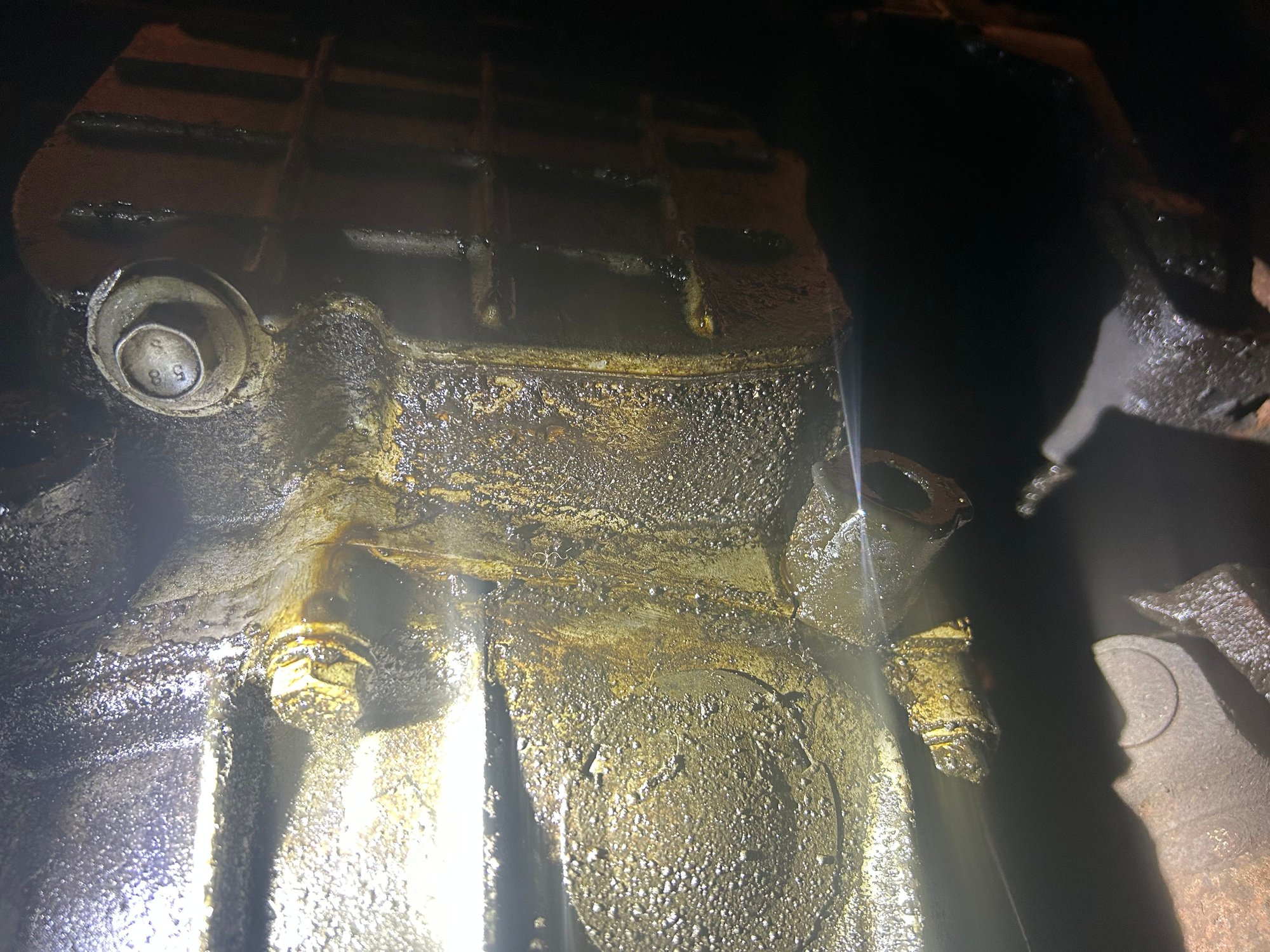

I have replaced the pcv valve and its grommets, tightened valve cover bolts. I do not believe that the valve covers have anything to do with the leak as it is not wet and I also sprayed out the engine bay a few weeks back. The oil leak was usually just a few drops per day however in the past few days the leak has increased significantly. It is now a 6x6 inch puddle after just sitting for 7 hours. Oddly enough my oil level, according to the dipstick, has not dropped significantly (like you’d think it would for the increased leakage). The area is a mess underneath the car. Oil is everywhere around the pan and it is wet. It is dripping off of places around the pan and a few of the lines have oil on them. I think this may be the oil pan gasket; but I’d like to get some opinions before I replace it or pay a mechanic to. Here are some pictures. (Also the thing with the two circles in first picture seems to be wettest)
Thing with two circles was sprayed yesterday. Now has fresh oil.
This seems to be wettest part.

the cleaner parts are indicative of the leak. The oil washes away the dirt.
I agree with Christine on starting to look into the oil line adapter below the block.
If not damaged the Blazer oil pans are not known to leak.

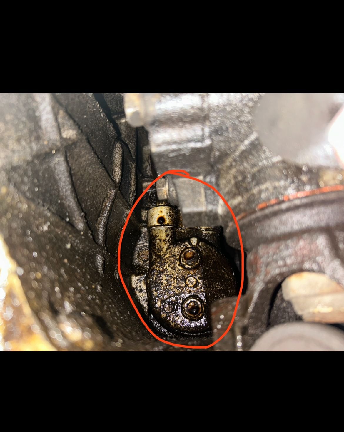

Does anyone know what this part circled in red is? After cleaning all of the other parts the drip is now only coming mostly from this part. Looks like a line is running into it above the drip.
It looks like part 437 or 407 here:
https:/nemigaparts.com/cat_spares/epc/chevrolet/54s-t/00/tx00-046/
These would be the adapters for the remote oil cooler lines or remote oil filter lines (which also can have oil coing), respectively.
The o-ring on the adapter on my 92 4wd broke causing a good sized leak. When I replaced my remote cooling lines, I also replaced the o-ring and gasket at the adapter.
Thanks Christine,
I’ll have to get it up on my ramps again to check how much oil is there again, but, I will probably be replacing these… When its warmer, of course.
