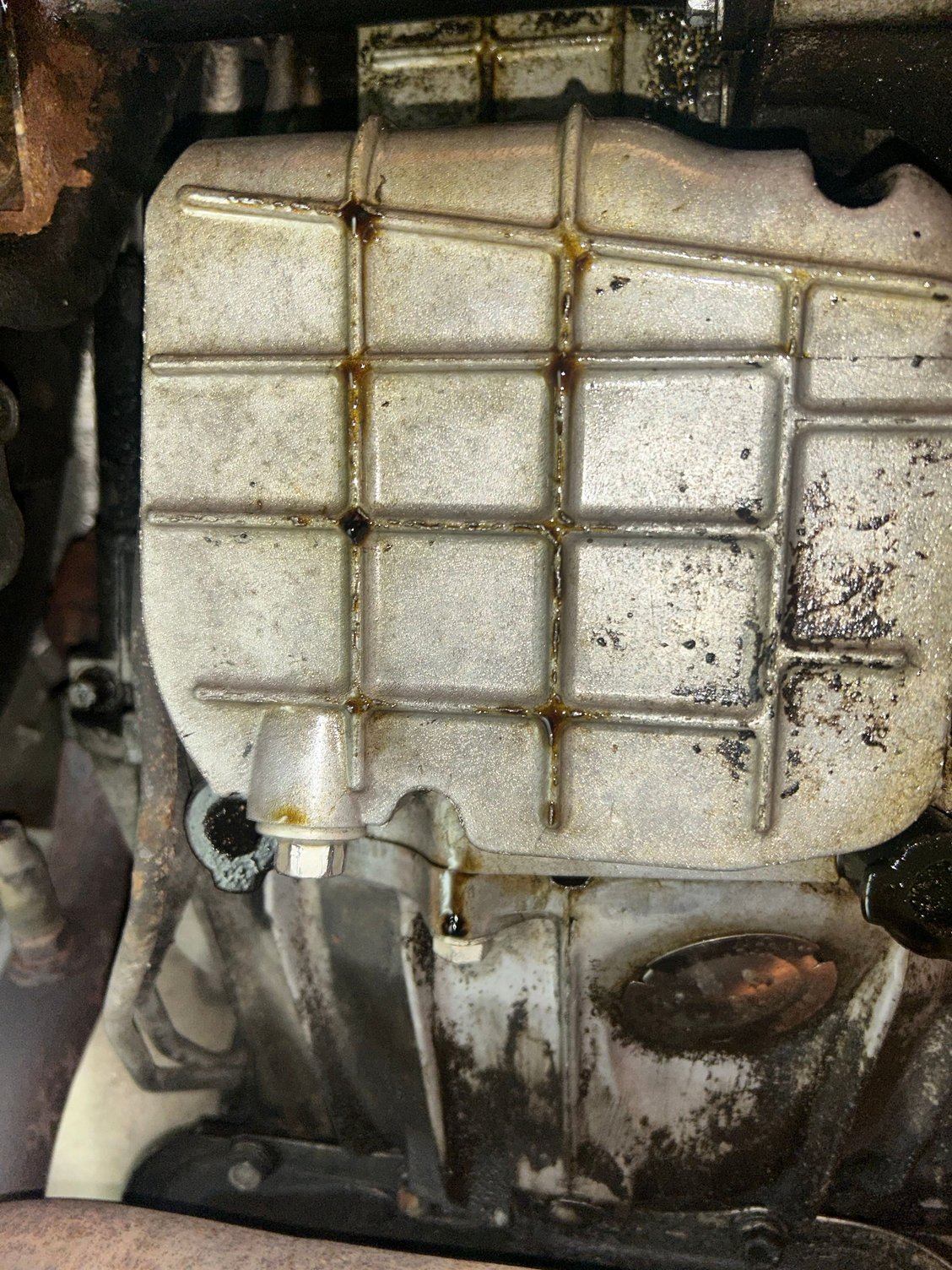

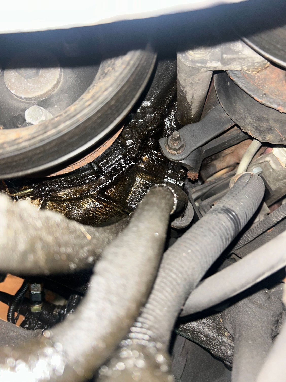

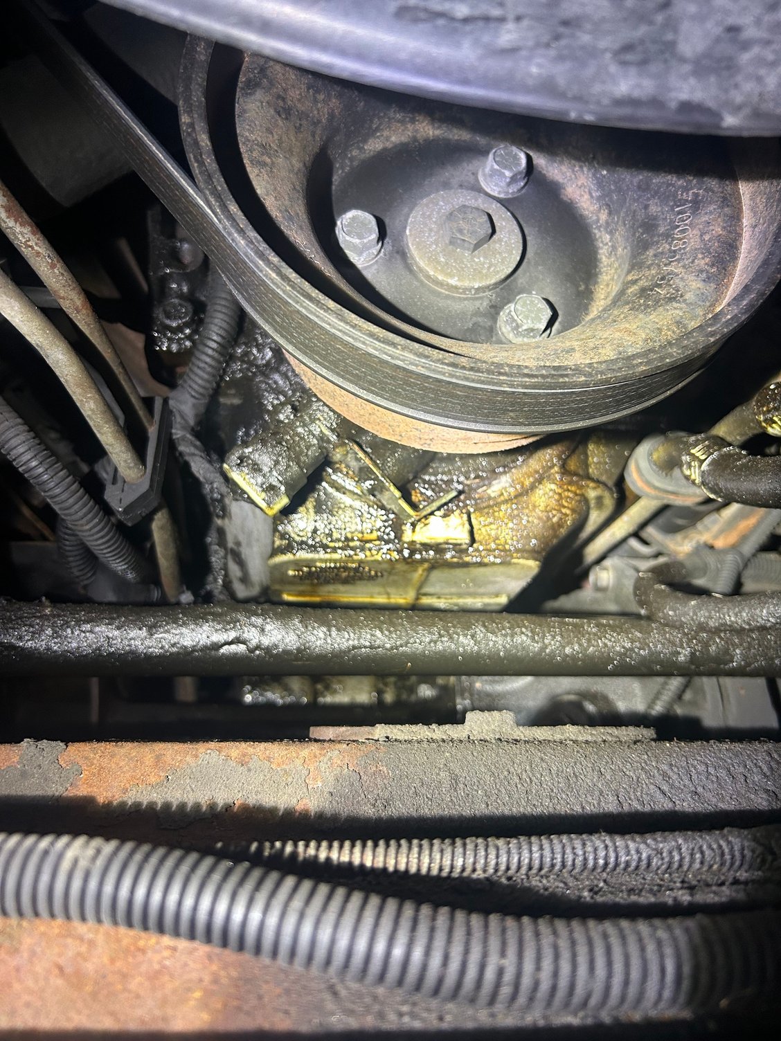

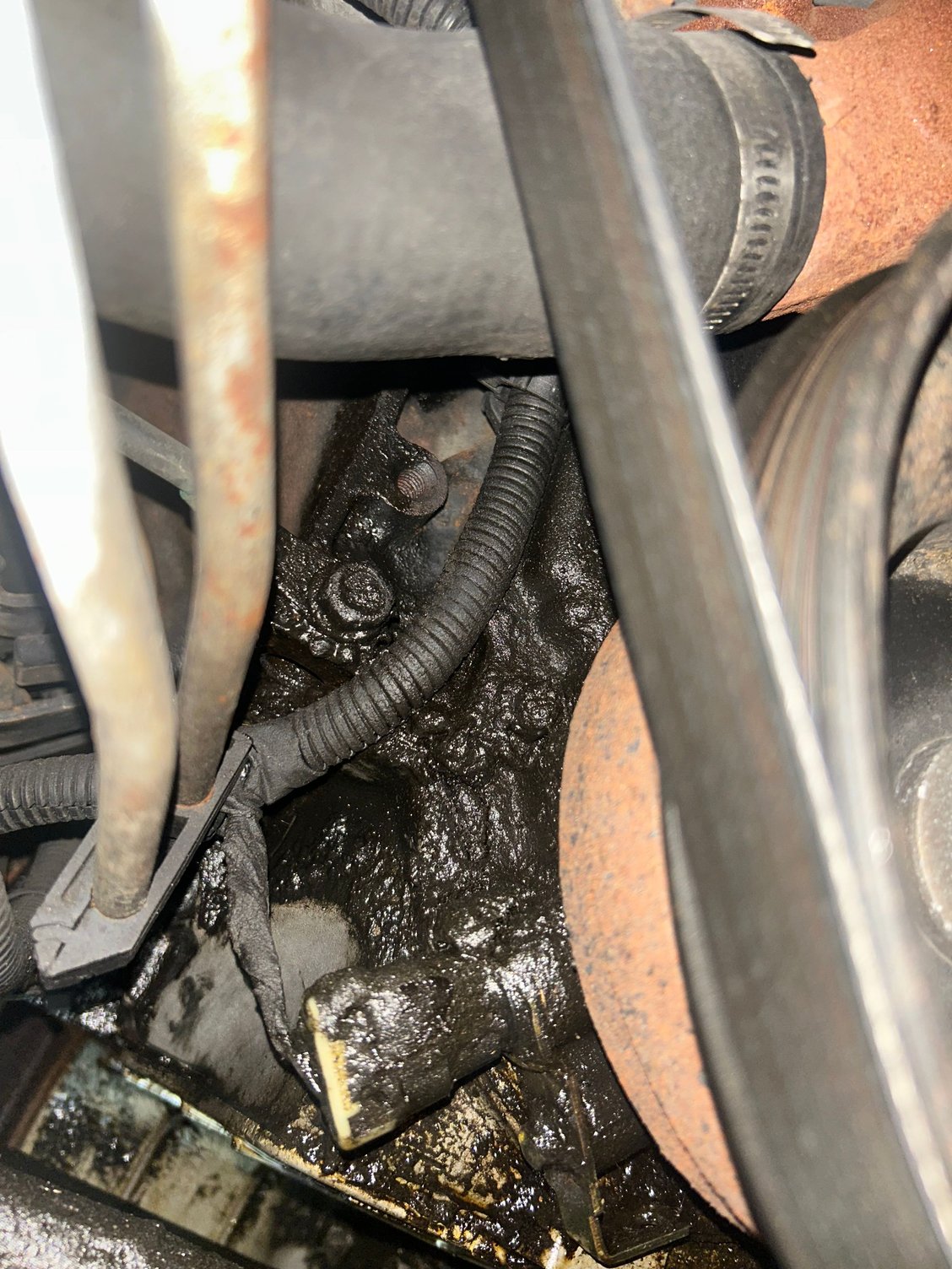

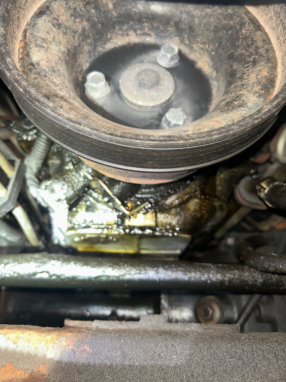

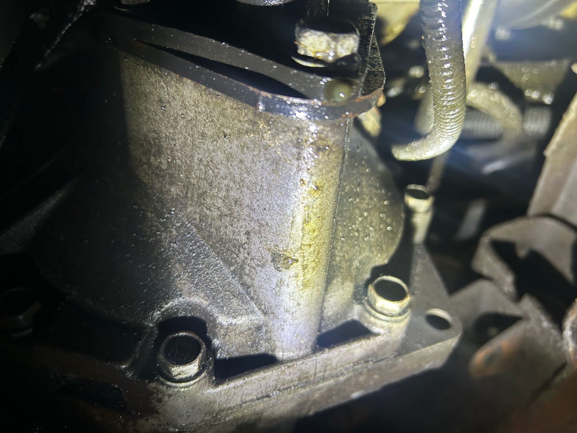

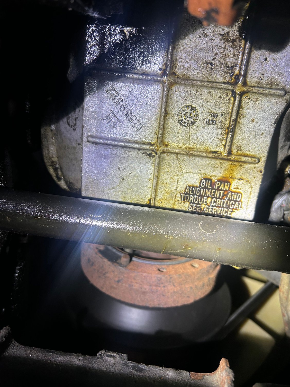

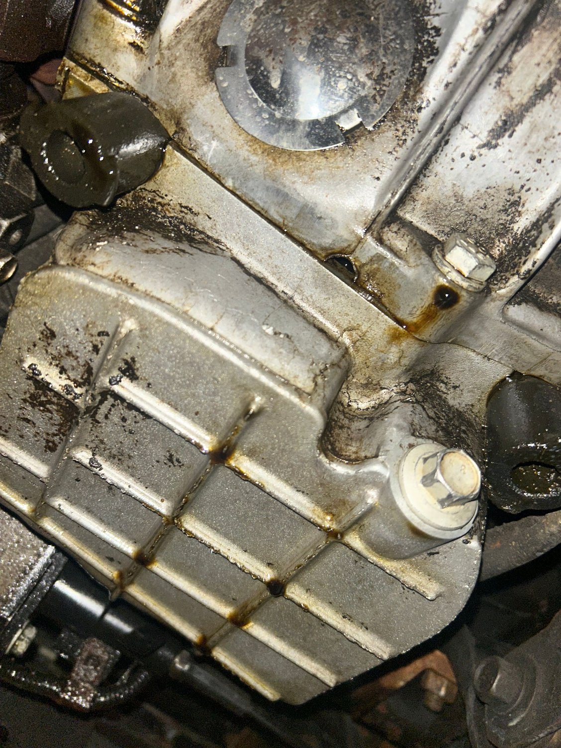

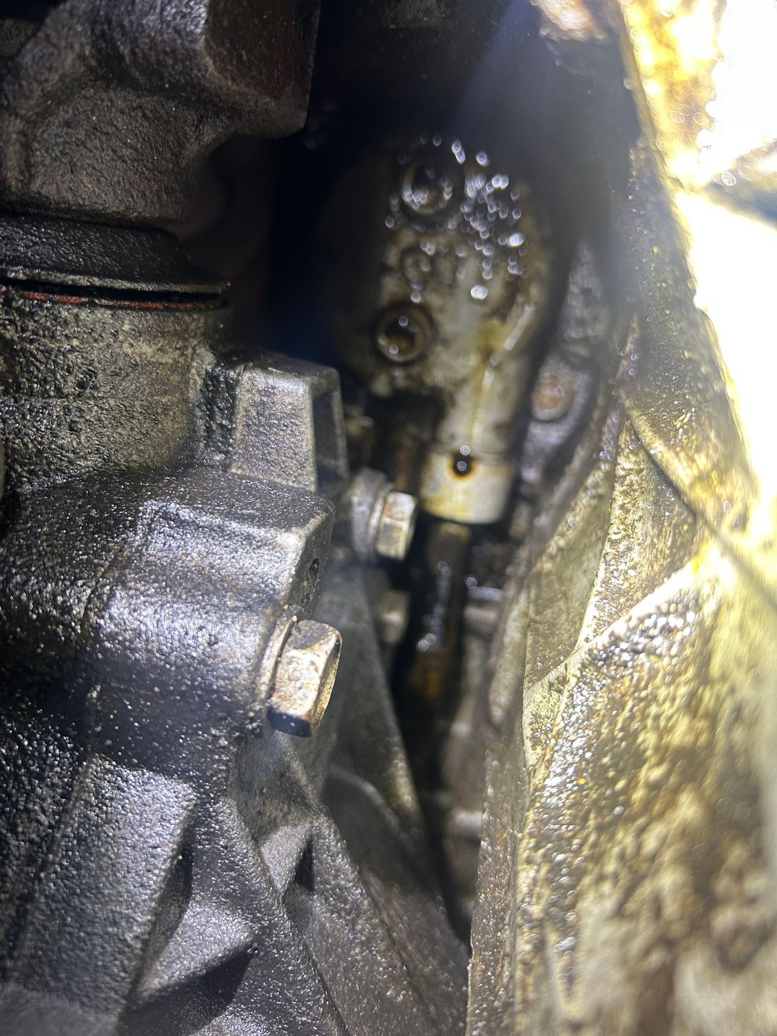

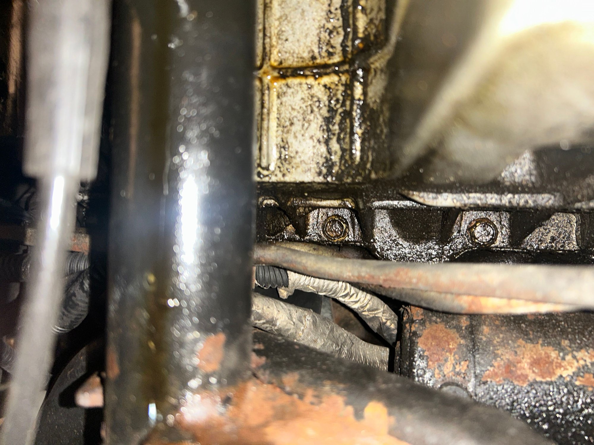

Here are some pictures from today:
For reference, this is what the driveway spot looks like.
Front of motor
Front of motor
Front driver side of motor
Oil pan from bottom
Oil pan from bottom
Oil pan/tranny from behind
Front passenger side of motor
Oil pan
Oil pan
Front half of pan from underneath
Remote line adapter
Remote line adapter
Another shot of front of the engine.
Front diff
Front diff
From what I can see, the wet oil does not go more than halfway up the timing chain cover, I do not suspect the timing cover itself is leaking.
I know a lot of you will recommend Oil lines, yes, they are seeping however they are definitely not the main source of this leak.
Notes:
-Most of the oil seems to run to the bottom section of the oil pan and drip from there. Some also drips from the front differential.
-It was most gunky near the front main seal area. The crankshaft sensor and surrounding were very gunked up.
-Most oil seems to be coming from the front area and making its way back, it seems worse on the drivers side rather than passenger side.
-The leak does not waste much oil. Even though it looks worse, it does not leak much, and the dipstick is still above the hashmarks, oil has not been added since oil change in august.
What are your guys thoughts besides the oil cooler lines based on your experiences and knowledge. And should I just attempt to add another bottle of AT205.

Green oil under the UV light has shown on the oil cooler adapter, both sets of oil lines ( Filter to adapter and radiator to filter lines), and for some reason the front of the intake manifold gasket is also leaking. Also green on the bellhousing bolts but I am not sure if that is just oil running down from the adapter or a rear main.
Old Jan 10, 2026 | 10:17 PM
Have you replaced the remote oil cooler lines? These are notorious for leaking. I also replaced the o-ring and gasket at the oil cooler lines to engine block adapter.
Old Jan 10, 2026 | 10:20 PM
braden737's Avatar
Joined: May 2024
Posts: 130
From: Waterloo, Iowa
I’ve got a pair of cooler lines and the o ring sitting on my shelf that I haven’t gotten to yet. I figured those were leaking, but I wanted to find out what was leaking on the front of the engine, I guess I found my issue here
Old Jan 11, 2026 | 12:14 PM
When you say you have an oring, is that for the adapter? I'm pretty sure there is also a gasket in addition to the o-ring to seal the adapter to the block.
Old Jan 11, 2026 | 04:14 PM
braden737's Avatar
Joined: May 2024
Posts: 130
It’s just the O-ring that I have. I’ll have to look for the gasket for the adapter itself, I was unaware there was a gasket there aswell, I’ll have to look at finding one too
