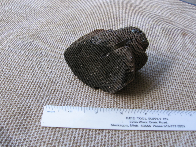

Latest developments: I finally decided to replace the "Y pipe-pre cat-catalytic" assembly to find the rattling noise. Here is a picture of what I found inside the Pre-Cat. No wonder it was rattling!! I still wonder why it quieted down when warm. Needless to say, the rattling stopped. I drove a short distance. Noticed a lot of pickup and it seemed to run fine. No Service Engine Light. However, when I plugged my Actron Code Reader in, there was the dreaded P0300 "pending" code. The last advice given was to check the spark plug wires & distributor at night with some water misted over them. I will do that tonight. I just bought the 14 year old beast so I don't know if the distributor cap & wires are Delco or not.
(The last time I tried to attach a photo on another Thread, it was very small, so someone please tell me how to resize.) Maybe, just click on it and it will increase in size?
