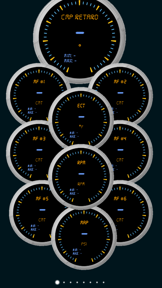

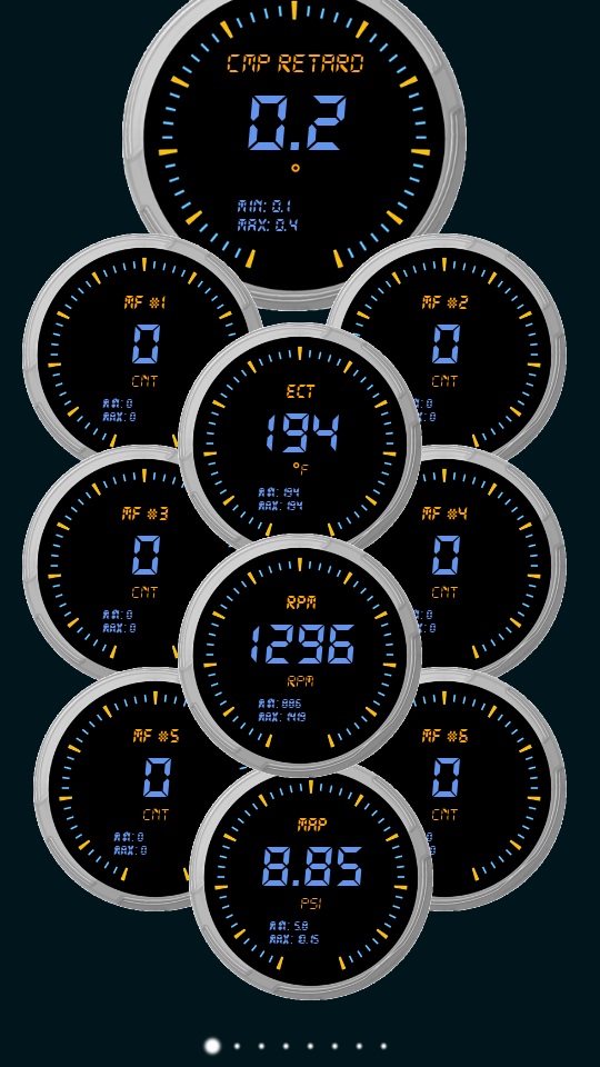

Good choice, the ability to read CMP retard will help a lot! Let us know when you get it. It doesn't sound like your misfire is very severe, so I think that is a good sign that setting the CMP retard might just fix your P0300 problem. Still we will need to check the distributor gear for wear and other things, especially if the CMP retard is off significantly.
Use the CMP Retard with the single asterick after scanning the PIDs for your vehicle under Powertrain. You can save the scan to a file so you don't have to scan them each time, and so that all the Powertrain PIDs can appear when not connected to the vehicle (useful for building custom gauge screens). Here is one custom gauge screen that I have. CMP Retard, a misfire counter for each cylinder, coolant temp, rpm, & MAP sensor as digital gauges. I wish the digital gauges were smaller and not round with just only the digits and label so they are easier to place on the screen, but that's the way they are in Car Gauge Pro. Still useful to watch them all at once. Note that 20 scans/sec with 10 gauges on a screen will give you a refresh of 2 times/sec on all things including the misfire counters (so they can seem a bit jerky if counting up rapidly and cycling back to zero) . If you want things faster, you need to reduce the number of things monitored, or increase your refresh rate. OBDLINKMX bluetooth will get you 30/sec but think that will not be very noticeable. The pricier Windows software with USB OBD2 adapters are in excess of 100/sec if I remember correctly (light speed in comparison), but I find them much less convenient to use (I only drag them out when I need them).
