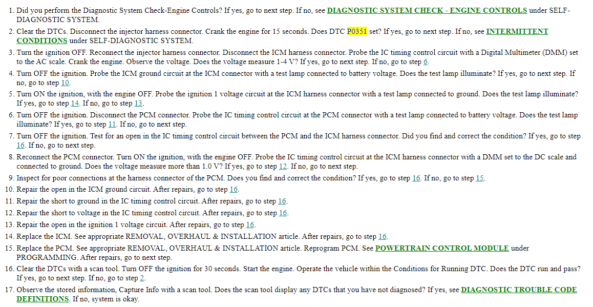

Whenever you get a code like P0351 it means the system (ignition in this case) has a problem and the system components are just one possibility. In older vehicles especially, there can also be power, ground, or signal wiring problems. The ECM is a possibility but everything else should be ruled out first. P0300 has many possible causes and it can take a while to get to the bottom of that code. Lets start with P0351. One thing you can check are cylinder misfires to see if its really random and how extreme.
Why did you replace the distributor? Did you ever have the P0351 code before the replacement? Is there any carbon arching under the distr cap? What about plugs and wires, were they replaced as well? What brands were used? It is possible for a P0135 code to get set when there is a secondary voltage problem so the distr, wires and plugs need to be in good shape with no timing problems.. Do you have scanning capability that can read CMP retard so we can check your distr registration? Mist the ignition system under the hood in the dark with water to see if you have any arching.
If the secondary side pans out then on to the low voltage ignition system. Here is the factory diagnostic flow, I will be happy to help you with this. The first and easiest thing to check is the quality of the 12v feeds on the pink wires to the coil and ICM and the quality of the ground to the ICM. Inspect all wires and connectors for breaks, shorts, corrosion, bent pins, etc.:

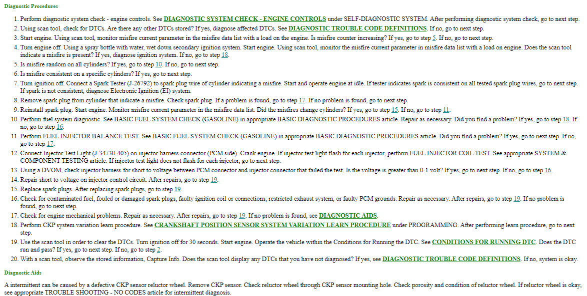

Since you have decided on P0300 first:
