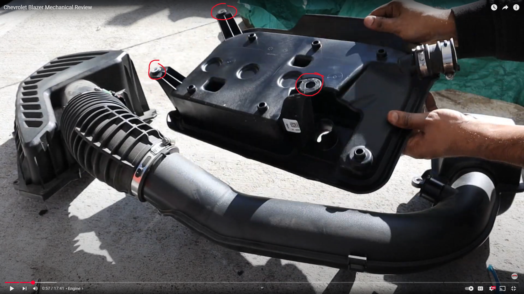

I have never been under the hood of these newer Blazers yet so I can't speak from direct experience, but I would look at the recess to see if there is a fastener in there. If there is, remove the fastener and see how the cover moves. If there isn't a removable fastener there, you might just have to give it a tug to free the push in style rubber retainers that are typical on many engine covers. Before tugging though, give it a thorough inspection to see where it might be attached so you have an idea of where to apply force.
*Edit* - Well, I went looking to see if I could find some other pictures of the engine cover and it would appear as though the engine cover is more than it seems... It is also the air cleaner outlet resonator so it is coupled into the air intake system as well. That hose clamp onto the air intake pipe would need to be loosened and disconnected from the main air intake pipe to remove the cover. Just be careful not to drop anything into the open hole in the air intake pipe when the cover is off.
*Edit 2* - The video link below shows this cover, but doesn't go into specifics of how to remove it. I'll take some screenshots from the video to identify the fastener locations.

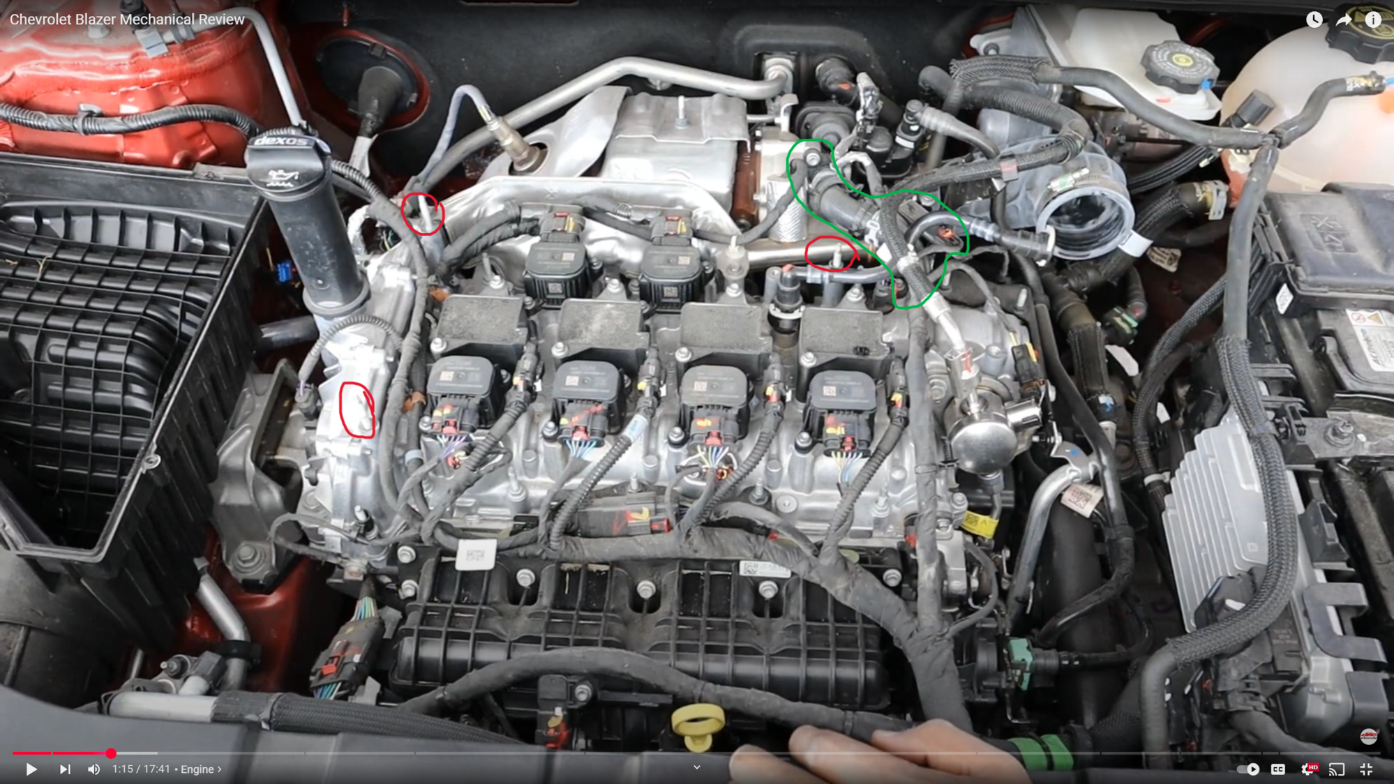

Red circles are the three mount points that will have a nut you will need to remove. 2nd picture shows the location of the studs on the top of the motor that the nuts will thread onto. Green outline shows the tube/sensor we are looking for.
