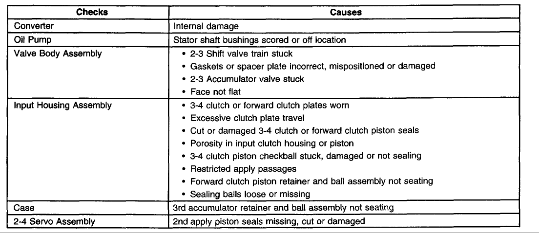

Could be anything listed in the image below:
There really is no way to tell without getting in there and figuring out the cause. And to speculate on costs... I am sorry, but to go through each one of those scenarios above and try to determine the cost of repair... Unless a professional transmission builder pops on and gives you his experienced opinion, we would just be guessing.
