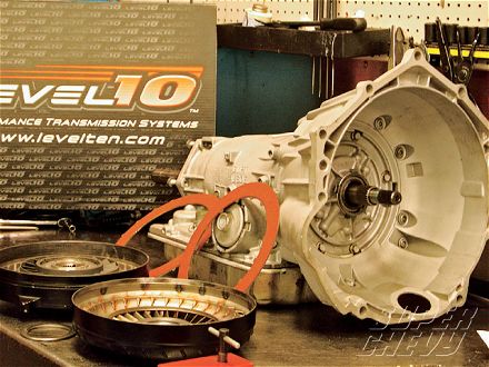

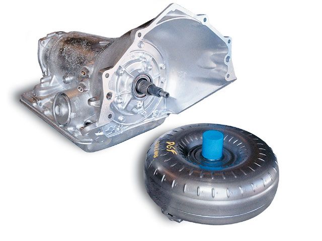

I hope these pics help. As you can see the end of the input shafts are different. I had to change the bell and tail housings. The PRNDL switch is different and I had to change that too.

The old trans has a 1TAD sticker on it and the new one has a 4KCD sticker on it.

Your 2001 should have the removable bell housing on it (2pc case) not the single piece case like the picture shown... GM changed to the 2pc case w/ removable bell housing in the 96-97 time frame according to my ASTG manual.
So long as the 2004 trans is a 4L60E, you should be able to use it, but if there is that much different, it may be the 4L65E.

I got the picture from the net to shown the differences in the input shaft. Both have bolt on bell housings. They are both supposed to be 4L60-E's. The trans from the 2004 1500 truck has a bigger torque converter and a different input shaft. I switched out the bell housings, that did not help. There is not enough clearance to bolt the torque converter to the flywheel.
