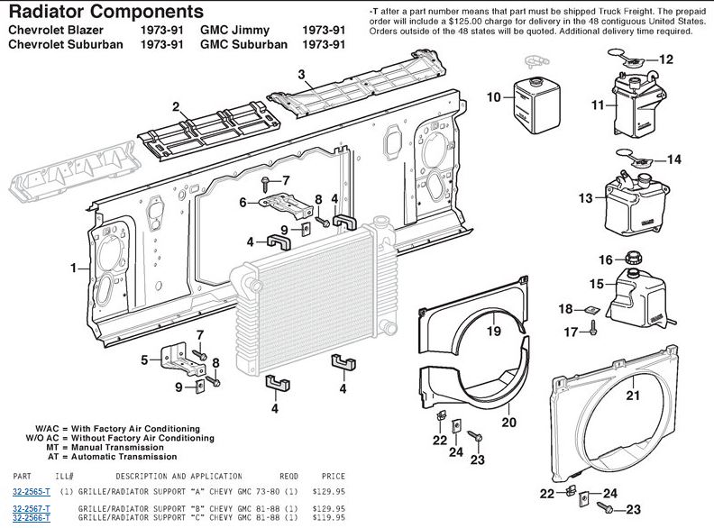

I have been working on putting the front end together on a 1980 k5 blazer. The truck came with the front end disassembled and it was missing multiple parts so I am not sure which pieces I am missing until I try and put that component in. I installed the front clip and set the radiator on the rubber mounts that go underneath it but I am not sure how the top of the radiator gets fastened in. Does anyone have any photos of theirs installed or can possible tell me what part is needed? I looked at the parts available on LMCtruck.com and it seems like I only need the panel shown in the diagram I've attached labeled "2" because none of the other parts are spec'd out for a 1980. If someone can verify this that would be amazing. Thanks!

#4, 6, 7, 8, & 9 hold the upper part of the radiator in place.
Any idea if they are different for the 80'? Those parts on lmcttucks website say they are only for 81-91. Anywhere else you can recommend buying them from?
