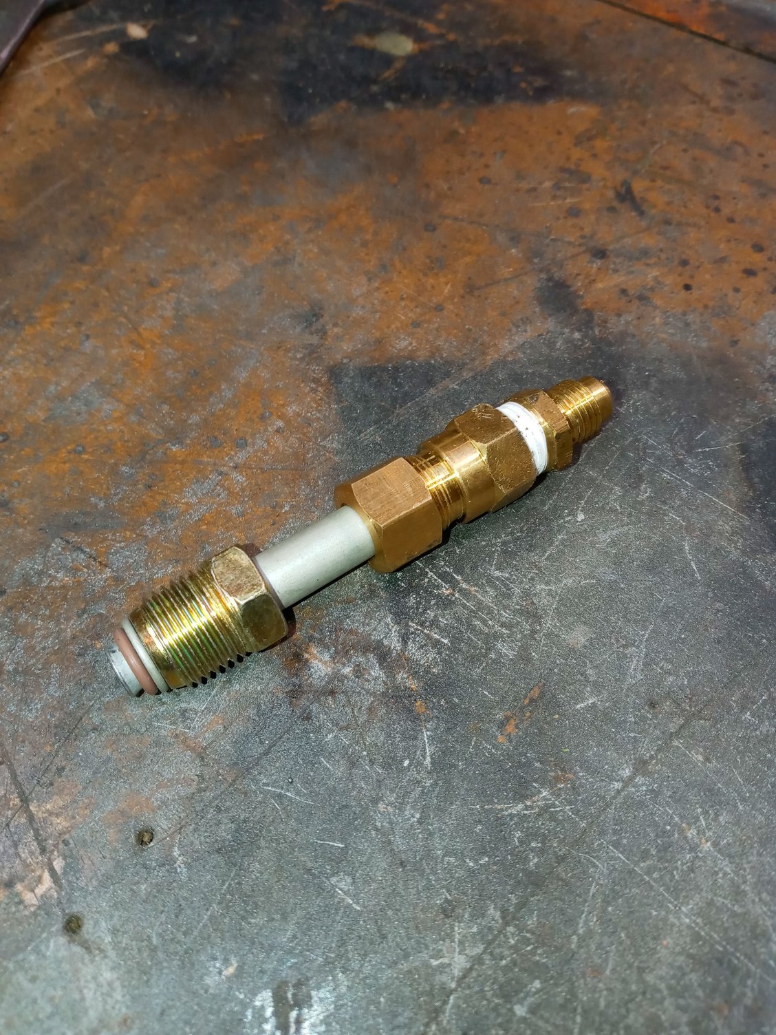

I read this... and I get it what it's doing.. but what are the two brass fittings for? are they to convert that fuel line fitting into something I can screw my fuel pressure gauge on to?

Never mind.. I scanned past the explanation before.. found this further down..
The 800-170 connects to the fuel filter outlet. The LFA116 connects to the 800-170. The LFA80 connects to the LFA116. The fuel pressure tester connects to the LFA80.

finally got my fuel pressure adapter made up. Just about to hook it up and confirm my reman spider is junk...
Edit: fuel pump makes 85psi. Initially leak down looks like it will be above 55psi in 10 min...will update then.
