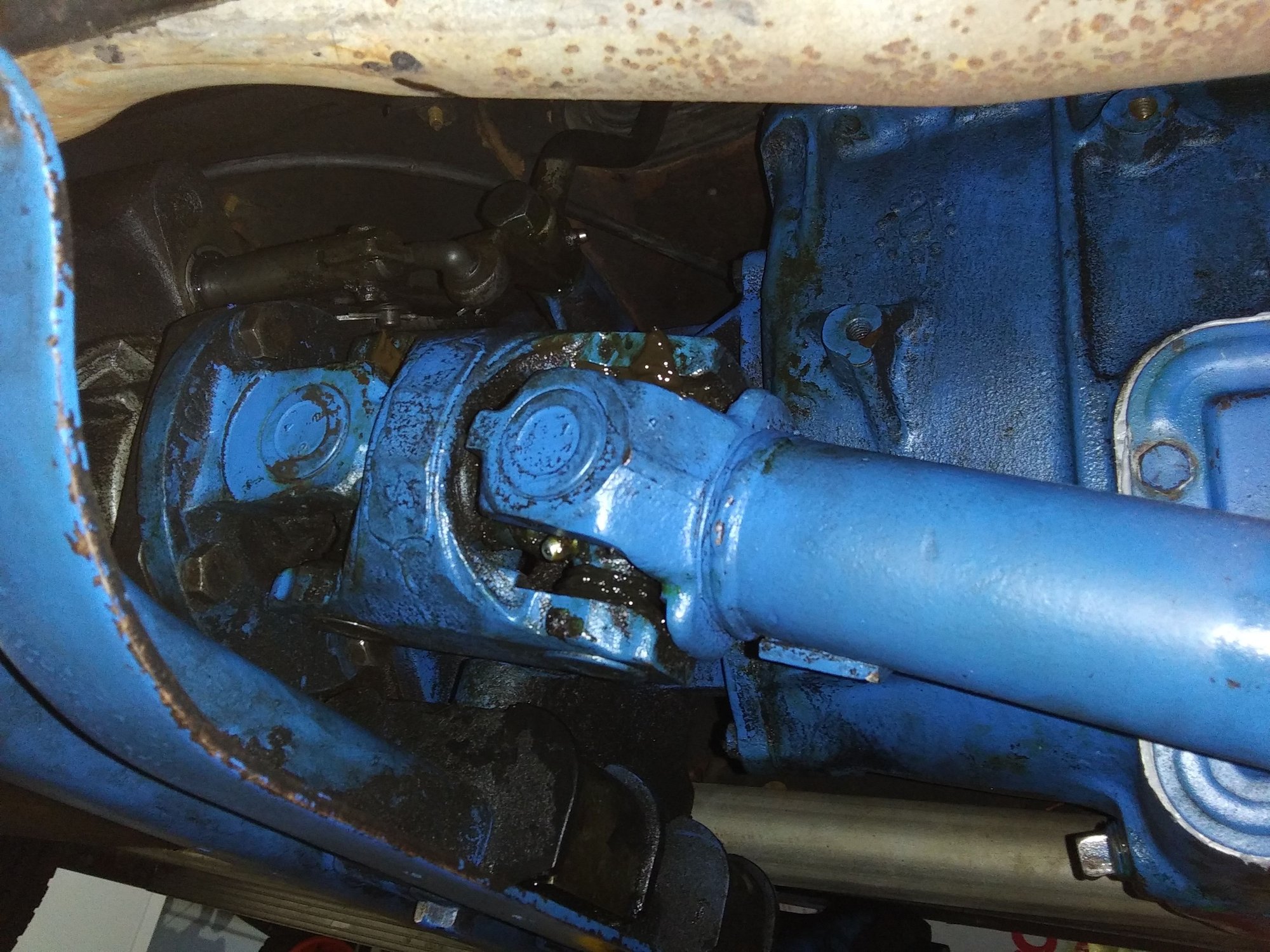

Dang, a new thing to look for to grease and I pride myself on being thorough in my preventative maintenance.
Any pictures that show where and how to grease these?

Yes, I'll post pictures this week, its out driving without me.

78 K5 . Looking back from inside of front right wheel to double cardan joint fastened to transfer case. Two U joints connected with a ball joint in between.
Close up of grease zerk on front U joint and to the left , the grease port for the cardan ball, a dimpled place with a hole. The ball aligns the two U joints and must be replaced when replacing the U joints. A special tool is required to grease these ports.
The blue paint was Sherwin Williams industrial paint from Tacoma Screw Co. Very good quality paint. Grease resistant. The parts were stripped with hydrochloric acid, washed and painted.
